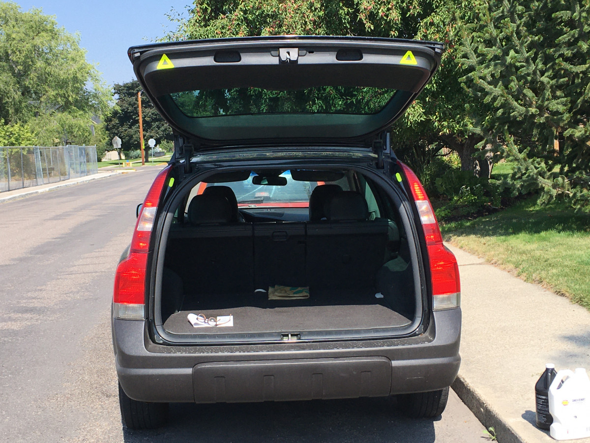

But my very clean P2 job today was to add some of my bike reflector stickers to the open tailgate. When you're loading at night on a dark road, or pulled over, they really light up. An all black car with small taillight reflectors doesn't show up well. I put a couple on the front door jams as well - when did they stop putting the red marker lights on the backs of the doors? My 850 has them.
