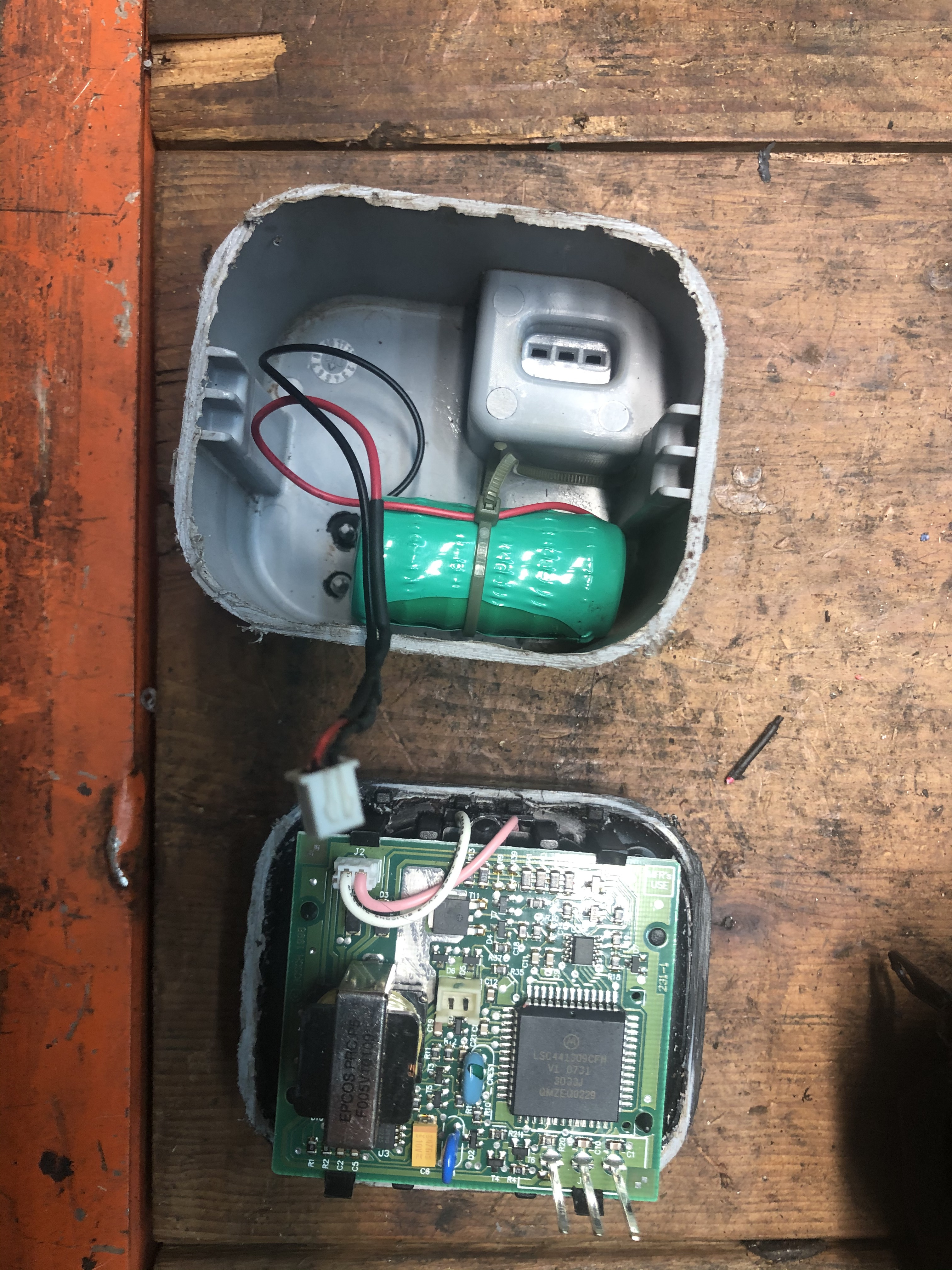

I just ordered this battery off AliExpress I expect it should be a drop in replacement.

I just got done with this repair by following this how-to on my 2004 XC90. I had the warning notification on the dash and an inoperable sunroof. I put a new battery in a siren out of a 2005 XC90 in the junkyard. Now there’s not a notification and the sunroof works! I used the battery from battery space.com (now it’s available on Amazon of course). All your info is much appreciated!

Just completed this repair on a 2003 S80, was a perfect description. Made it easy to handle! Thanks!

Question: Once you cut the 2 halves open, how do you put it back together?
Silicone caulking???

bleubistro wrote: 07 Jul 2019, 18:27 Simply unplugging the siren module worked for me (error message gone, moonroof working again). 2006 XC70. The only thing I would add is that drilling out the rivets wasn't so simple in my case because they just kept spinning in place. I had to use pliers and brute force to pull them out. Otherwise, I was able to fold back enough of the wheel well plastic and easily unplugged the siren using a flathead screwdriver. Error message re alarm service required and non-functional moonroof issues immediately solved. Hopefully the issue does not recur.
I am thinking:
- Remove RF wheel, support by jackstand.
- Remove the 10-mm plastic nuts, don't remove the rivets.
- Peel the plastic liner back enough to disconnect the alarm module.
Does that sound correct?

cn90 wrote: 28 Apr 2022, 20:31 Question: Once you cut the 2 halves open, how do you put it back together?
You'll have to use a rubber band to hold it till it dries. I am using a little light sprinkle of baking powder on the seam then super glue.

Can someone give an update on battery brand (Varta vs Chinese Battery on ebay)?
What brand/type that allows a direct dropin w/o too much soldering etc.)?
