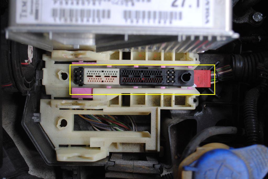

Mike,
The notion of short wires seemed plausible because the car was running prior to cleaning. Limp mode would occur once in a blue moon. So, I said maybe there were already some damages done to the wires and I worsened the situation with my bending and pulling the cable.
I checked the wires at the end point (TB connector). To test them at ECM end I would have to remove EMC, sister box (Transmission control??), pull out the connectors, cut and or attache extension wires put back the ECM etc THEN test it.
The battery is about 2 years old. Whenever I start testing , I plug it to the automatic charger (as if it were the alternator). After I'm done with "Key on position II" situation it takes no more than 5 minutes to get back to 12.60 V
All fuses (hood, cabin, trunk) are checked and are OK.
Anyways, tomorrow I will post the result
And while we are here, any idea how to pull out these sockets / connectors?
Any damage might cost more than the price of the car
Mike,
- ECM box inside.jpg (121.31 KiB) Viewed 737 times
