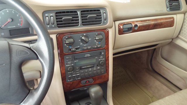

Post by bmdubya1198 »
After about 3 hours of work yesterday, I managed to get my wood grain center stack in. It's a lot of work, but I'm happy with it! I didn't like the gray trim at all!
I also picked up a decent beige leather steering wheel from the junk yard yesterday. I have some leather dye on the way so I can re-dye it, and it should look and feel like new!
Windshield is going to be replaced within the next week or two, and I need to track down the center console wood trim piece now.
