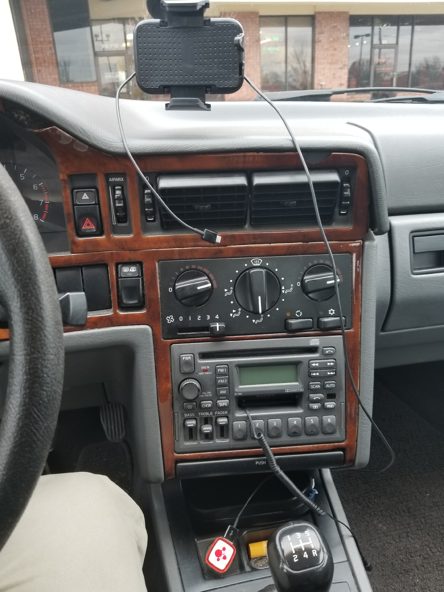

Made a MAJOR upgrade to my car last week. Improved the stereo system to a touchscreen with GPS, Pandora music streaming, and Bluetooth phone calls. Ie I got a tape adapter for my phone. Hahaha. Pic below. :D
Still need to replace the speakers in the rear deck. Dead as door nails.

I installed some new back speakers last week. I'm going to do a detailed write up on how to repurpose your sedan deck speaker cases for aftermarket speakers and will post it in a separate thread. What I will say is that it is nice to have a bass range in my car again!

New rear deck speakers work great. I went with some sosche 5"x8" speakers from Walmart. Removed the old speakers from the boxes and they mounted directly into the old speaker boxes. Screwed them down with some 1/2" sheet metal screws and now when I listen to music I can actually hear some bass. I was going to do a write up but it was so simple it would be unnecessary.
