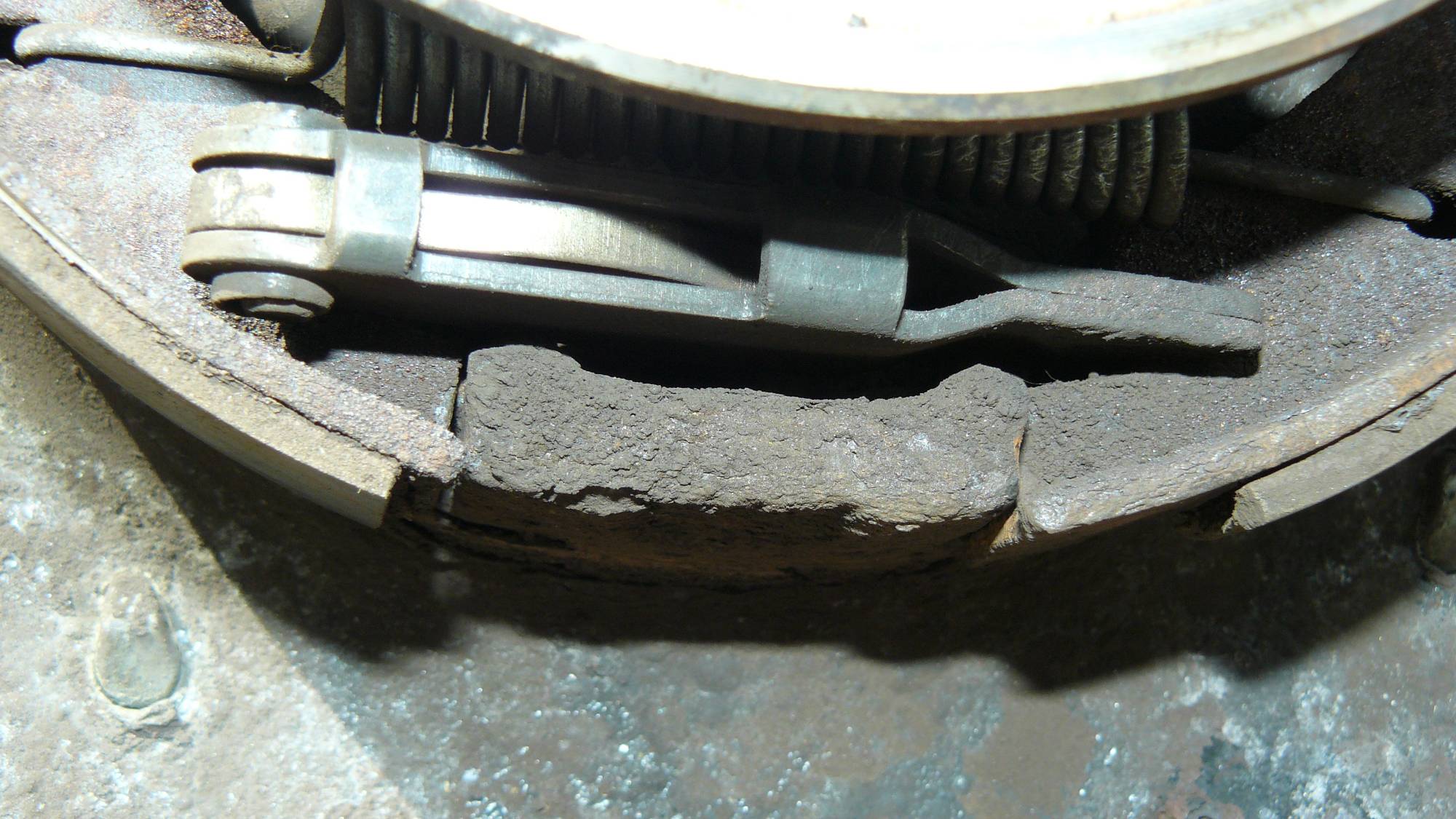

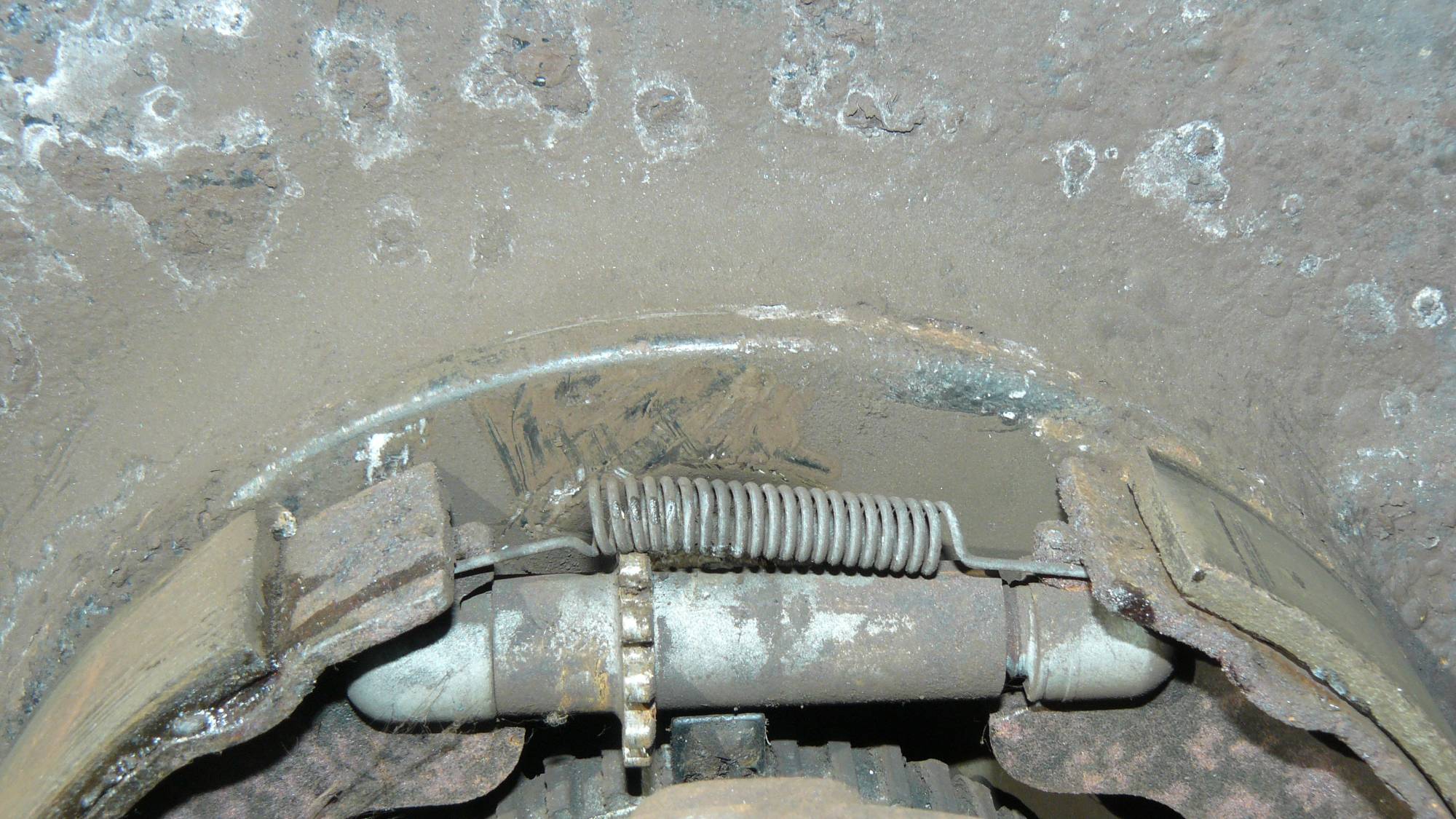

some pics i took today,showing my nice clean engine with zero oil leaks! and the handbrake mechanism i rebuilt now perfect!
you can see the start of this side also delaminating,i remember when brake shoes had rivets the lining rarely detached but on the bad side was when the rivets hit the brake drum,boy they do make a mess of it! but surely in this day and age we should be able to come up with a glue that stays working?there was loads of lining left just no longer attatched! the trick with shoes is filling them leading and trailing edges something not done anymore but should be by manufacturer in my opinion as it helps longevity and bedding in.
just got to wait for rear brake pads and fitting kit and i think i am done with the brakes :D cheers all
