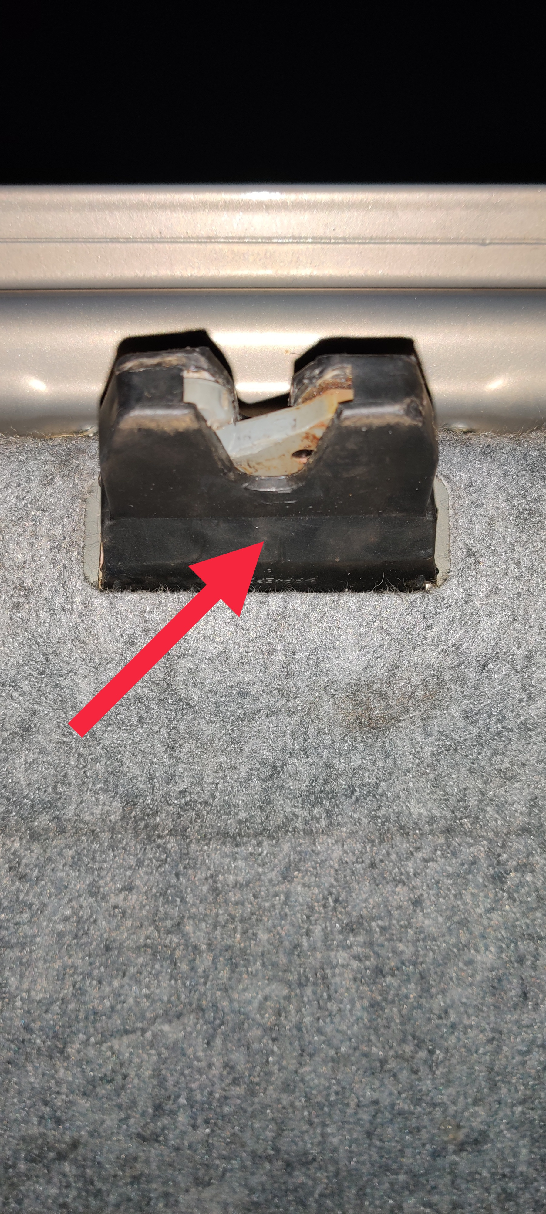

When I bought my S60 the previous owner told me the trunk didn't latch, and didn't the entire time they owned it. When I got it home I whacked it really hard, one time on the flat side, with a pair of pliers, it made an electrical sound right afterwards. It's latched just fine ever since then with no problems (knock on wood).
It may not fix yours, or even be a permanent fix for mine, but it might be worth giving it a nice solid whack to see if it helps.

gnalan wrote: 07 Dec 2020, 20:27whacked it really hard, one time on the flat side, with a pair of pliers, it made an electrical sound right afterwards. It's latched just fine ever since then with no problems .
So...now you have a serious dent in your trunk lid....? Or am I reading that wrong?

BlackBart wrote: 08 Dec 2020, 17:54 So...now you have a serious dent in your trunk lid....? Or am I reading that wrong?
I whacked the electronic latch mechanism itself from the interior side with the trunk open. No dents anywhere. I'll try to post a pic tomorrow of what I mean, to help clear things up. Sometimes I have trouble saying what it is that I actually mean, no matter how many times I try to rewrite it or even while talking to someone on the phone or face to face.

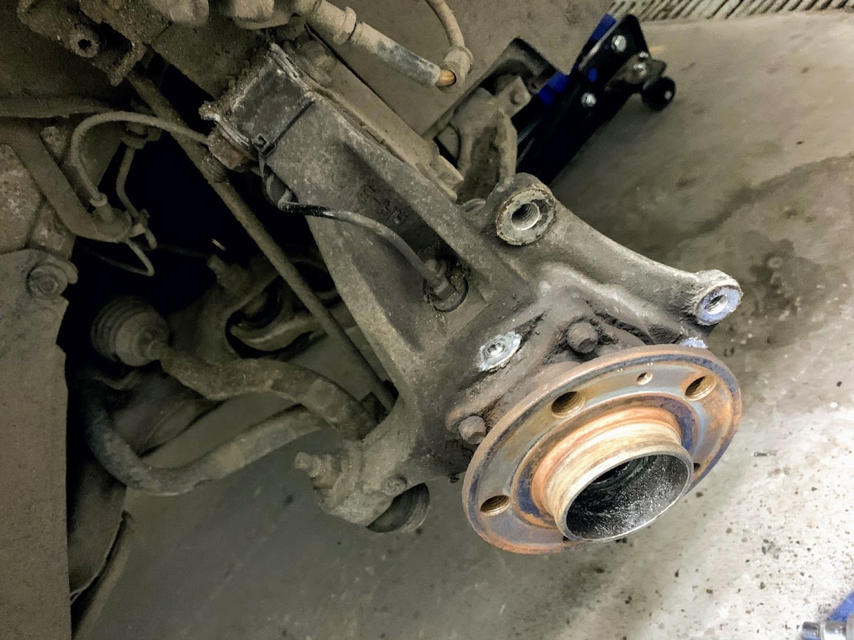

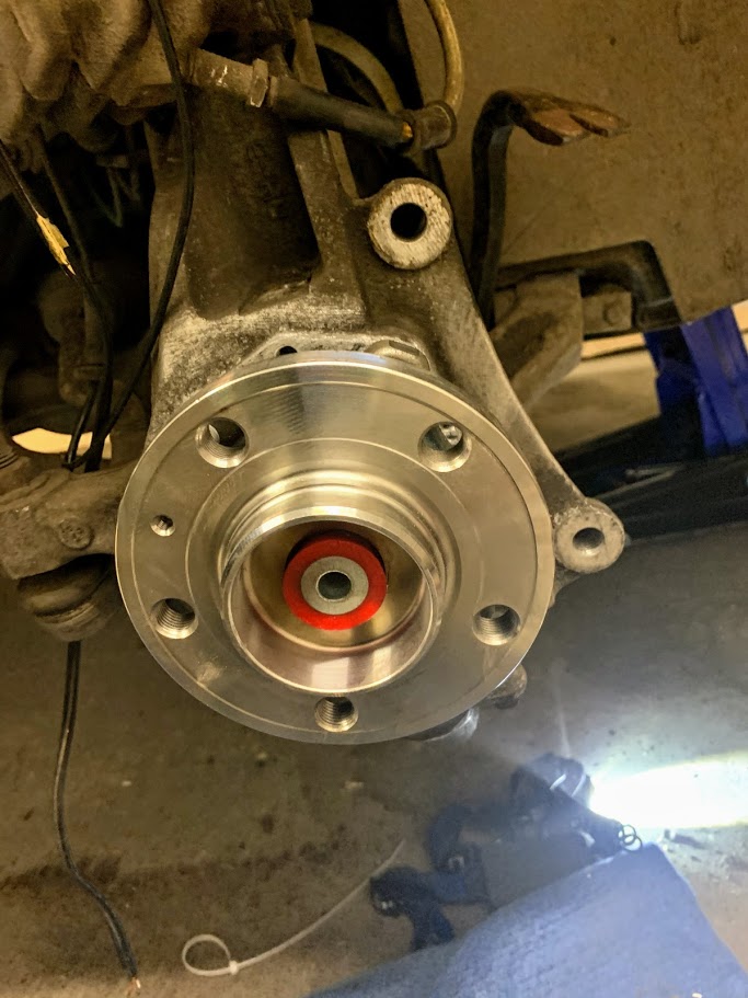

I changed noisy wheel hub (after 1h fight with drive shaft).
wheel hub after.jpg (113.6 KiB) Viewed 1836 times

New shiny parts always look good :)
This is the side of the latch I whacked/smacked, with the trunk open, on the interior side that would be facing the back seat when the trunk is closed. No dents/damage. I may have hit it a few times until I heard an electrical sound (the same sound it makes when unlocking it with the key fob).

Post by volvolugnut »
I adjusted the latch catch plate for the rear hatch on my 2001 V70 T5. It had become hard to latch when it was cold. I think the wear on the latch and the hardening of the aging bumpers caused the problem. If this works, I have photos and will report on the process.
