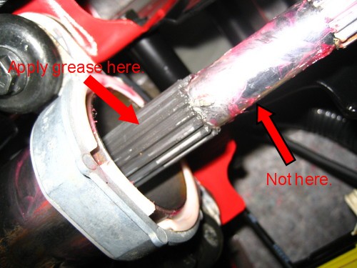

3. Now that the u-joint is undone, the lower steering shaft can move in and out of the upper column freely. Unlock the steering wheel clamp and pull the wheel out all the way. Fold the joint out of the way and you can pull the shaft out further, but don't pull it out too far. If you do, it will come out all of the way, and you will have to put it back in exactly the same to avoid ending up with a cockeyed steering wheel. I made marks on mine beforehand in case this happened. When it's almost all the way out, remove the old dry grease, apply low temperature sticky grease, and shove it back in.
Apply grease to the splines on the upper end of the of the lower steering shaft.  Slide it out as far as you can without removing it from the upper column.  The photo shows red grease in the wrong place on the shaft because on my first attempt I tried to grease it without removing it first.

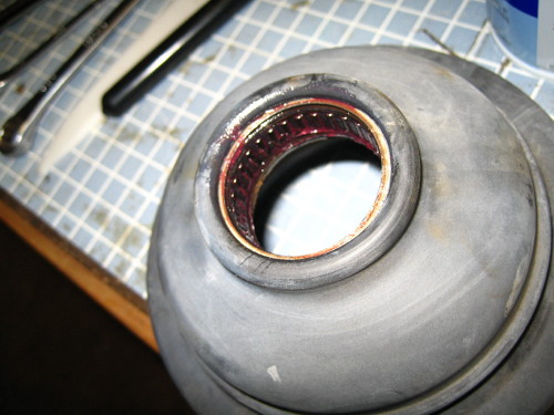

4. Remove the lower steering column bearing by pulling up the outer rubber cover, removing the lock ring and then the lower/inner rubber cover. Extract it from the lower steering shaft to expose the needle bearing in the middle of it. Clean off the old grease--if there is any--and pack it with low temperature sticky grease. Mine was almost completely dry, loose, but not squeaking.
Pack the needle bearing in the steering column bearing with grease.
