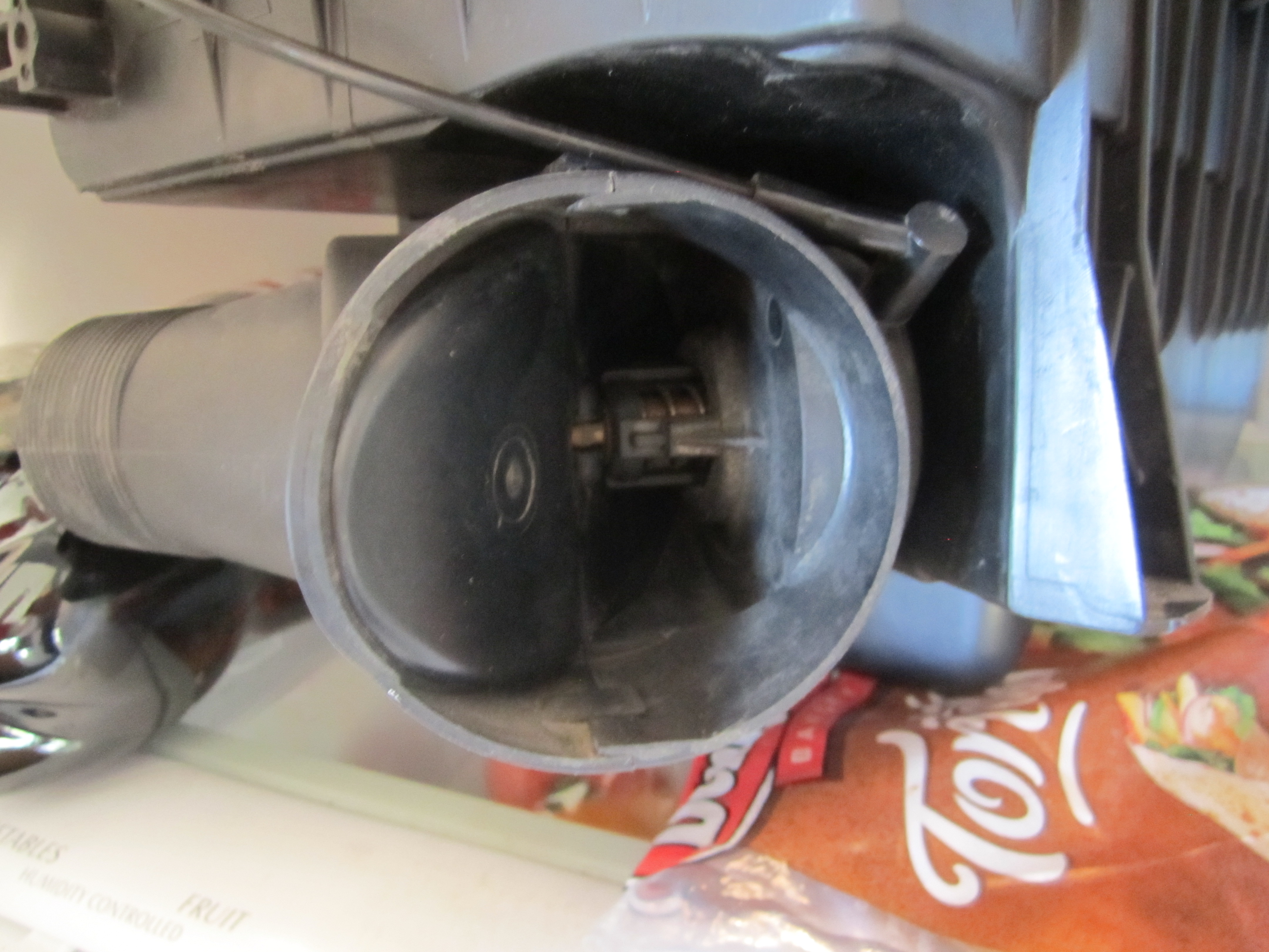

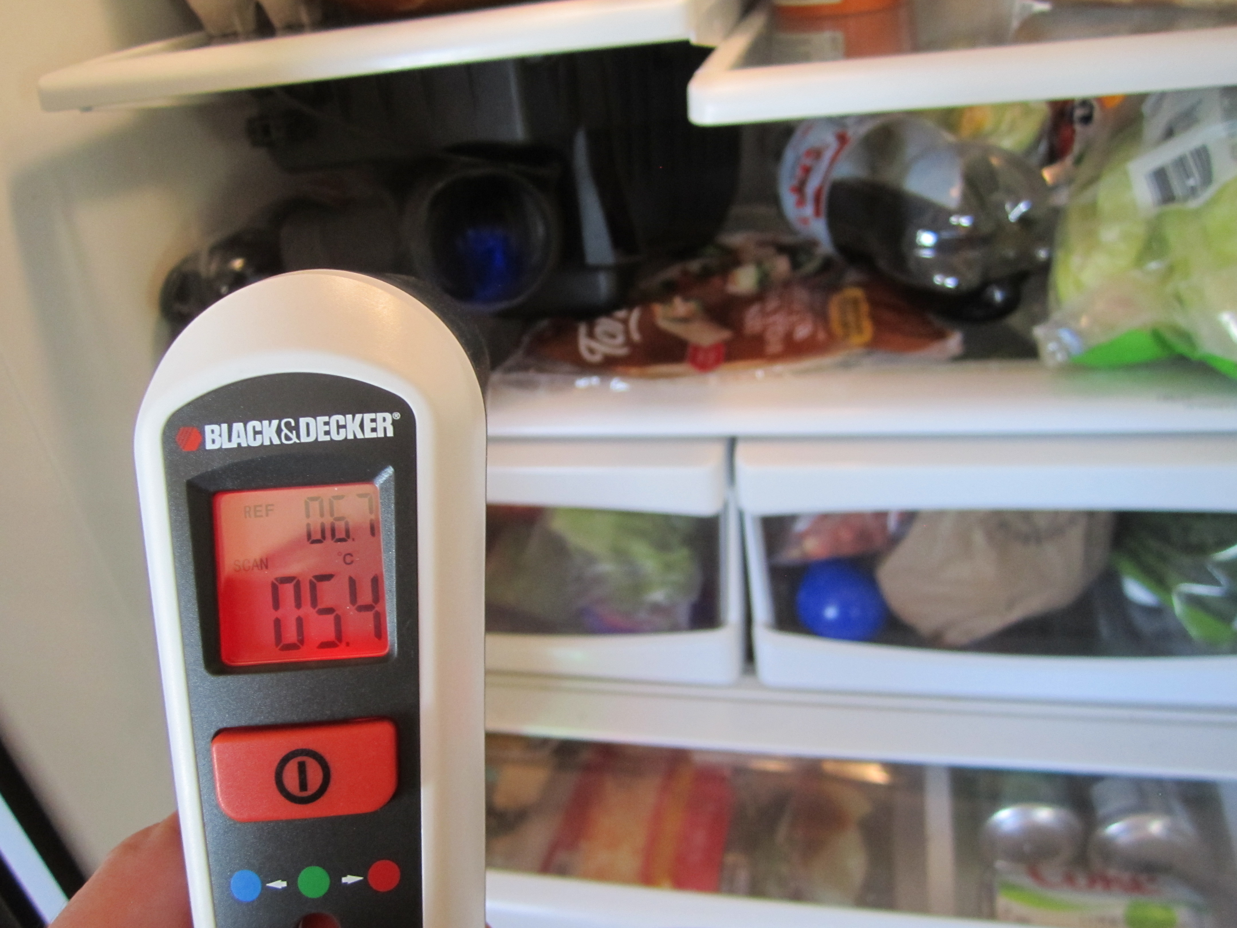

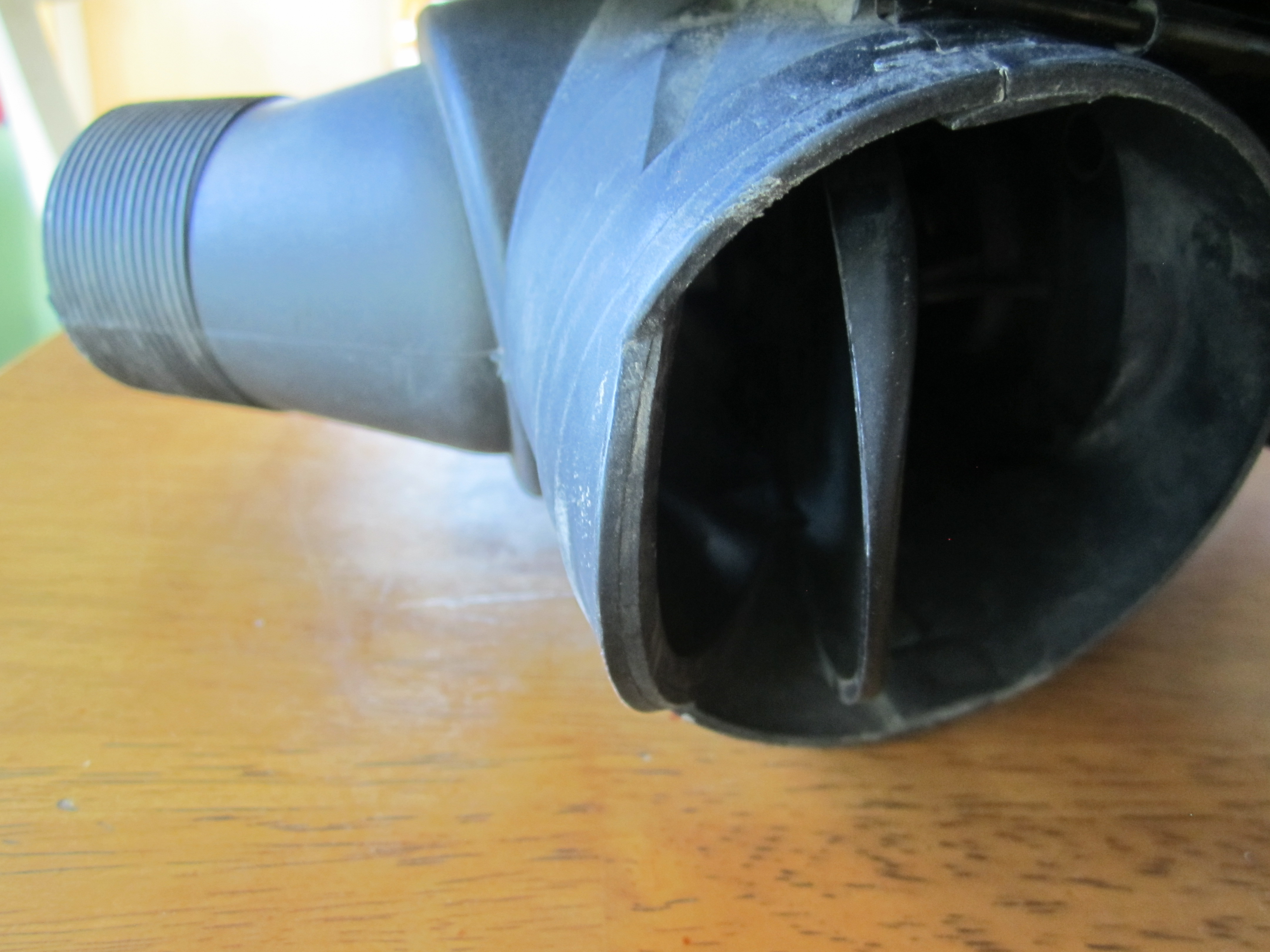

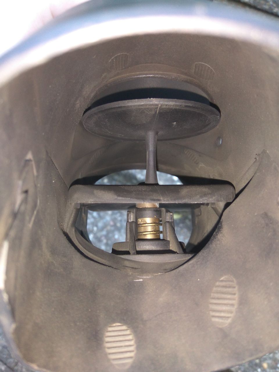

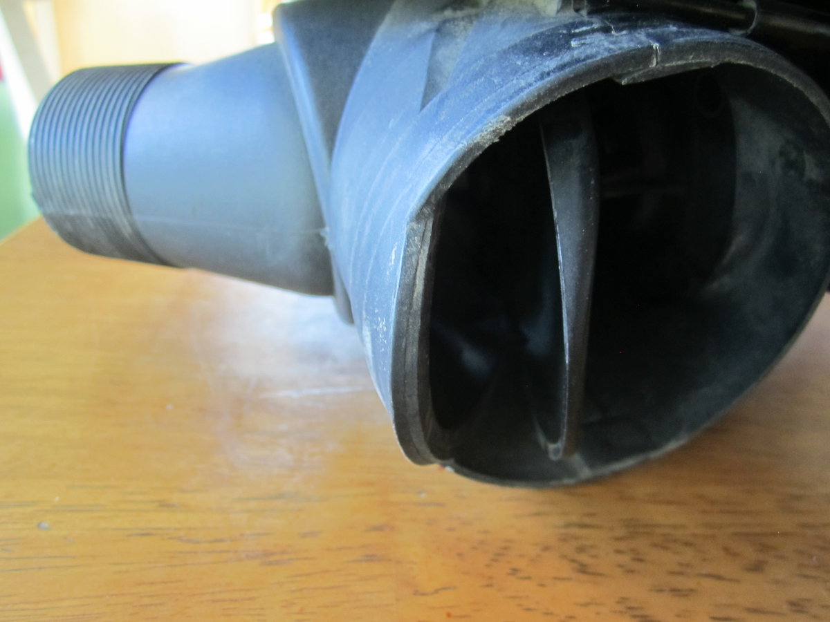

Now outside temp is 5-7C today and just took the 2000 project V70 base (NA) for a run of about 5-6km. I was trying to warm the trans up so that I could try (yet again) to get a proper level of trans fluid once the trans was hot.
To get to the dipstick it is best accessed by removing the intake air tube from the front of the car. First thing I notice is while the engine was registering normal hot on the gauge in the speedo cluster, the air thermostat in the airbox was still almost fully closed. It was open maybe 8-10mm max from the fully closed position.
I know when I had the airbox in the fridge the flap was fully closed at an ambient temp of 5-6C:
Temp reading of thermostat
You can see it is reading 5-6C. Below is the flap position (remeber the vacuum(?) line is not connected).
Position of flap at 5-6C
Thermostat flap position after running hair drier
After running a hair drier on the thermostat at an ambient 21C this is the open position.
So my confusion here is what are the expected flap positions based on the cold air intake temps rather than the engine temp?

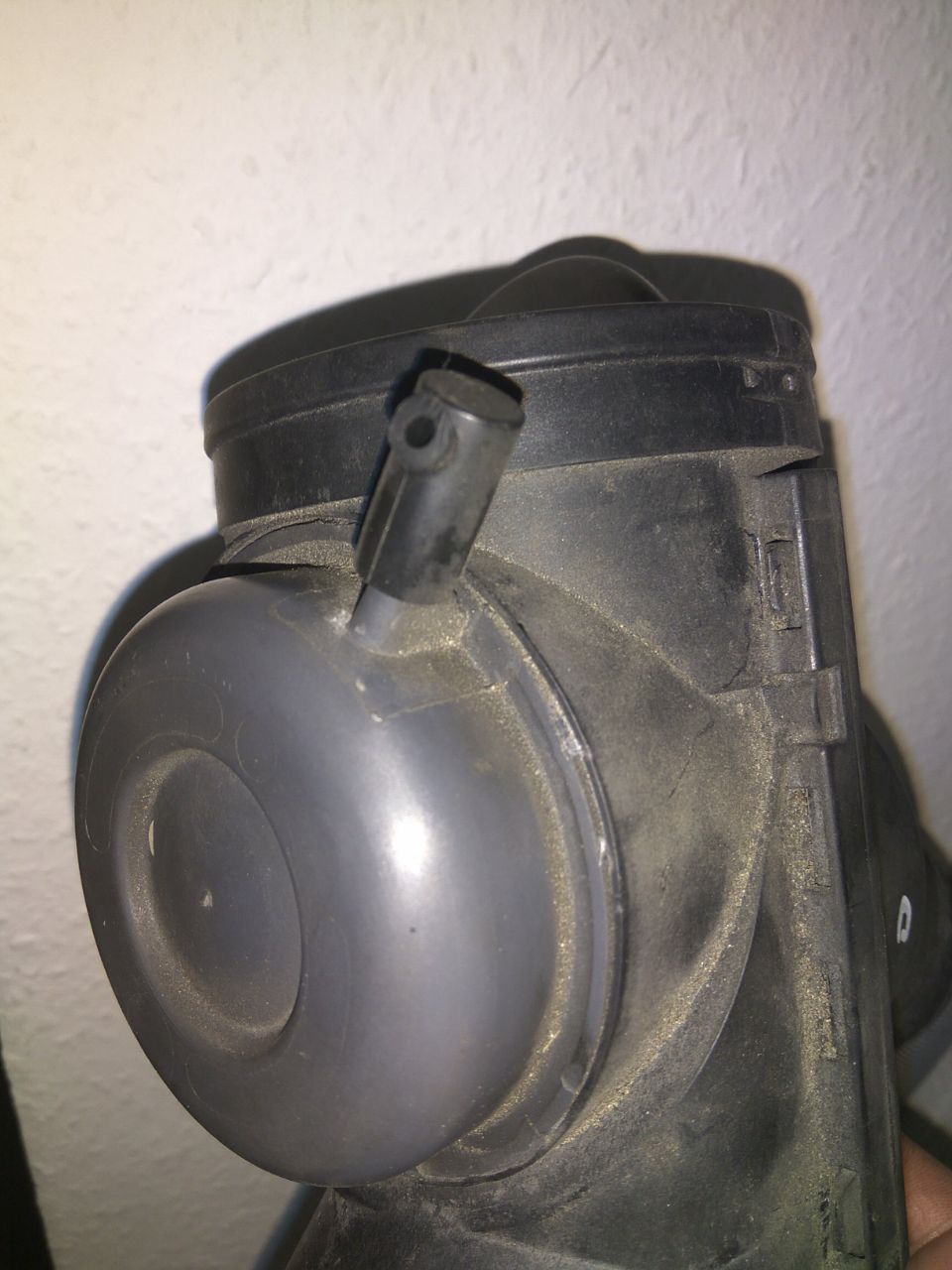

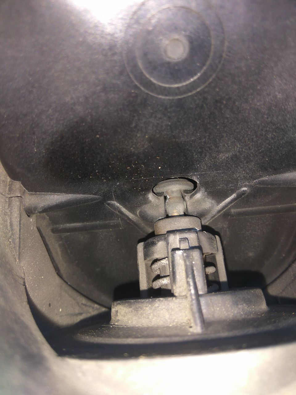

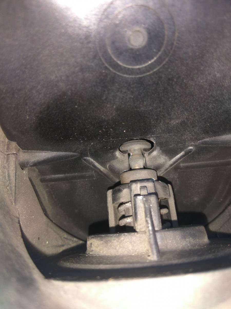

I'm currently also working on the hot air flap, started because the vacuum hose connector broke but when I remove it, it looks like this:
If I understand it correctly the piston in this part should press the hot air closed and the vacuum can pull the hot air flap open.
So this is not fully closed and therefore the thermostat that runs that piston that closes the hot air flap should be replaced, right? (I looked up the part number 9142616, it's available for 17€). However I have no idea how to get it out.
Now I bought a really cheap used airbox, which seems to have the same problem but I can tinker around with this one and if I break it it's not so much of a problem. Also I could fix the hot air closed on this one and repair the other one until it's winter time.
I've also looked on the one of a V70 which has clips on the outside, this one seems to be sealed so I can't access the part which should be replaced from there.

The unit you picture above has what looks like a load of 'barb' plastic clips. If you clean off the dirt Along the straight ledge running down the unit as seen in the picture above on the RHS it may split open.

s3bi wrote: 31 Jul 2020, 20:43 I'm currently also working on the hot air flap, started because the vacuum hose connector broke but when I remove it, it looks like this:
Hey there,
Have you managed to open this? I am facing the same issue here. Bought the thermostat but I don't know how to open this thing :shock:
