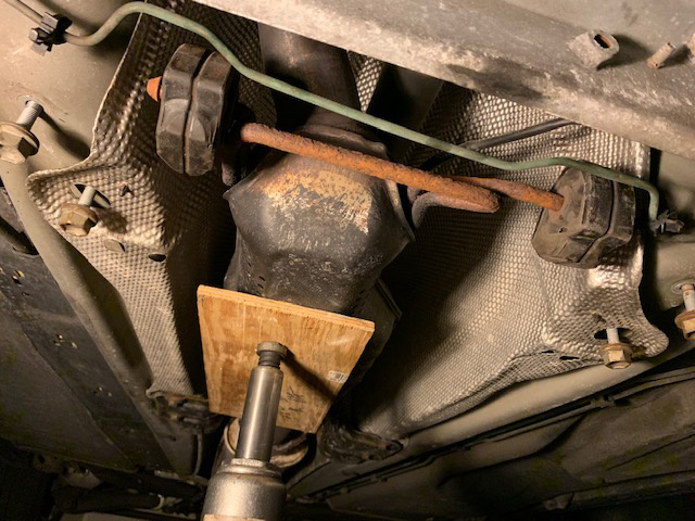

The undercarriage tapping is loudest where the bracket holds the catalytic converter.
I looked closely the way bracket is holding the catalytic converter. It consists of items 8-12 in the diagram below:
If bracket is undone the cat will be suspended from turbo at item 2 and exhaust with item 22. It is likely, without bracket support, I would imagine, this would cause the flex pipe to fail? This bracket assembly:
Unless you say other, using bottle-jack may be best to support the cat while the bracket is removed to look for what causes tapping? Anyone with tapping experience -- is it a warning audio for failing O2 sensor located right above?

Your 01 may be different, but taking that bracket down to inspect won't hurt a thing. There are a few (3, I think) plastic retainers that secure rigid brake/PS lines and one that retains the wire for your rear O2 sensor. Just squeeze those with a needle-nose to allow the metal plate to drop down. Remove the 4 12mm bolts & the plate should just drop down. There are separate "hangers" (#4) helping to hold up your downpipe/catalytic converter above this plate, so no worries about the flex joint.
I can't see the part number on your image, but it doesn't look like the turbo 2.4/2.5T downpipes I'm used to seeing. It looks more like the NA DP like Biggertuna posted about recently, but I could be wrong. Either way, removing the plate won't hurt a thing. Also, don't order a new plate. There's likely nothing wrong with the old one, but something in that vicinity is making the clatter.

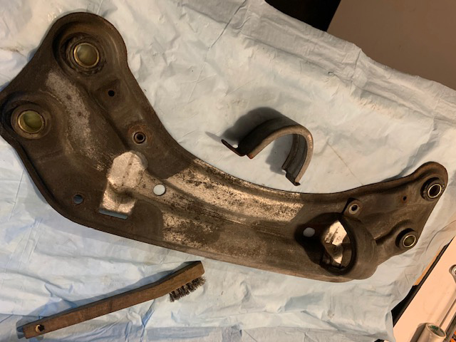

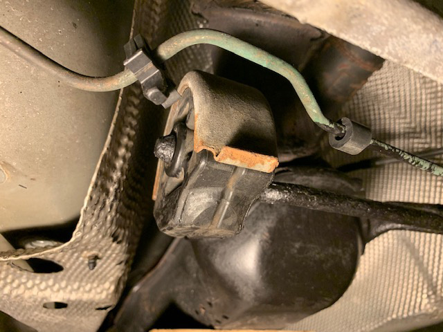

I am suspecting the rigid brake line knocking on bracket. One plastic retainer was out.
Here is progress pix:

IF, it is the hard brake line coming loose from the retainer, THEN, it is likely from the caliper and brake line flaring I did around November 2019. This routed brake line goes to the passenger side caliper.

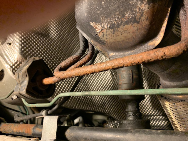

Cleaned off rust on the hanger and gave it a hight temp rust prevention coating. The two retainers are good, no crack or tounge damage. Inserting 2 rubber rollers as spacers around the hard brake line.

The cat support bracket is restored and back on. Car starts like a charm, and took it for a lone drive. The occasional tapping sound is still present. It appears randomly with no particular interval, moment, or tied to a rpm.
Going back to diagnostic desk.
