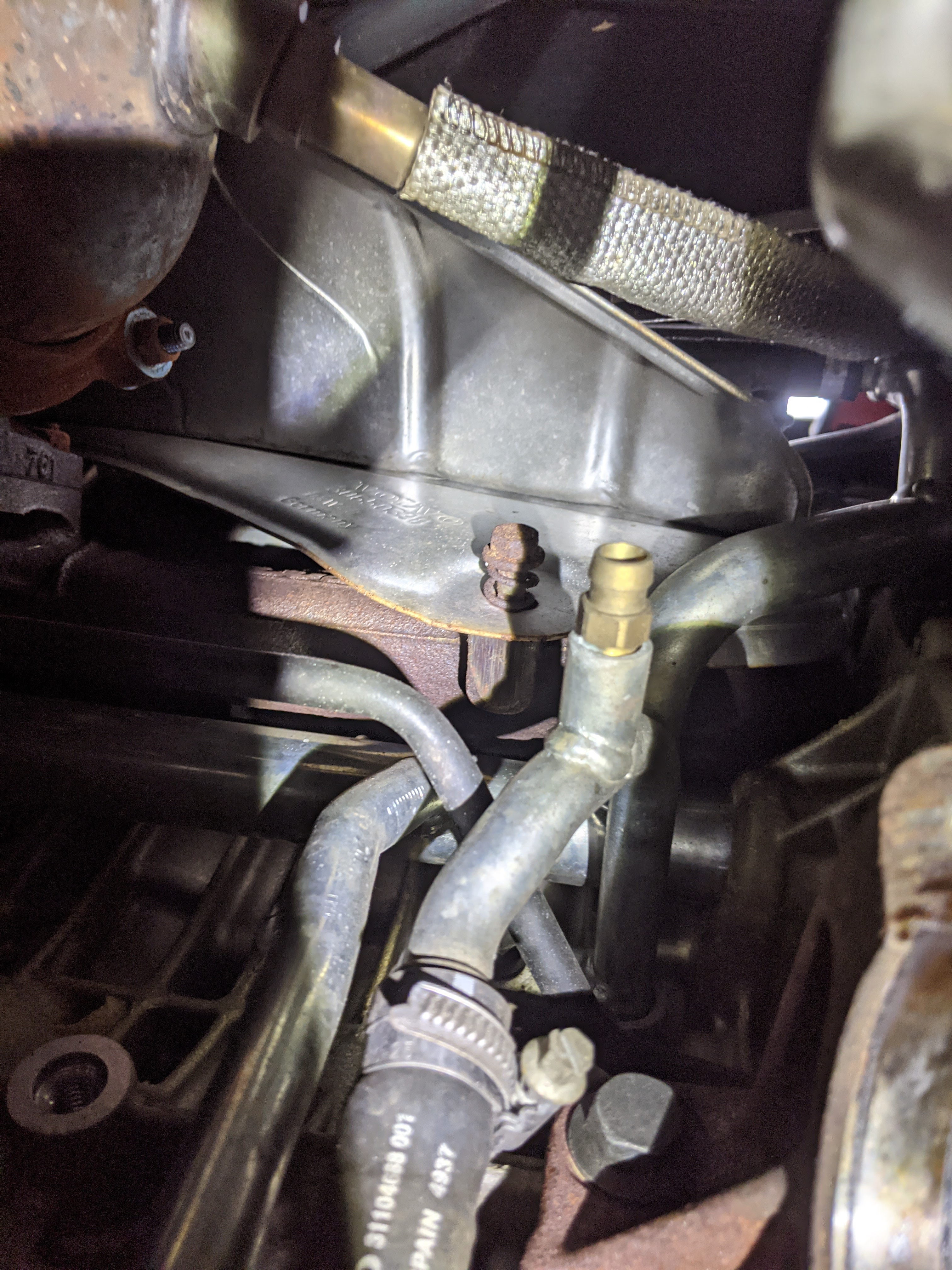

So I called Ben a liar. Surely there's not a manufacturer who makes the block drain so accessible. I've included a picture. I don't believe it. I also didn't have a hose big enough to take advantage of the only nice thing that's happen so far in this PM run.
I decided when I change the water pump that will release enough lower hemisphere coolant to satisfy me. The stuff I drained out was clean so I imagine PO was conned into a flush at some point.

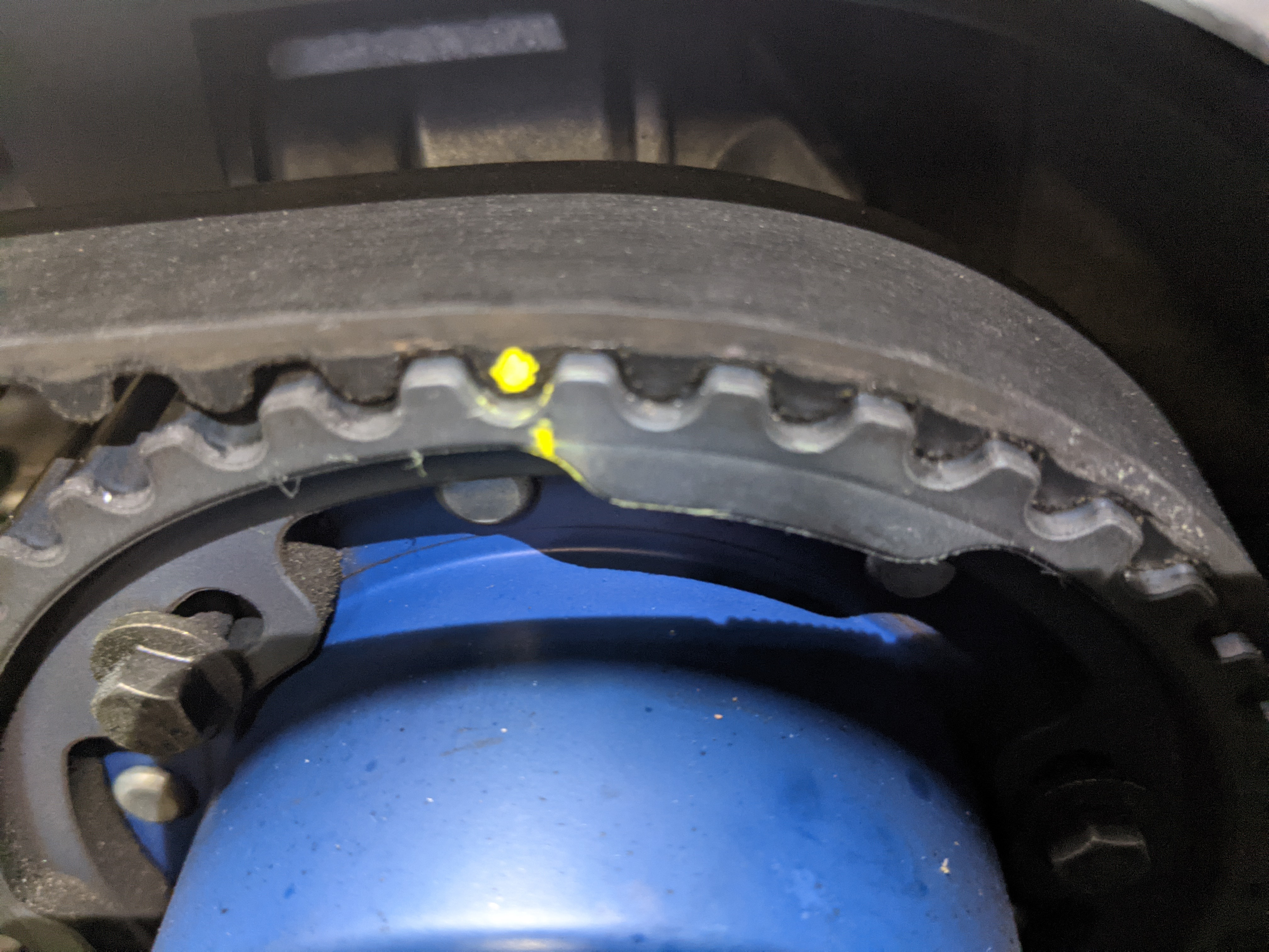

On to the timing belt! Oh man the serp was chunky! I'm glad I'll be replacing that. Basically I'm trying to take off the crank pulley...and my pudly air compressor could only take off one 10mm bolt. The others won't budge and the big 30mm nut just laughed. It's still laughing. I've sprayed it down with penetrant but I'm not convinced it will help. I could try heat but I think I'll go tomorrow and get a new compressor. I've been waffling over doing that for the past two years. Also my gun just spits oil out the front now.
Thoughts? New gun and compressor? I thought I'd poll you lads overnight before amusing salespeople stuffing these into my E46.

Yes, that is the coolant drain nipple & between that and the one on the bottom of the radiator you can get a whole lot out of the system (almost all of it if you squeeze your hoses).

For the crank nut, it’ll probably be cheaper to simply buy or rent a big 110v impact (I believe Xheart had success with the big Bauer from HF). Tons of people have success stories using them. Air tools that are capable are certainly nice, but as you know there’s more than just the tool cost. Piping, compressor & tank, fittings, retractable hose reel, etc. Might be a good compromise for now until you can justify the bigger setup. Plenty of expenses with getting hitched.
For the crank nut, mark it & the face of the pulley before you loosen it. When it’s time to tighten it again, just return it to its marks.

Put 30 seconds of propane heat on that 30 mm crank pulley and it will zip off. I use the Craftsman 120v impact. About 550 foot pounds rating, respectful. Punch mark and return just like Pete says.
