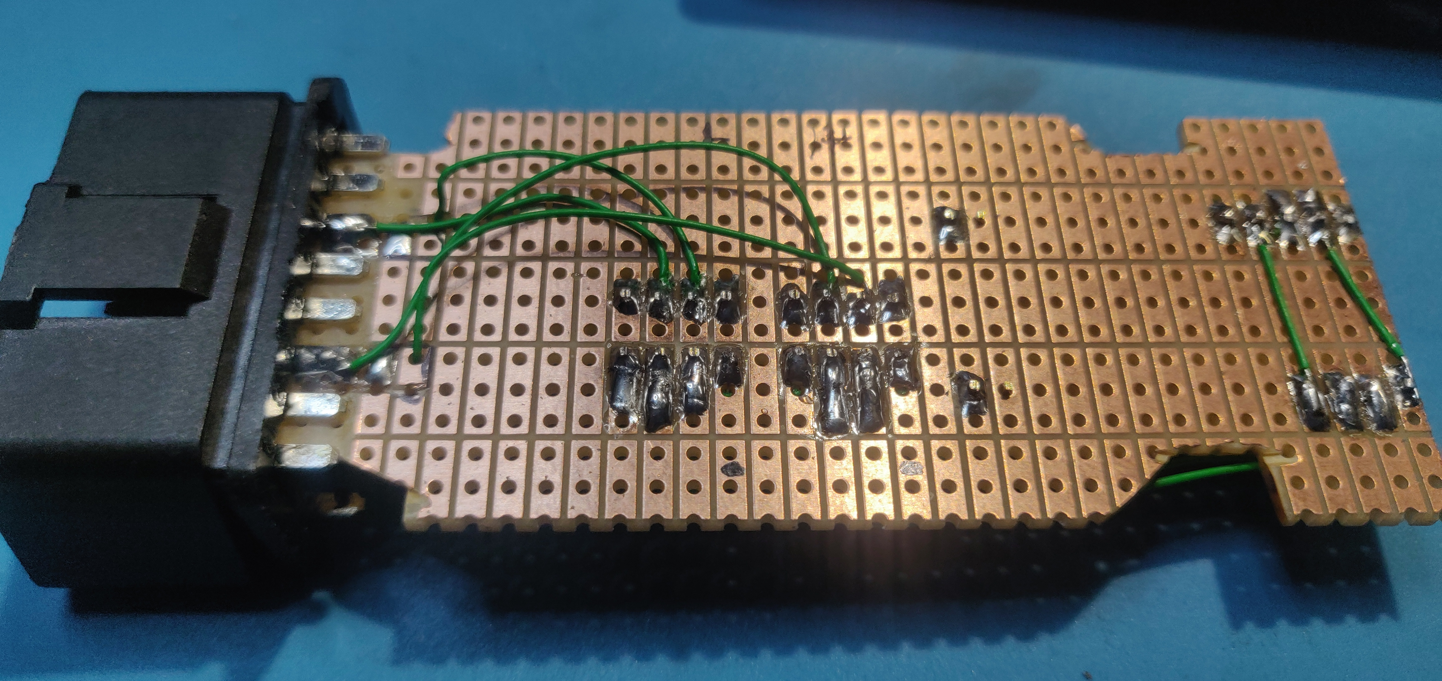

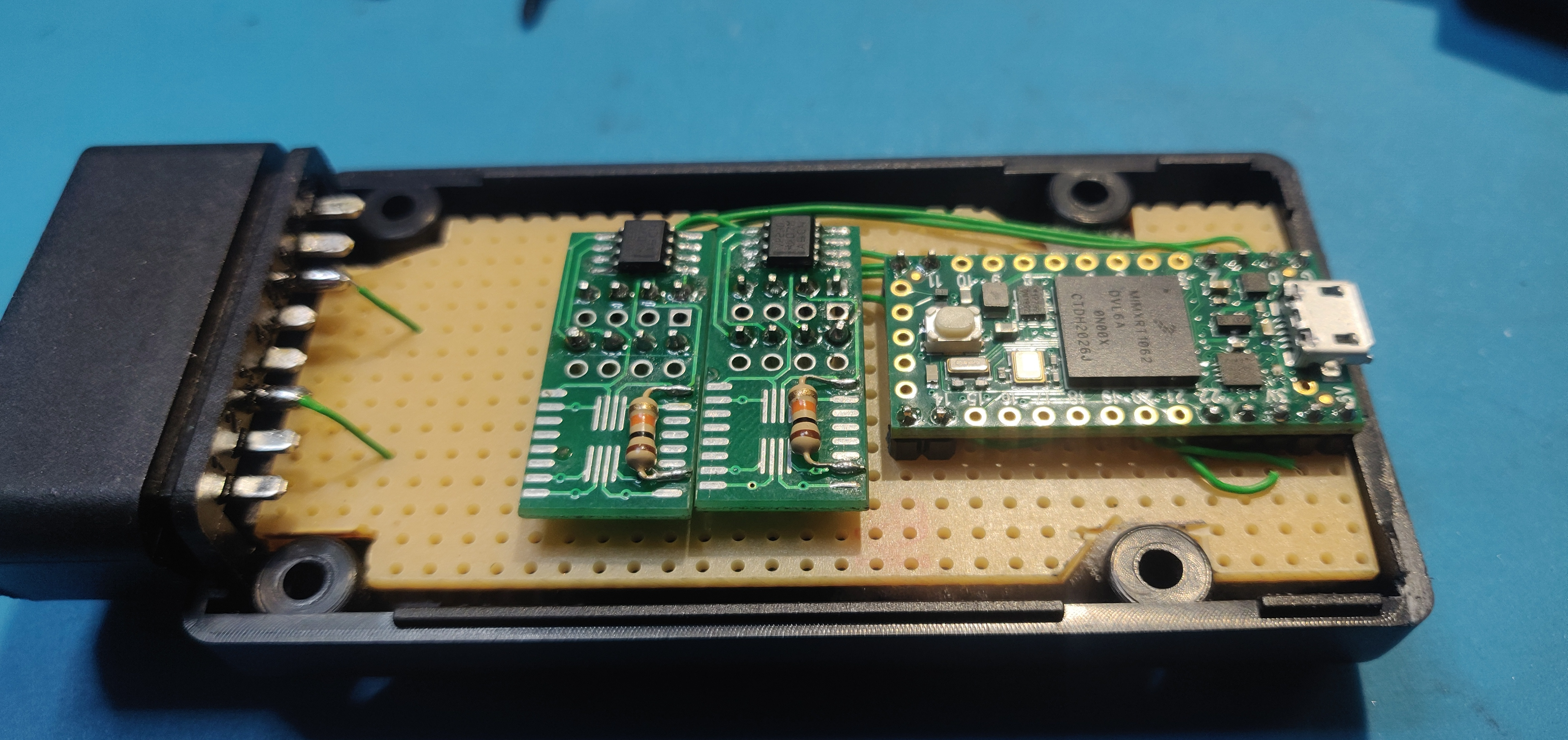

Hi to all again!
Today I tried one more CEM-H from XC90 MY2007, HW_PN 30786890. 2x the same CEM. Unfortunately, no luck :(
What is strange:
- first and second have completely different PIN candidates
- no one has any of real PIN bytes.
My hardware pictures are:
Log files are here:
PIN 30786890 Try1.txt
(122.69 KiB) Downloaded 76 times
PIN 30786890 Try2.txt
(121.25 KiB) Downloaded 68 times
Sketch is the latest one from vtl repo with
Code: Select all
#define CALC_BYTES     3     /* how many PIN bytes to calculate (1 to 4), the rest is brute-forced */
#define CEM_PN_AUTODETECT    /* comment out for P2 CEM-L on the bench w/o DIM */
//#define  DUMP_BUCKETS                               /* dump all buckets for debugging */
The car has left my shop, so I have no chance to try with this car one more test. CEM files I do have, if any.
Any ideas?
Have a nice day,
ZRimaZ

The response time is very wrong
Code: Select all
1000 pins in 572 ms, 1748 pins/s, average response: 21 us, histogram 10 to 31 us
Do you have a logic analyzer or digital oscilloscope that can capture one request-response sequence?

Where do you connect CAN_L_PIN to? RX of the transceiver or directly to CAN-L?
