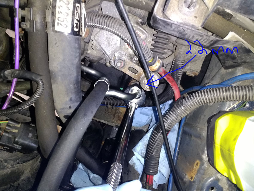

Helped my brother swap out some original 20-year-old transmission lines that were weeping ATF all over the driveway for the past three months. On a 98 V70 this job was pretty straightforward and easy on an N/A: only tools necessary, 10mm and 12mm sockets, some 1/4 wobble extensions, perhaps a 1/4 flex head ratchet, some needle-nose pliers, a small pick, and... a 22mm crowsfoot socket!
I was able to fanagle a 22mm wrench around this nut, but there wasn't really enough room to hit the nut on an angle that I felt comfortable with. I purchased this socket off of ebay for $12 I think. It's a fancy, shmancy Proto socket. (I've been preparing for my exhaust manifold job for the past two years! :lol:)
I think a 3/8" drive 22mm crowsfoot is a MUST have for P80 owners...

Oooh, a Proto! My cousin's '99 needs that line, we almost had it at the PaP last week, but he decided it was "too hard" to get off. Seriously!?!?!?
