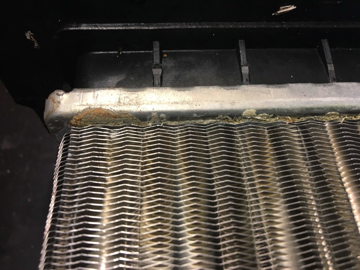

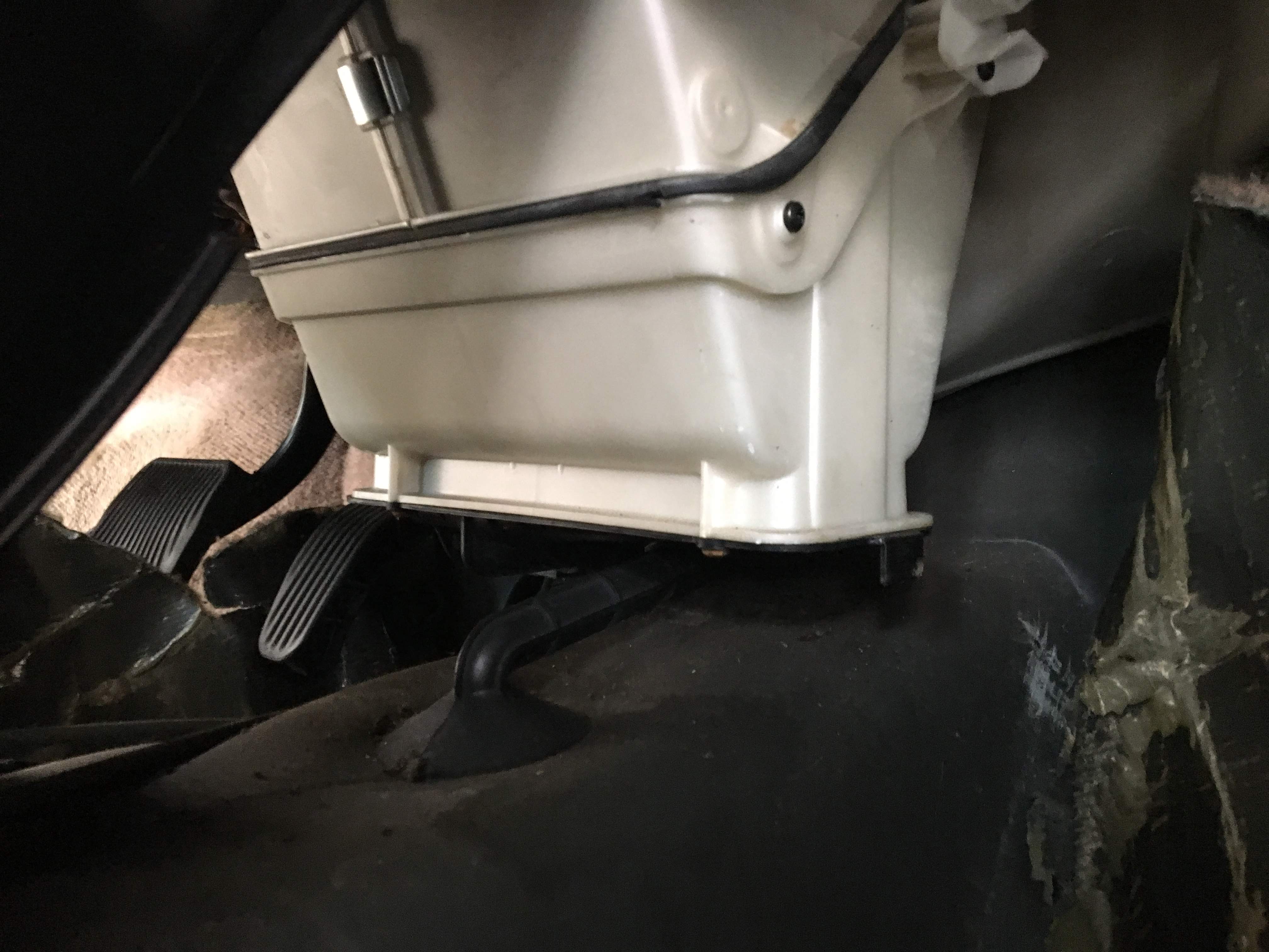

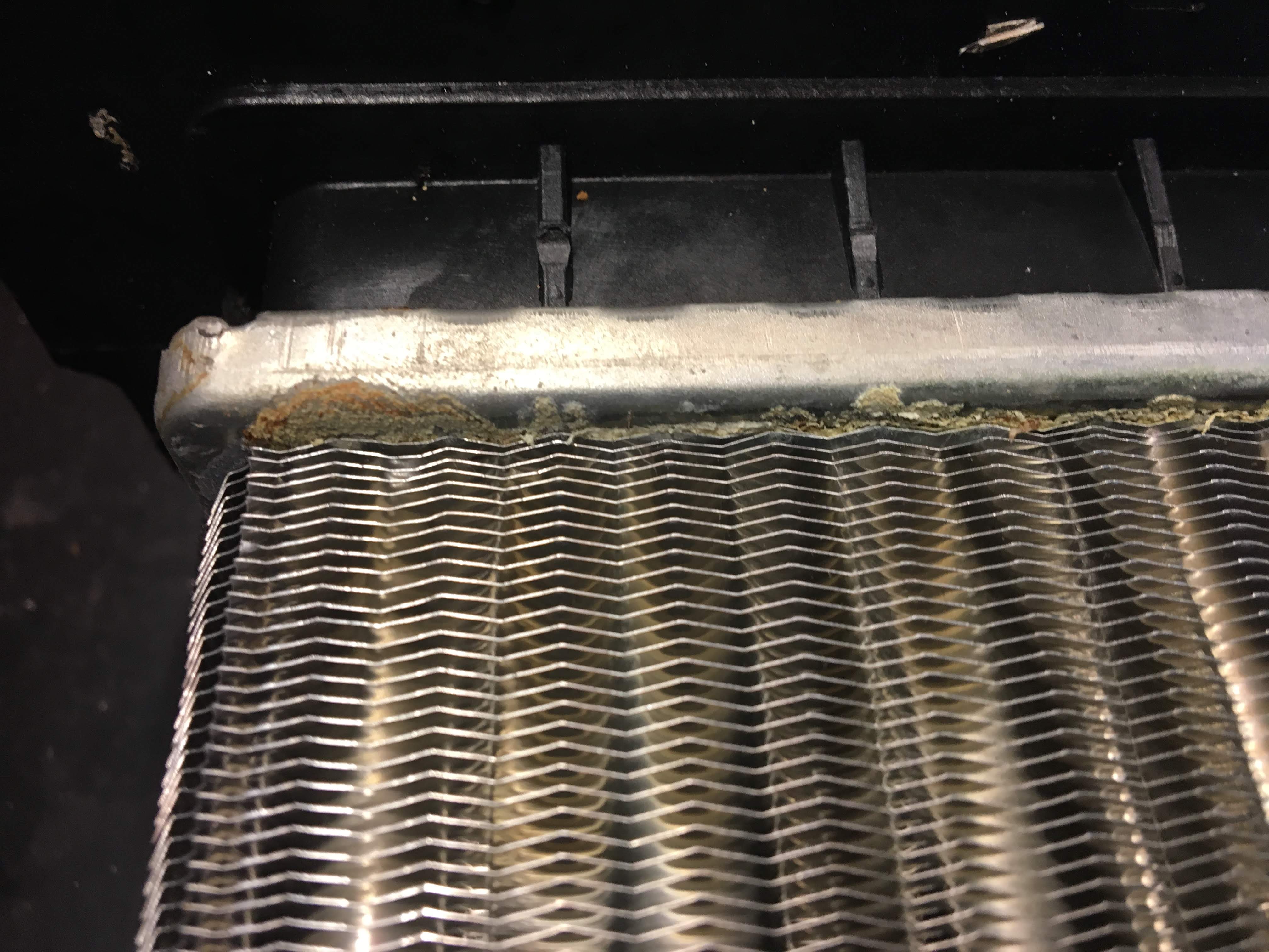

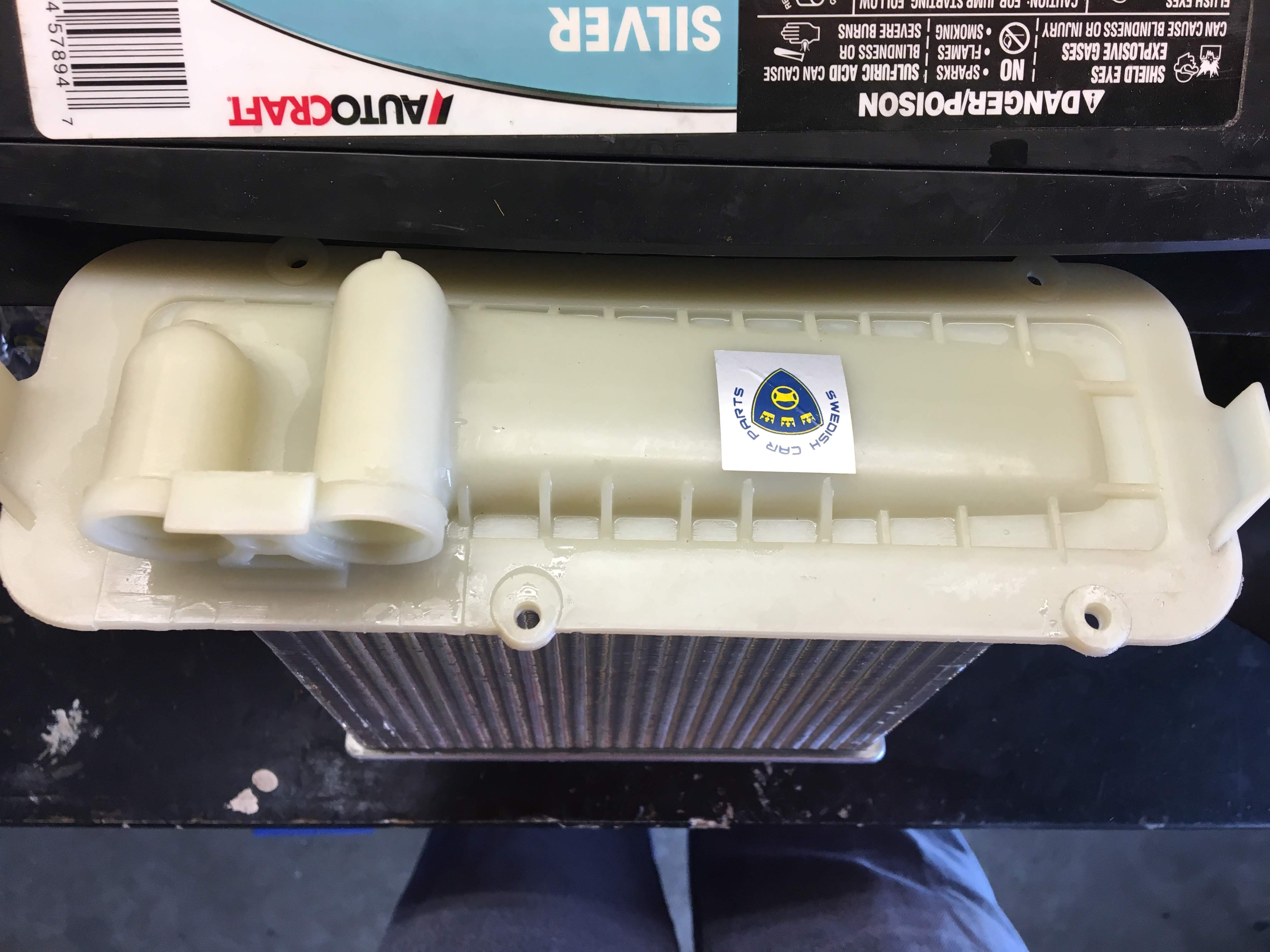

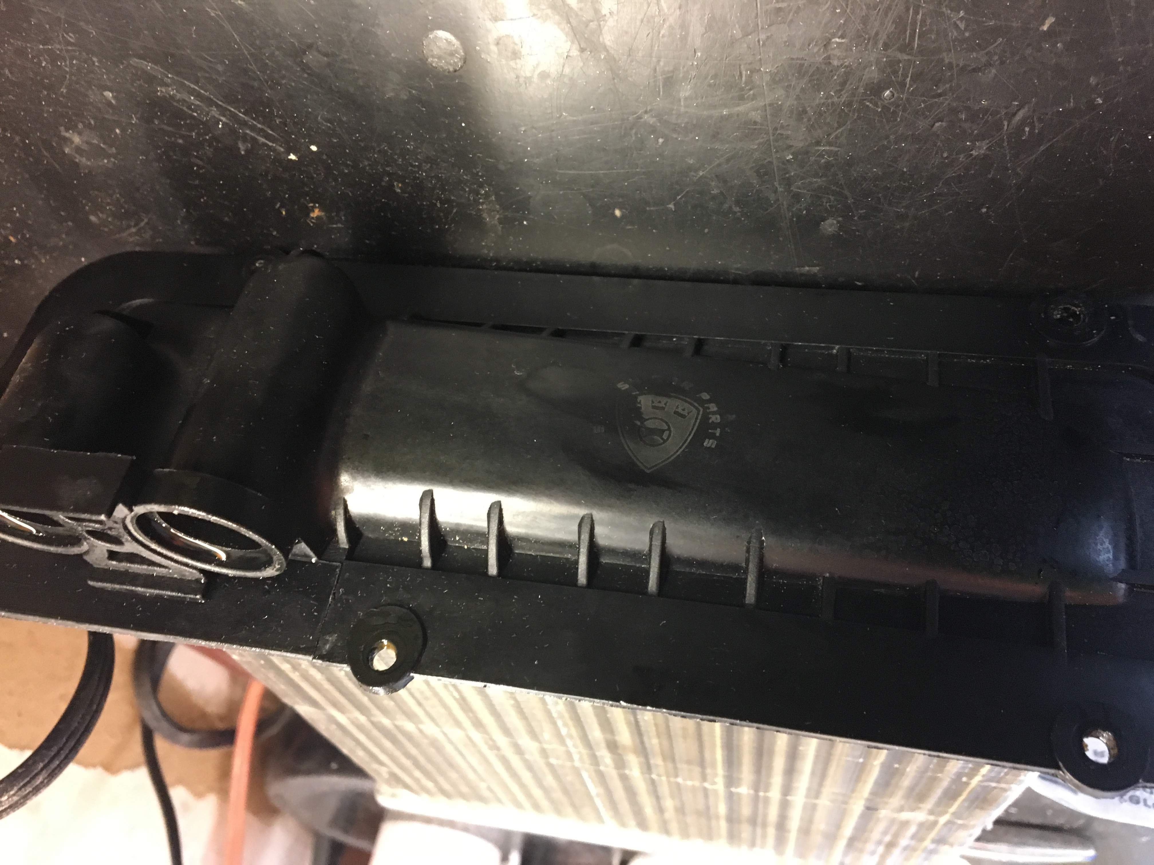

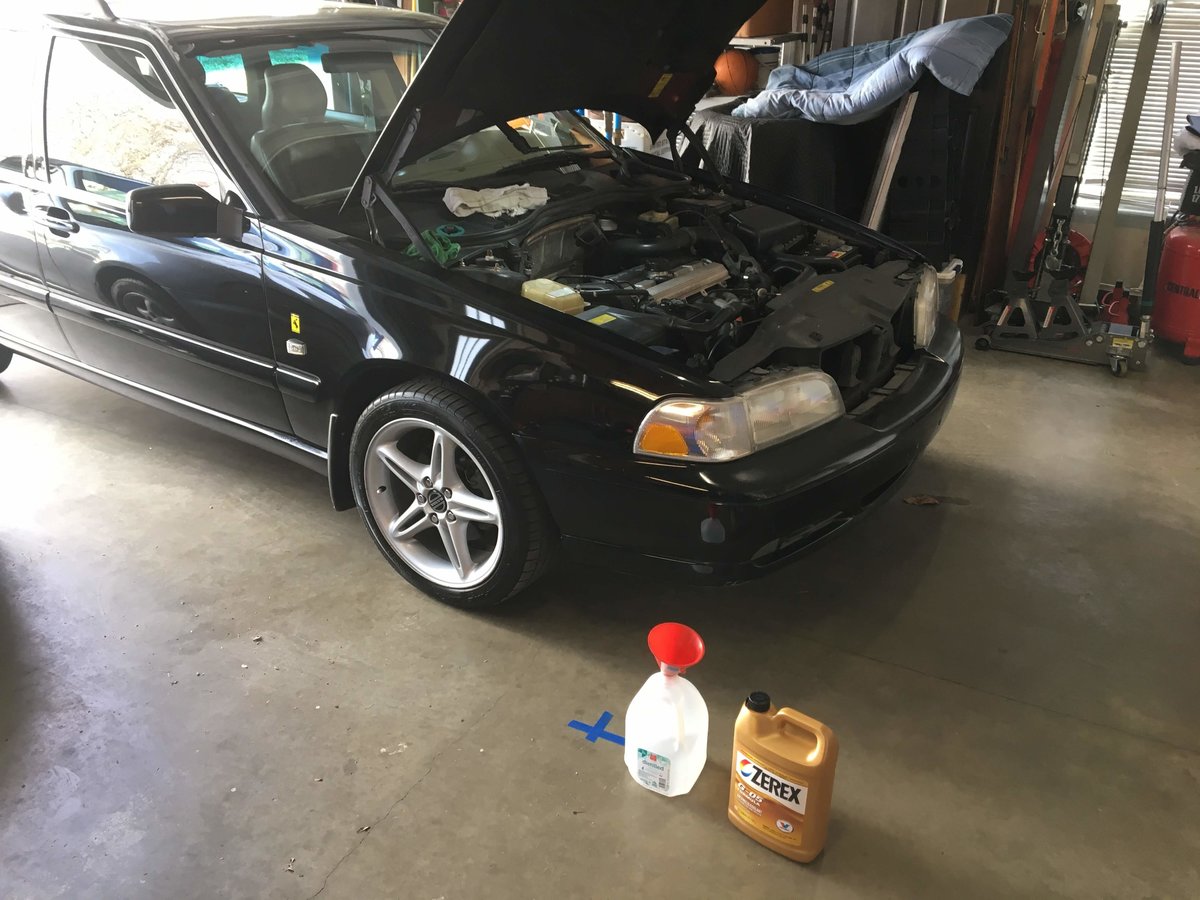

Changed the heater core in the GLT today. No coolant on the floor fortunately, but it appears there was a slow leak coming from the heater core itself. There was some white crust around the bottom.
Probably the source of the coolant smell in the car, though. Unfortunately the trash bag I was using to cover the floor while removing the old heater core must have had a hole in it, I ended up spilling coolant all over my floor mat. Fortunately I decided to keep the mat in the car, otherwise my carpet would have been drenched!
I also installed my do88 expansion tank hoses since I had the coolant drained. Those had been on the shelf for at least a year!
