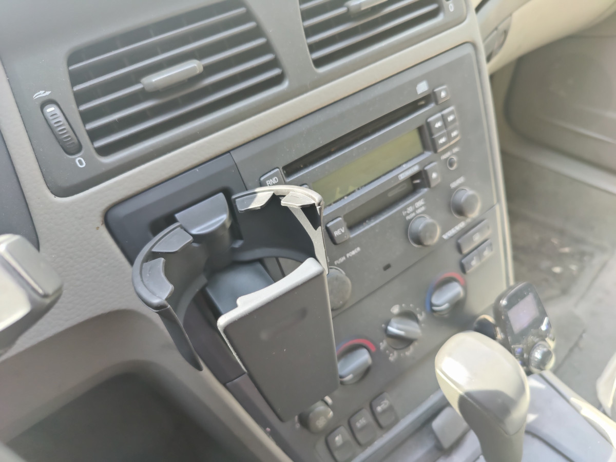

I installed a new cupholder where the cubby hole beside the radio was. Pretty easy to do. Bought it from FCPEuro, and it came in a factory Volvo box with clear instructions included in the box on how to remove the cubby hole and install the cupholder. Took maybe 15 minutes to swap them out.

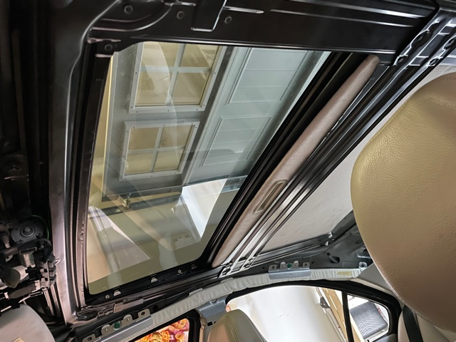

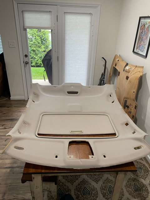

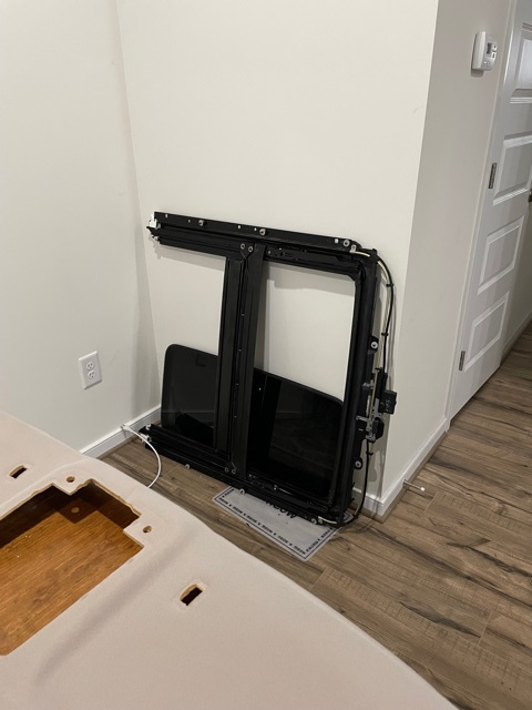

Project Sunroof, installed this week.
Like most all of you my sunroof had leaks, but moreover it was flat out broke. When I bought the car I had to fabricate rear mounts that slid into the slide rail for the rear sunroof glass and sealed it shut for another day. Over the last month I picked up 2 headliners, 1 sunroof assembly (one extra sunroof assembly came with the car) and various pieces and parts. I put together a good sunroof assembly using two to make one. Mind you it was untested, but all the pieces are on one and all there. I cleaned a headliner and used the other headliner fabric to recover the sliding shade. Oh I actually picked 3 headliners as I screwed one up. Lol The job wasn’t that hard, but it kinda was as a one man job logistically. That’s where the cussing factor came in like dropping a bolt at a crucial time, etc. While it was out I cleaned and tested my front and back drains. So, it’s in it works and looks great and it passes the water test. I ran water over it and sprayed it directly at the seals for a while. I’m tired and sore, but happy with it. Pick a part, headliner $10.99 ea. Sunroof $35.00, other pieces and parts ~ $20.00. Sweating and cussing, moderate.

I dont think I have ever had any modern car with a sunroof leak, except when I get 2 feet of snow on it and let it ice dam
Is this a thing?
Is this a thing?
- DonnVa
- Posts: 239
- Joined: 10 Jul 2020, 15:15
- Year and Model: 2005 XC70
- Location: Mechanicsville, VA
- Has thanked: 21 times
- Been thanked: 61 times
Yes, while googling trying to gather information about doing this job there are quite a bit of conversations on the internet about leaky sunroofs on S60’s. There is also a reference to a lawsuit from P2 owners against Volvo regarding leaking sunroofs. This S60 has two references during its warranty period where it visited the dealer. One of its rear sunroof drain hoses looks to have been replaced as it is a different color than the other. But that was really not the point of my post as my sunroof was just broke in so many ways, hence a spare s/r came with the purchase. Lol
