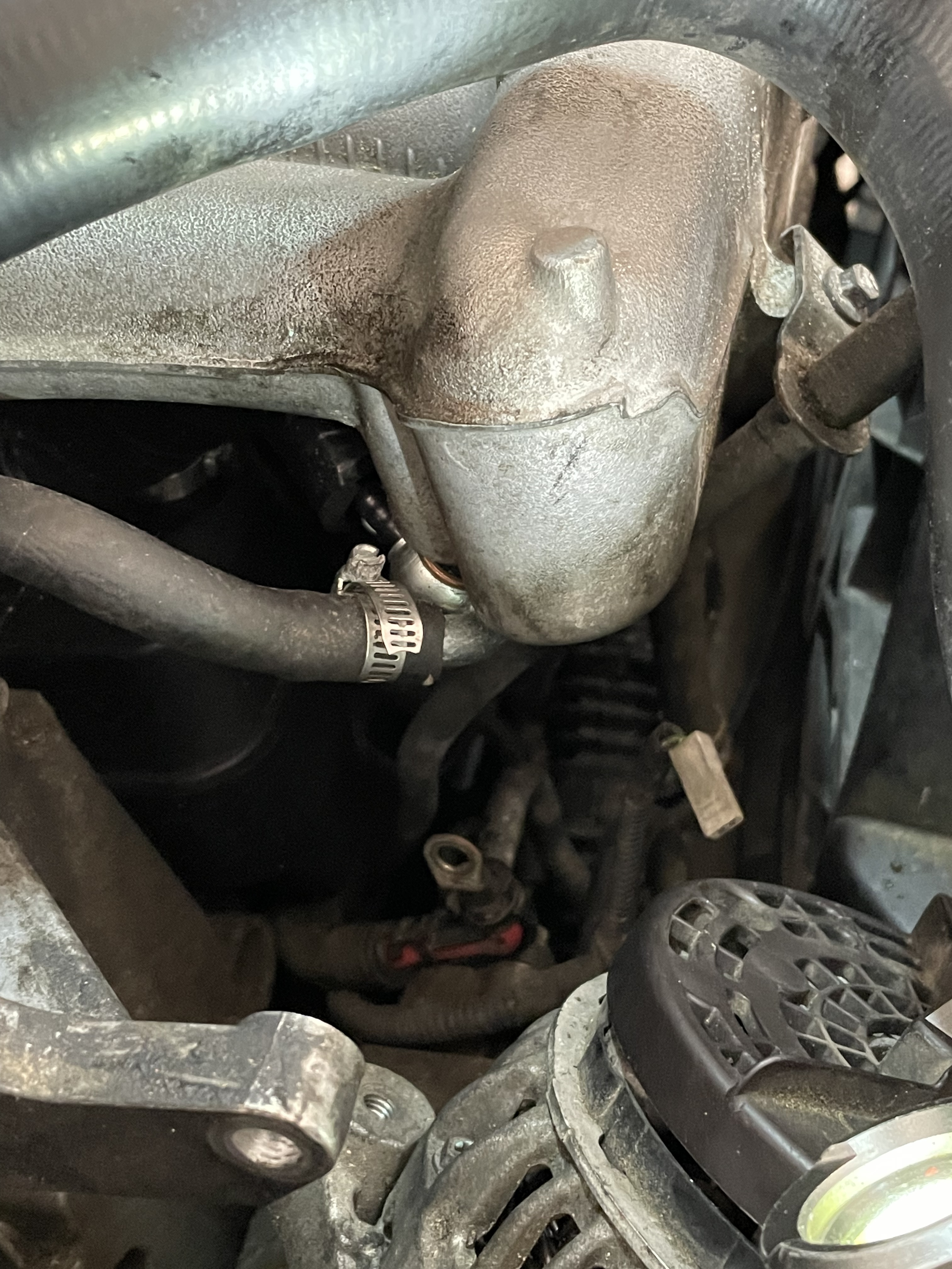

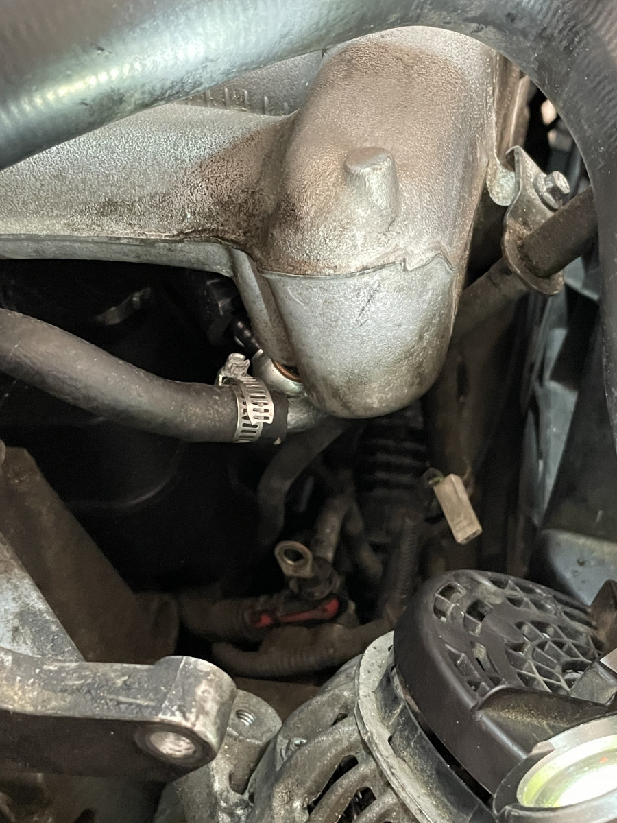

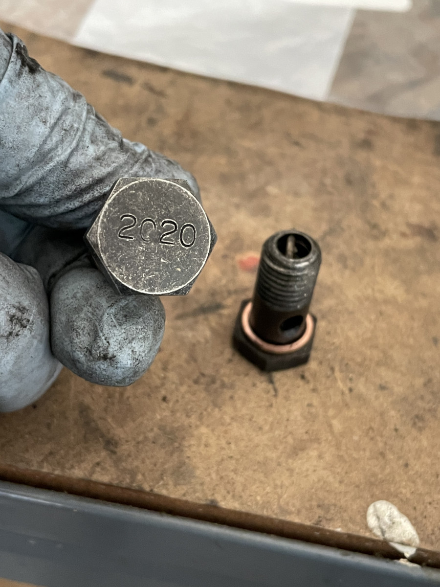

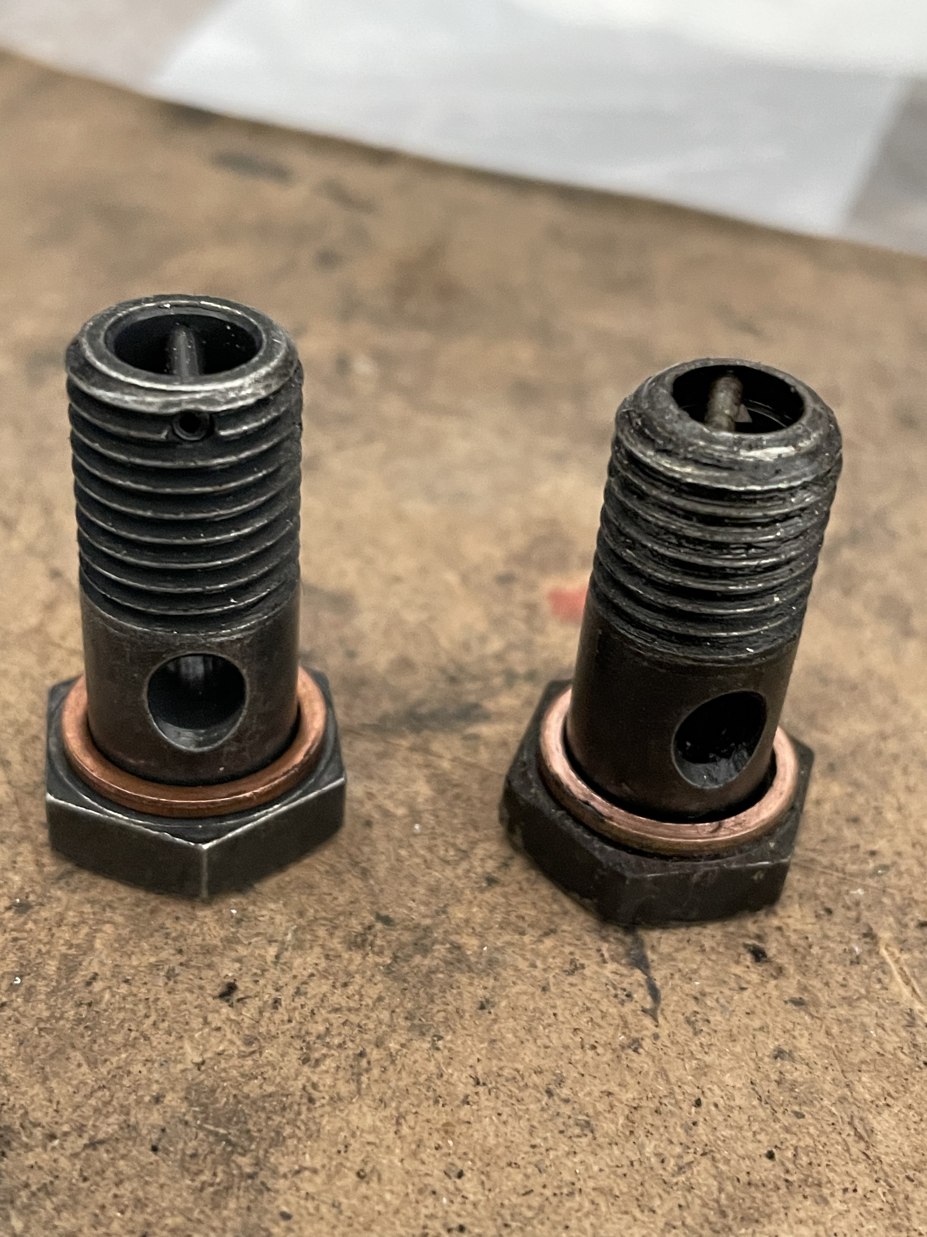

I had to take the alternator out to replace the pulley which didn’t go well. Pulley bolt is stripped, so someone previous to me tried. It needs to be replaced anyway as I found my squeak that showed up when I put a new serpentine belt on a few months ago and the bearing inside of it is making a noise as well. Anyway while it’s out I replaced the banjo bolt with the most current version (pics) and replaced the thermostat temp sensor assembly as I had a new one in a box just waiting. I’ll button everything up when I get my new alternator. The banjo bolt was real easy to get to with the alternator dismounted and moved to the side, so you don’t have to take it completely out if you want to change yours for piece of mind.

I wish I would have read all these damn banjo bolt threads prior to doing my alternator a month ago.. lol

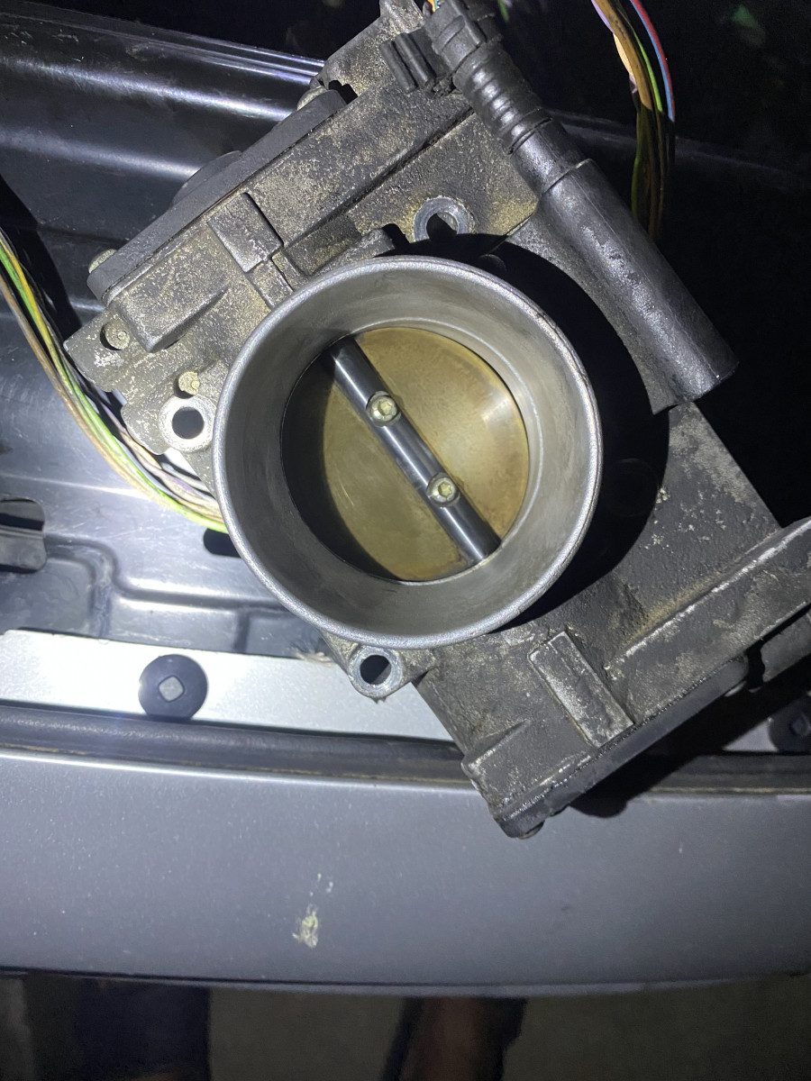

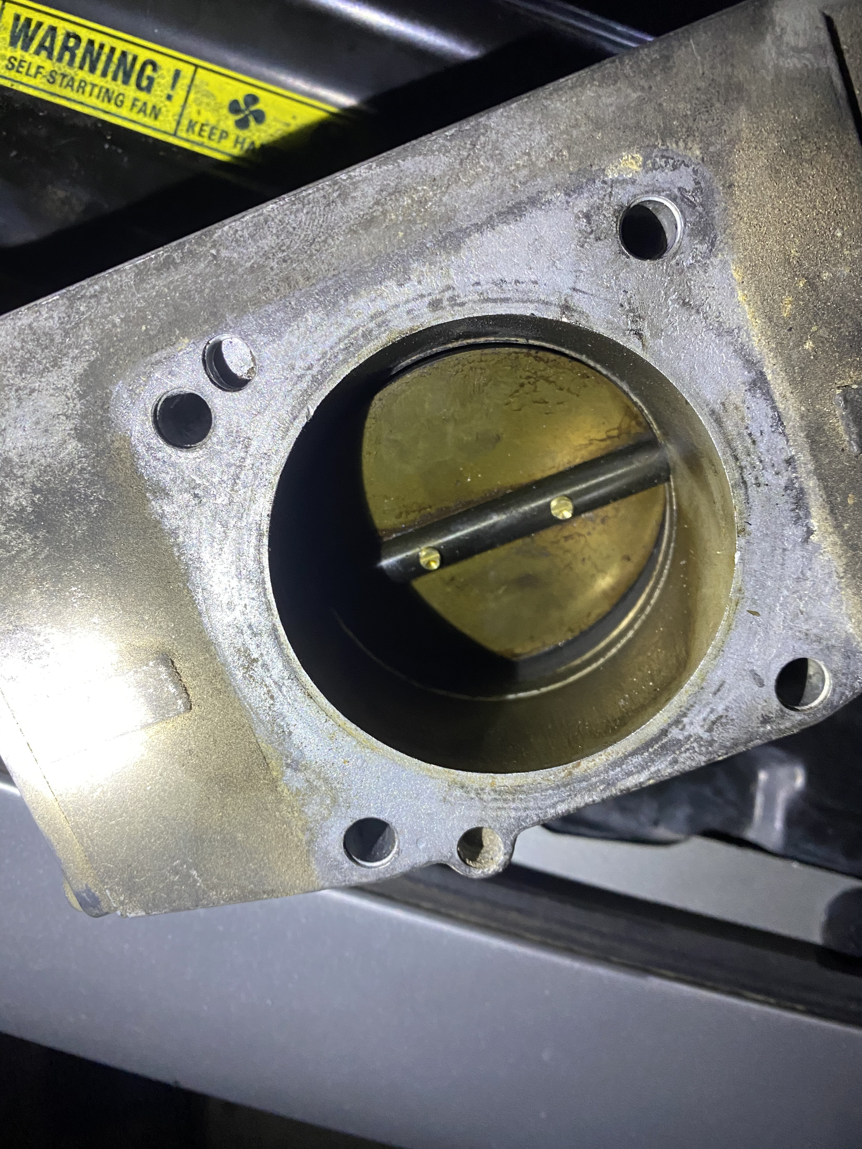

Today I replaced spark plugs with NGK Iridium, still hunting my dropping idle issue. Also changed my TCV and my cabin air filter.
Ordered a vacuum pump and MAF today from Rockauto, and ordered a power steering pressure hose, orings, and some bumper clips from the dealer.
