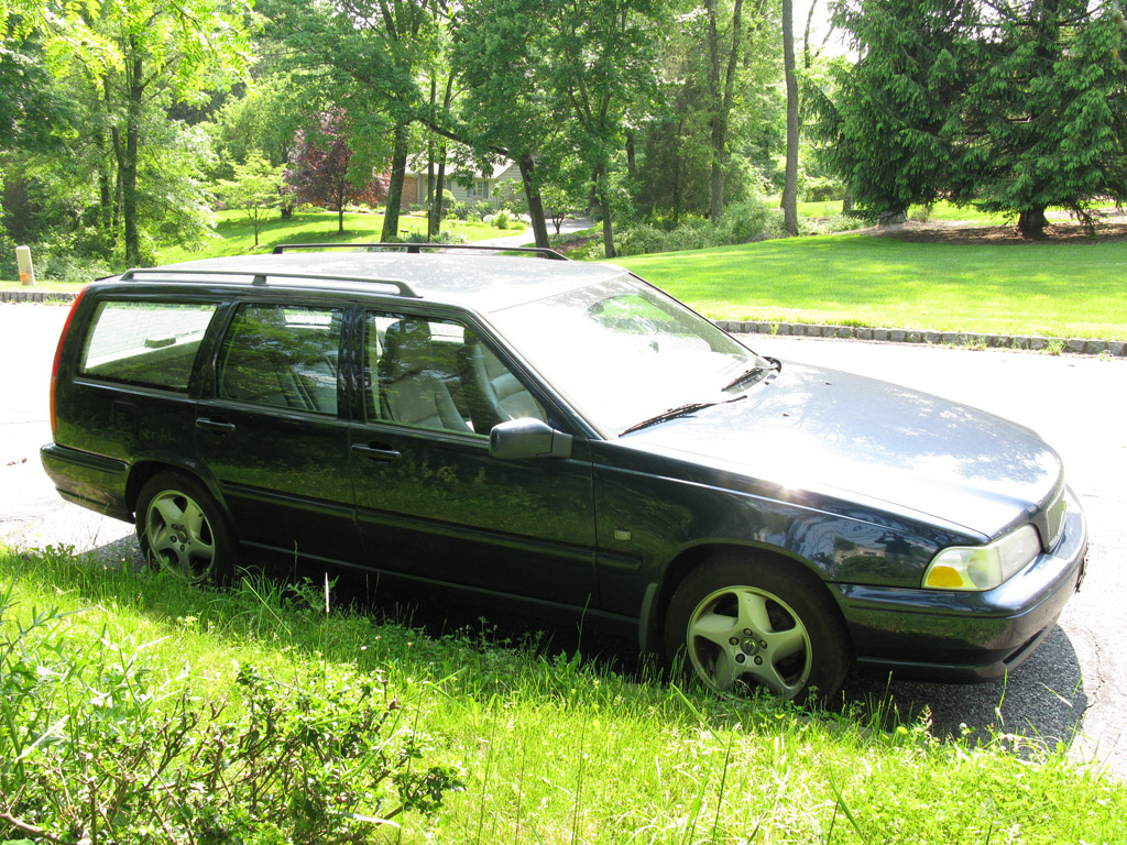

Those S/V70 T5 Perfo wheels are so sweet. I did just the opposite of you. On my 2000 V70, I put 850 turbo Columba wheels with the rare mirrored right side pair. Good work keeping your car rolling.

Nice to see I'm not the only one out here keeping the wagon dream alive!FireFox31 wrote: 08 Oct 2019, 23:00 Those S/V70 T5 Perfo wheels are so sweet. I did just the opposite of you. On my 2000 V70, I put 850 turbo Columba wheels with the rare mirrored right side pair. Good work keeping your car rolling.
