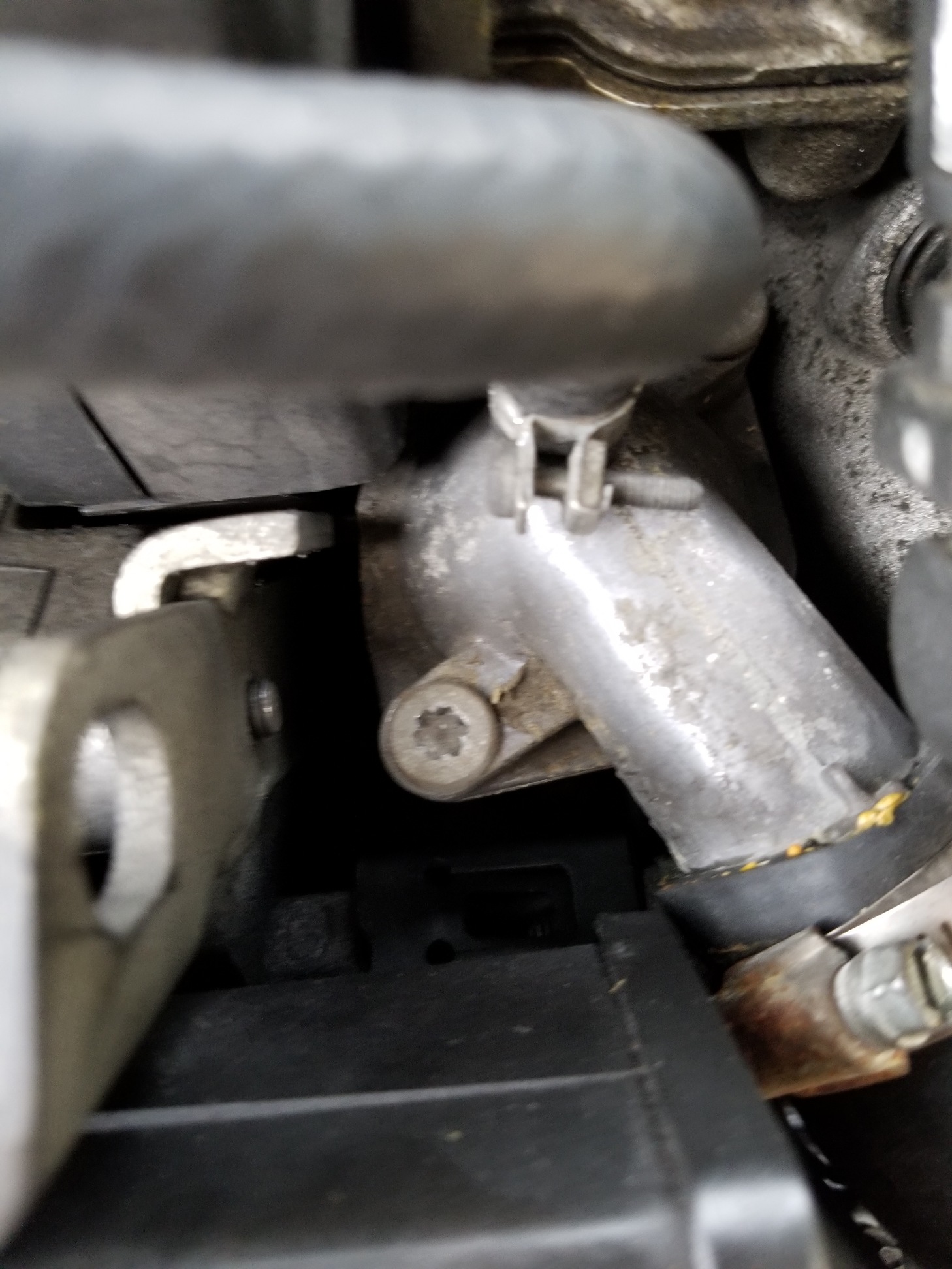

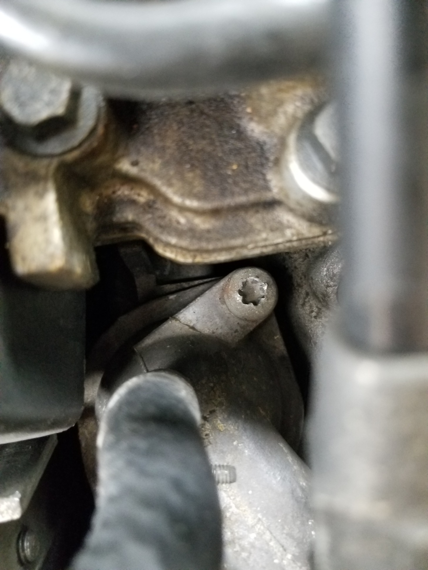

Take a picture of those thermostat bolts. Hit them with PB blaster every week - just a touch on the edge of the bolt to let it work into the threads. Give about 100 very light raps on each bolt after the PB. No metal deformation, just tap tap tap to help jar the corrosion.

I'm prepping for the same job. Purchased a new thermostat with bolts. I'm more afraid of damaging the fuel line to get to the driver side bolt.

Those should come out ok. They are a little deformed but Torx have a really good strength - don't re use them though, get new ones from Volvo.
They should be wet with PB by now!
Adding to this a bit...
A hex bolt under stress gets the point of the hex hardened off by the hard flat of the socket - easy to do as all the force is concentrate on the point, and often due to corrosion only one or two points carry the load.
To round off a Torx, the tool bit has to compress and machine off the triangle of metal in the fastener six times - which is really hard to do.

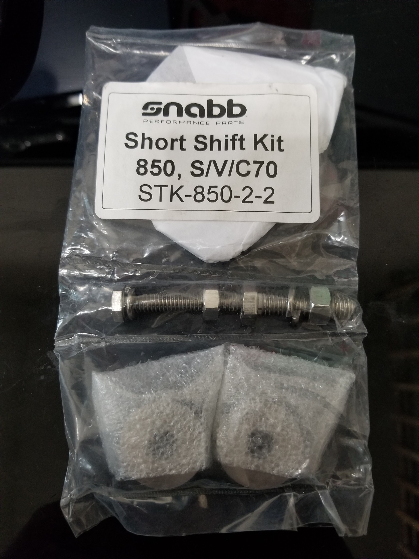

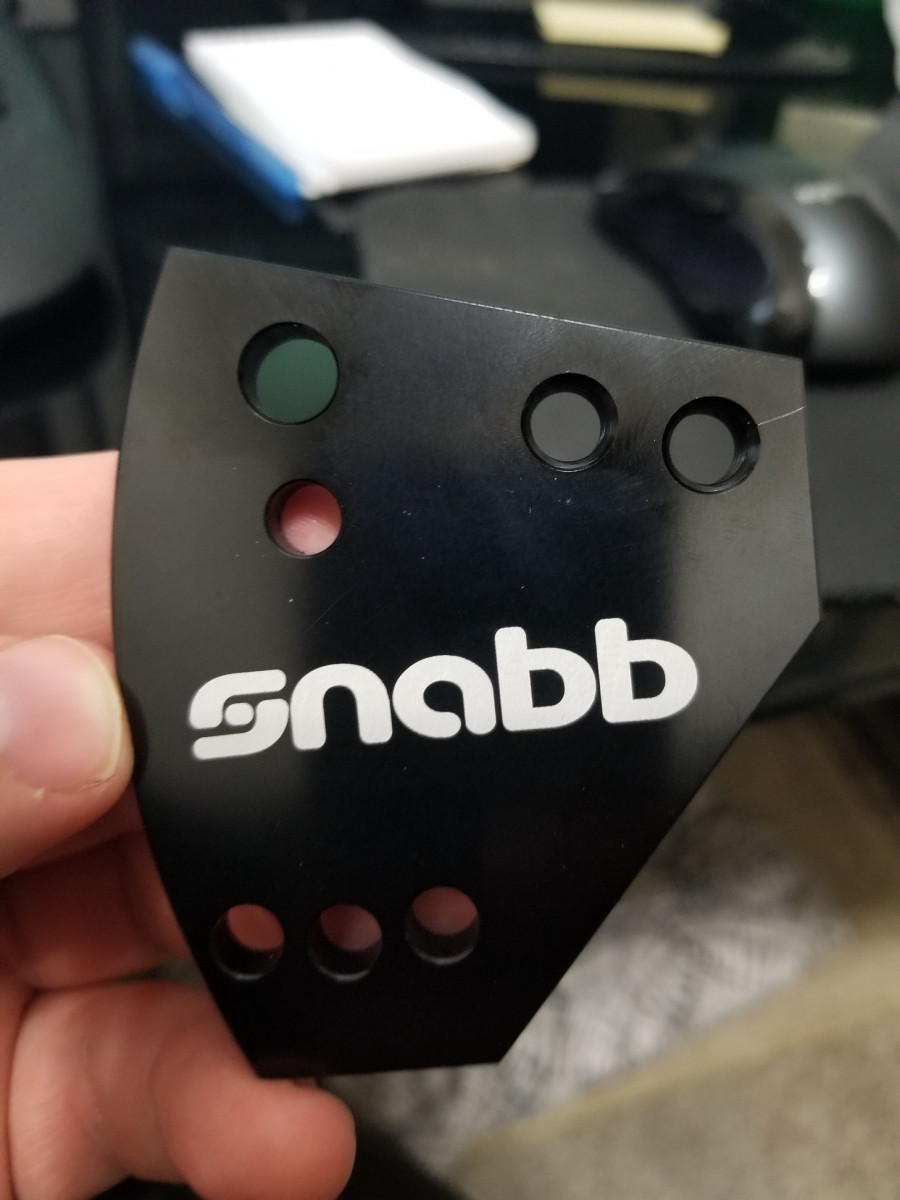

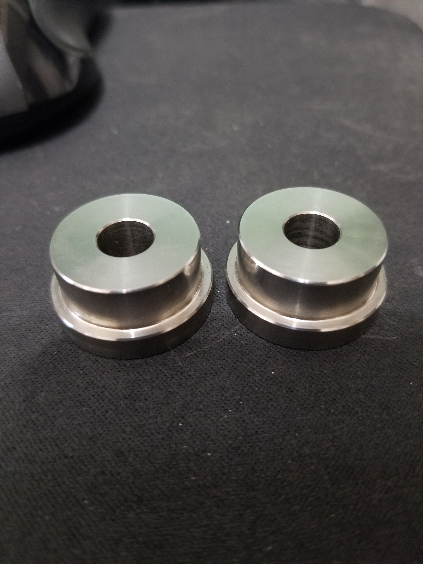

The old shifter bushings let go about 3 weeks ago during some spirited driving. So Herman got an upgrade:
Snabb short throw shifter kit with stainless steel bearings. Kit looks really nice I really like the plate design. New bearings shift right with no jiggle Old bearings were dry rotted and torn in the usual places.
