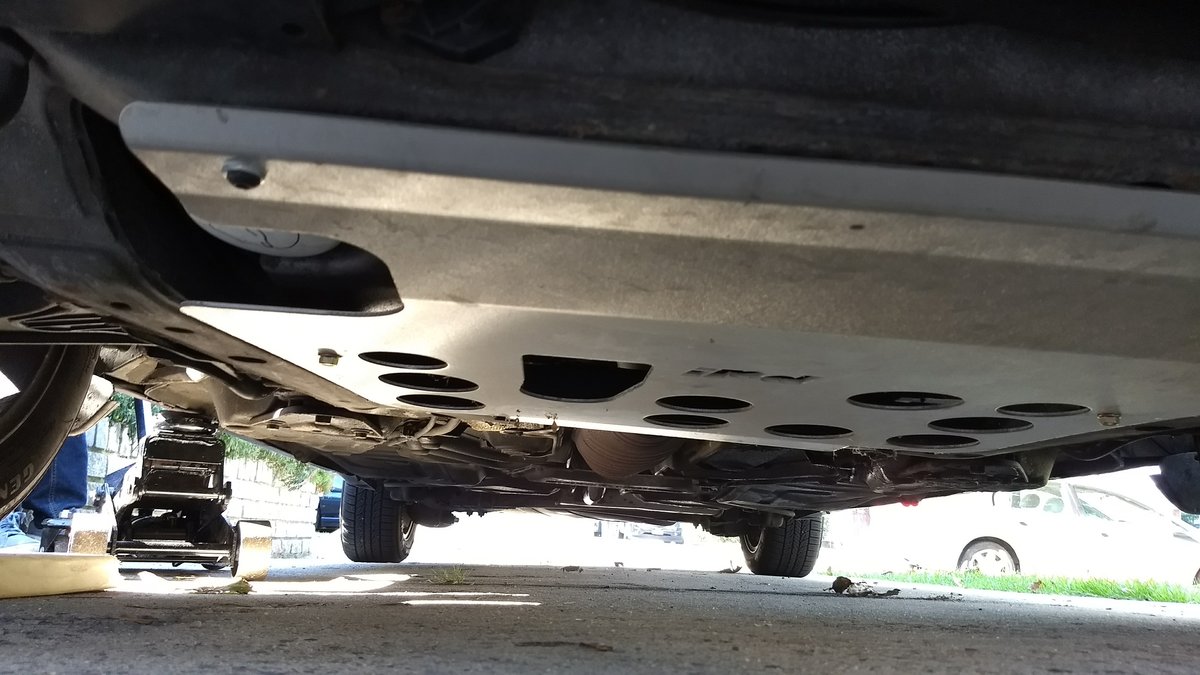

I attached an IPD aluminum skid plate on the ol' 1998 V70, with upgraded bolts to avoid the inevitable rust (thanks to my brother)!
Who's up for off-roading?

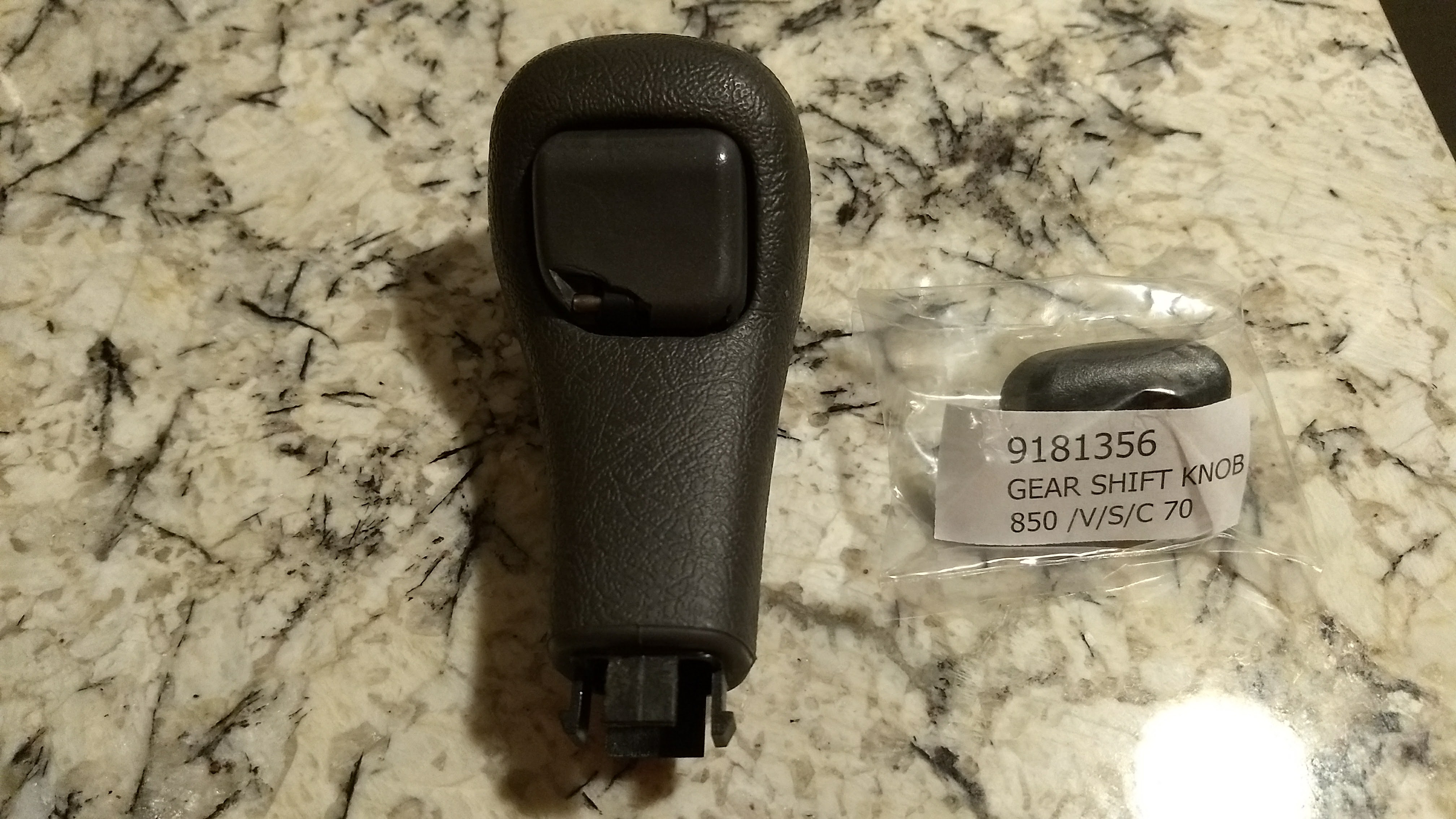

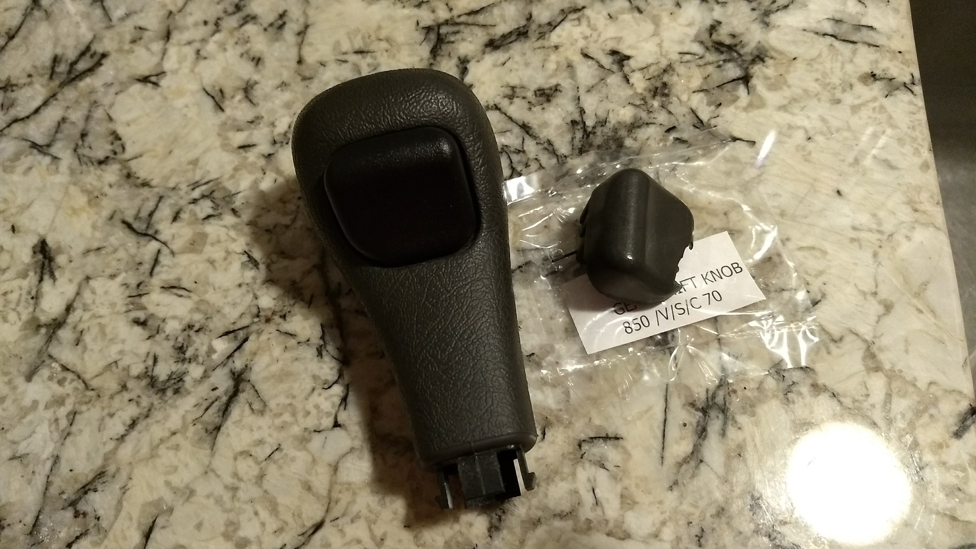

I finally ordered the shift knob lever for $15 (thanks, bro!) and watched a couple of videos before tackling it.
The knob was much easier to remove than expected. I was prepared to pull up on the shifter with the strength of 10,000 men, but it popped off with almost zero effort. (Or maybe I'm that buff from tightening bolts here and there?)
The lever took considerable more force to snap back into place than I had thought. After placing the spring back in its spot, I had to really squeeze the part to get the pins to snap back into place.
While the shifter was getting harder to maneuver for a good two or three months, I just figured it was a function of my 1998 V70's advanced age. Getting the key out of the ignition required digging the button out from its recessed position with increasing frequency, though I hadn't noticed how cracked the lever was until I got the knob off.
The repair was 100 percent worth it, even if the new part is black vs. the OE gray color. I'm just sorry I didn't do it sooner.

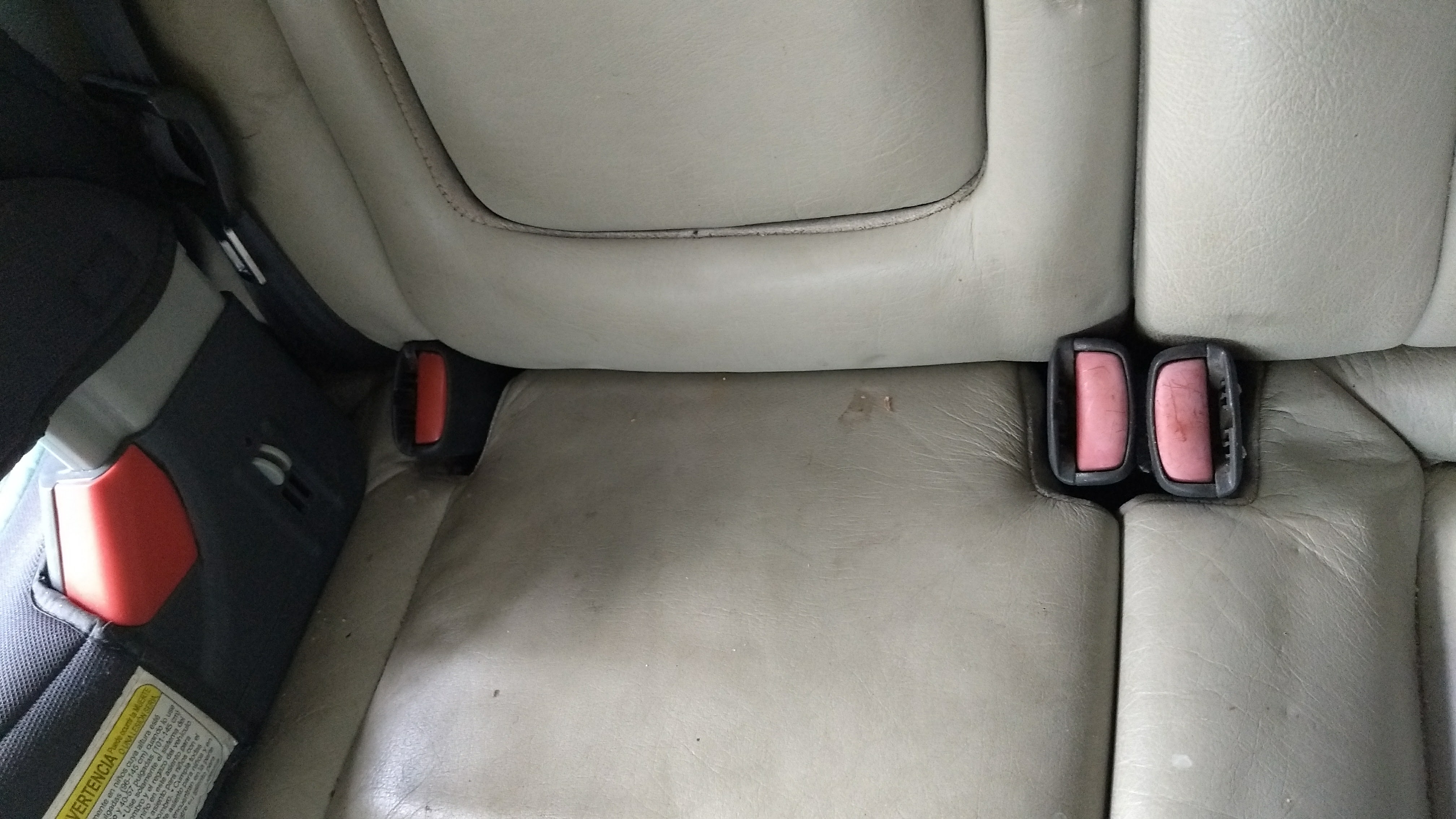

Those sound like some great PnP runs! My rear seat belt (double) buckle receiver stopped working for my middle child when we were all running errands last weekend, which was pretty scary. So, after dropping off one of them at home, I took the two boys to a local junkyard and found an almost-exact match. They were faded and the part number was different, but it looked the same, so I bought it for $25 and installed it right away. Thus inspired to search for a used rear hatch latch, a fuel line and a beige glovebox for my brother's S70, I visited four junkyards in the next few days without success. But I did find a tailgate latch on eBay!scot850 wrote: 15 Oct 2017, 22:42 Didn't do anything on any of my cars today, but made a successful run to the 2 PnP's locally. Needed parts for the 2 sets of roof bars I have for my P80's and there happened to be 2 cars, each one fitted with the 2 types of roof cross-bars. Got all the parts I needed, and also found a rear arm rest with the built in booster seat in black. I have promised one of these in exchange for some parts I was given recently, but the one they were going to be taking was in oak/taupe when their car was black. So happy to be able to pass one on in the correct color!

I really need to replace the button on my shift knob. I have to practically hammer the knob with my hand every time to get the button to pop out. I've done some serious damage to my hand with that thing!

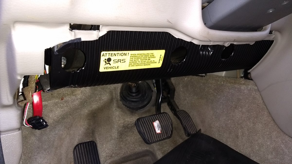

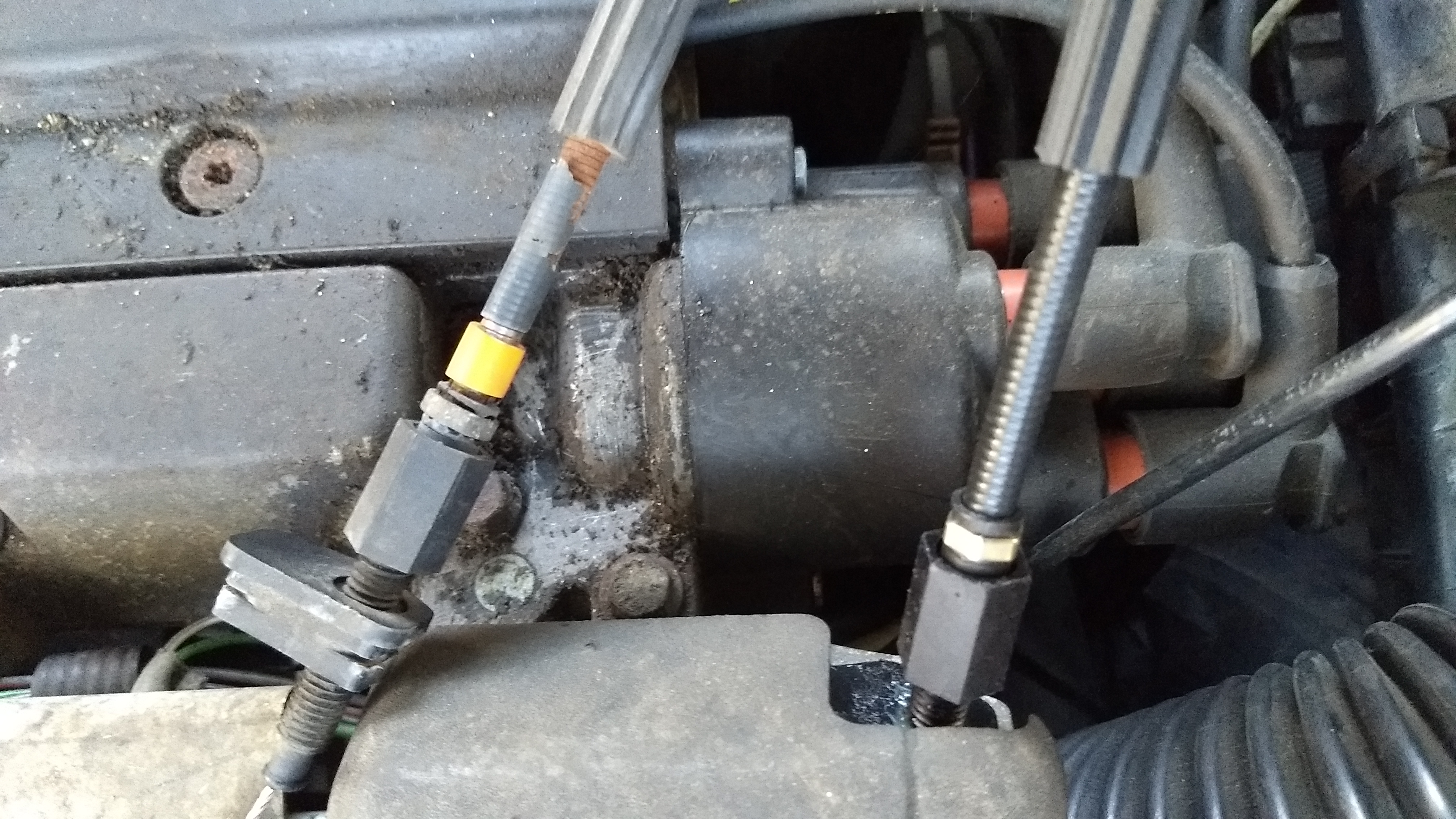

On an ongoing suggestion from my brother, I finally ordered and installed a new throttle cable to replace what appears to be the rusty, stretched-out original on the ol' 1998 V70.
The trickiest part was removing the clip at the firewall. I removed the lower dash panel (one T-25 torx screw) to get a better look at where the cable comes through the firewall but the insulation looked pretty solid. So, instead I pulled the cable with a vise grip from the engine side, and it popped out on the second try.
I connected the u-shaped clip at the throttle bracket first, and feeding the cable through the firewall was a breeze. The ball end went right through the accelerator pedal mechanism on the first try. Next, I connected the cable to the throttle mechanism, and lastly the firewall clip.
The wagon now accelerates with a feather touch, and it helps me imagine what it must've felt like as a new vehicle. Totally worth it!
