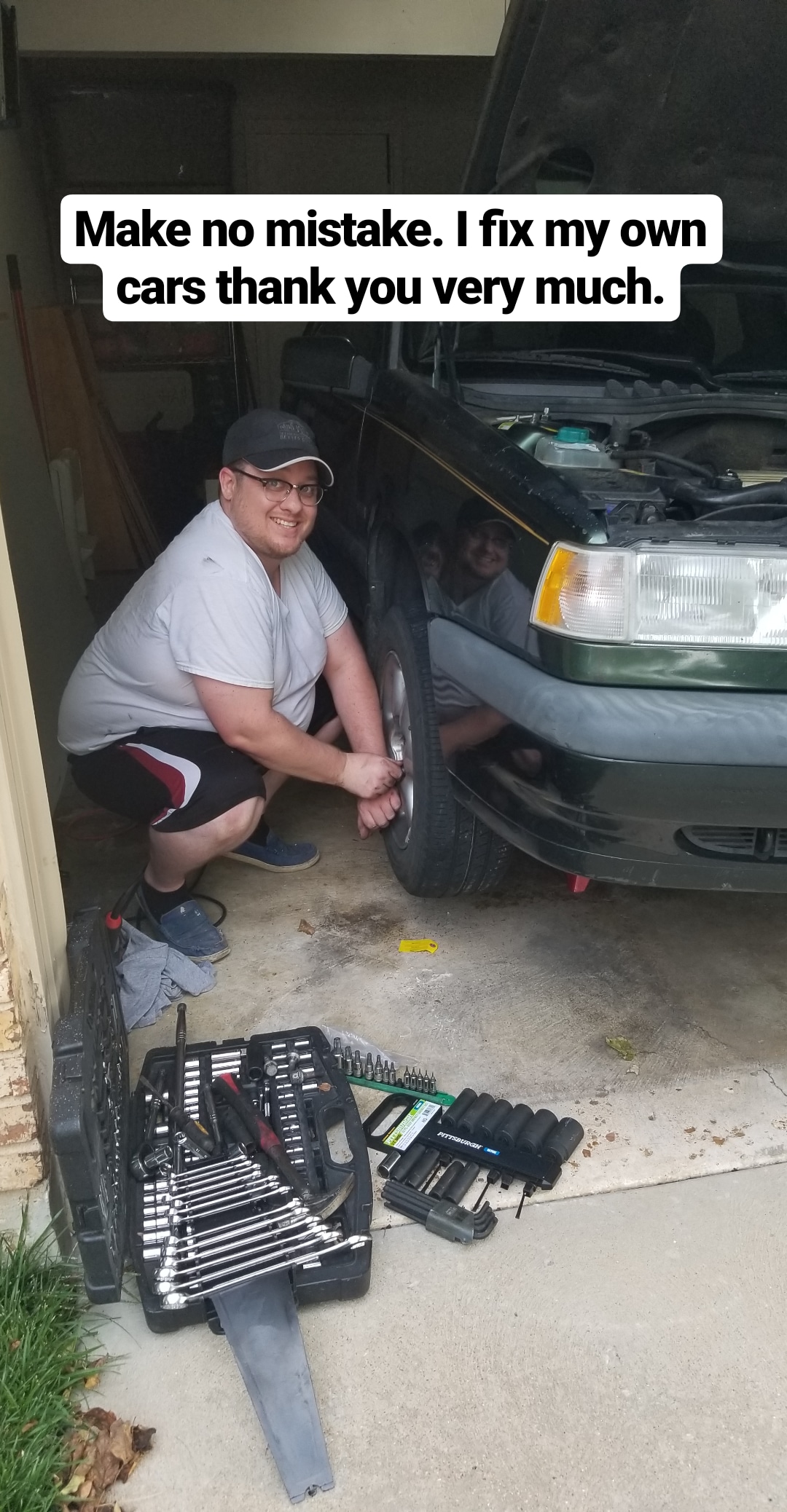

New quick struts went in this morning. What a difference.
Here's a not so flattering picture of me working on Herman
Tomorrow it's brake pads and brake lines. Sunday it's that pesky thermostat.
Bought a fresh can of bolt blaster for the thermostat occasion.
