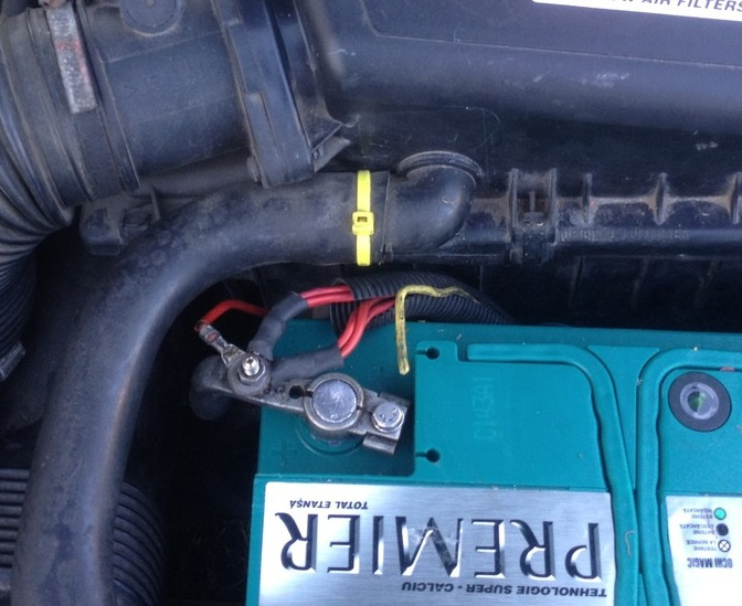

I googled "yellow wire at battery post Volvo 850" and found this thread with another
person having the same problem. They snipped the wire and the car works fine, LOL!
But I'm sure that something is not going to work:
https://volvoforums.com/forum/volvo-850 ... nal-84878/
This is their picture but here is the yellow wire:

I don't think so, all those reds and the yellow normally go into a big lug that certainly
looks to be factory. In that picture the guy cut out the big factory lug in order to find
the leakage current, then put new lugs on the wires.
That car and our car both have the yellow wire that goes into the factory harness so
I'm quite sure that it is factory.
