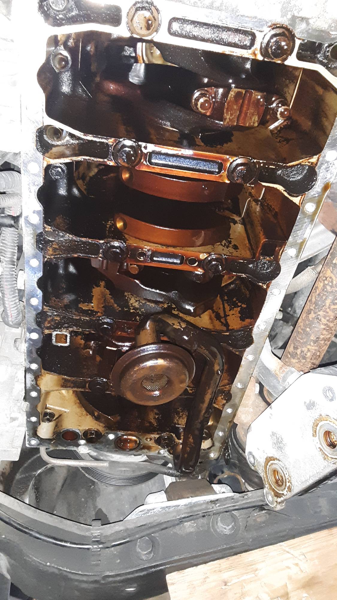

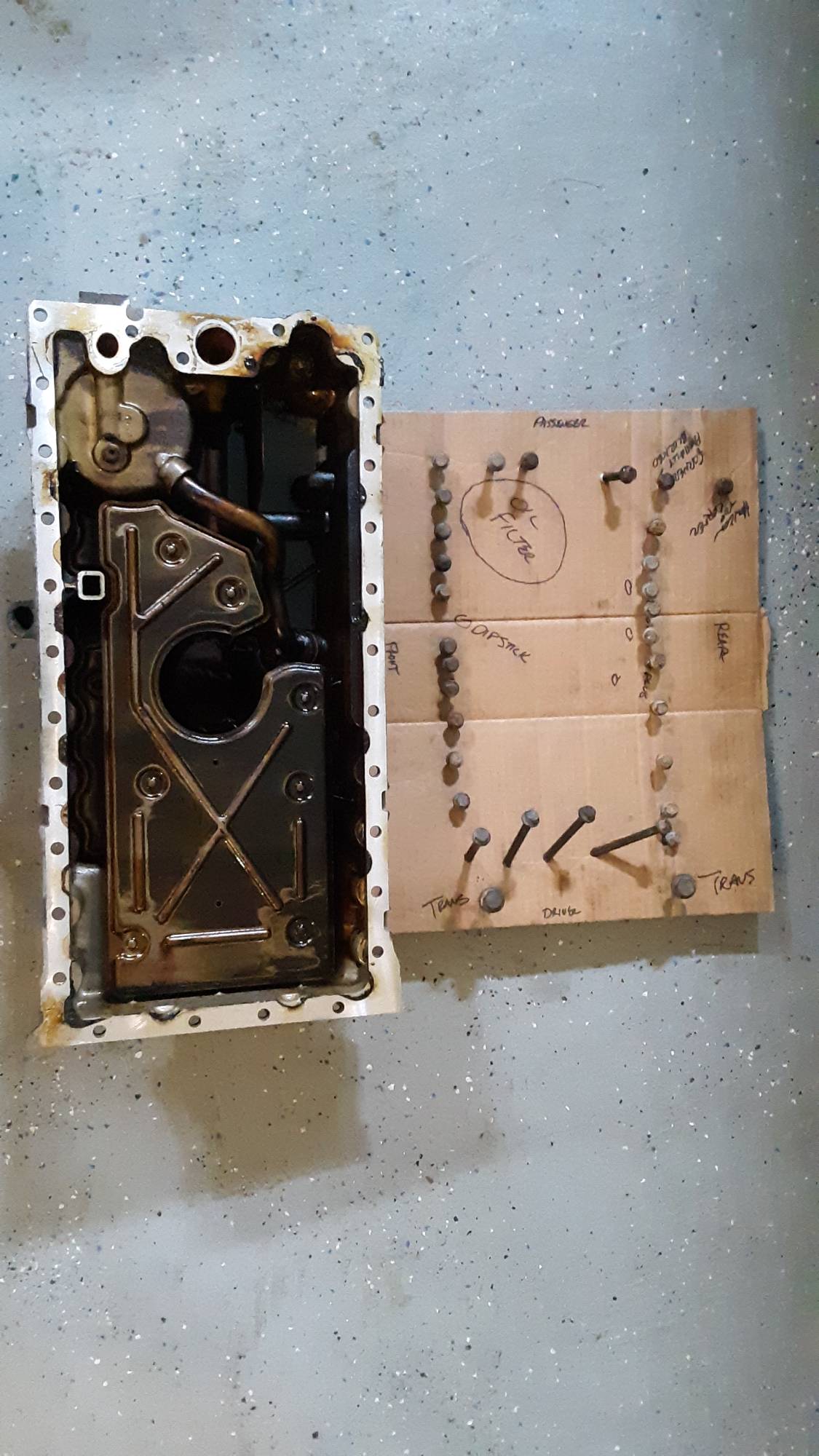

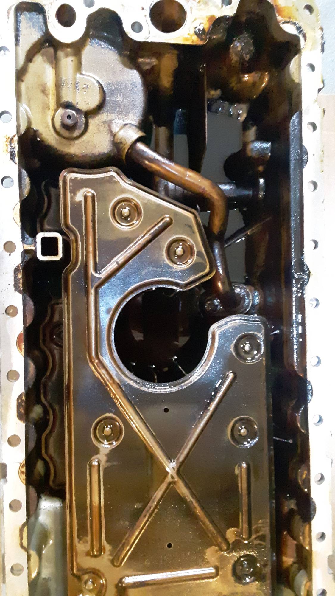

Resealing to fix my foamy engine oil. Bought this 02 at 150k miles for $1500 (currently at 180k), thankful it strongly passes the glove test with the innards looking like this. I have some cleaning to do!

This looks OK. Don't clean the tower, only the pan. You may also want to inspect and reseal the oil pump, it may have deep some scratches in the pressure relieve valve from the dirt floating in oil. Better replace it in such case.Krons wrote: 21 May 2022, 07:06Bought this 02 at 150k for $1500, thankful it strongly passes the glove test with the innards looking like this. I have some cleaning to do!

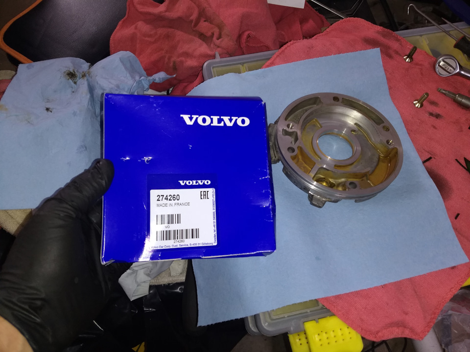

Volvo sells pump seal kit:
Check pump's tolerance with straight edge and feeler gauges while it's there on the bench. If the pump is worn too much - buy a new one.

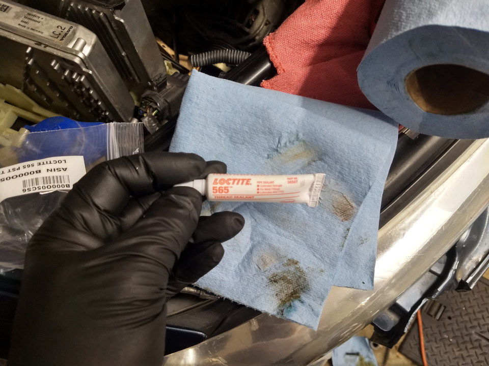

The bolts go all through the tower and must be sealed with a Volvo-expensive compound. Decided to try Loctite 565 and it worked great. No leaks a year after.
