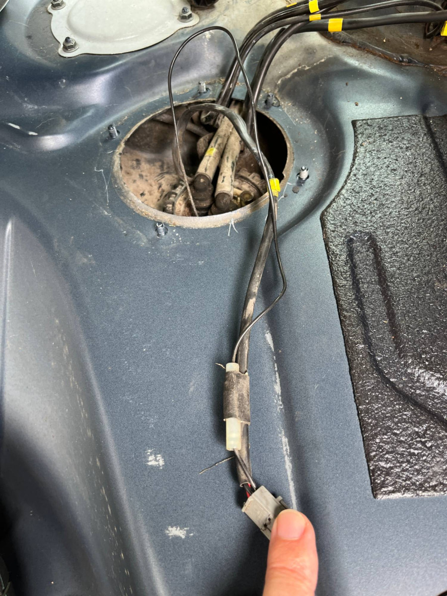

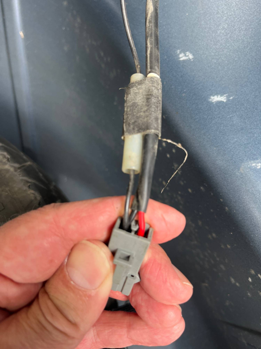

I got another chance to take a look at this last weekend and changed out the fuel pump for good measure, to see if this car might start. A big Thank You to Abscate for providing the pump. It made no difference of course. Just to recap, it's a no crank situation trying to start with the key, and the fuel pump is also not priming.
When I pulled the old pump out I found an additional black cable attached to the connector, which goes out an opening in the sheet metal behind the pump and dissapears under the car. There is no grommet or anything and it looks like someone added this, and I am wondering if it has something to do with my problem. Next step is to see where it is connected on the other side. But also I am wondering if anyone else has seen this before:
A while back Mr Abscate suggested connecting power to the Remote Starter connector to see if it will crank. So I fabricated a harness with a switch, and it works well. I had him on the line on the weekend and he suggested to spray some ether into the intake snorkel to see if it has spark. So I did that and the engine coughed nicely.
So it has spark and no fuel, but although I don't hear any priming from the pump I guess I should verify with a pressure gauge.
Thanks, Dirk
Thanks, Dirk

- Posts: 15498
- Has thanked: 2203 times
Interesting. No idea what that black wire is. Could it be that issue has been there for a long time and someone ran a direct feed to the pump from a live source somewhere else in the harness to bypass the immobiliser?
- 850 LPT
- Posts: 1973
- Joined: 27 May 2011, 08:05
- Location: CT
- Has thanked: 335 times
- Been thanked: 247 times
Thanks Neil, that's an interesting thought. I didn't think about am immo bypass. Clearly a PO had a problem with something since it is sort of a hack job. Although it's neatly done I must say.scot850 wrote: 15 Jul 2024, 08:17 Interesting. No idea what that black wire is. Could it be that issue has been there for a long time and someone ran a direct feed to the pump from a live source somewhere else in the harness to bypass the immobiliser?
Next chance I get is crawling under the car and see where that wire goes but that might take a while again.
Dirk
