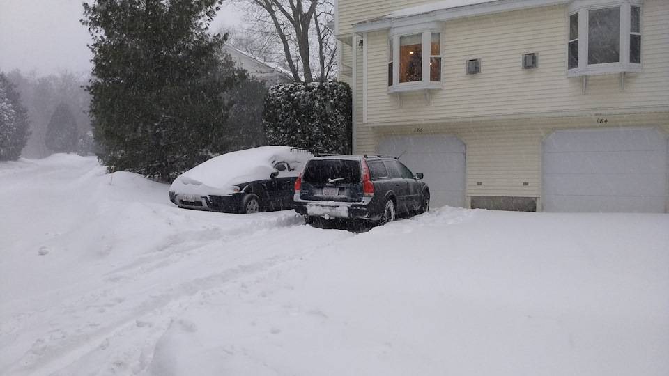

You're on track and received Odin's blessing! I did that in cold December as well
Both wagons would not fit in garage, and for some things I needed them face to face, so often had to work with the garage door opened and snow blowing in my face.
