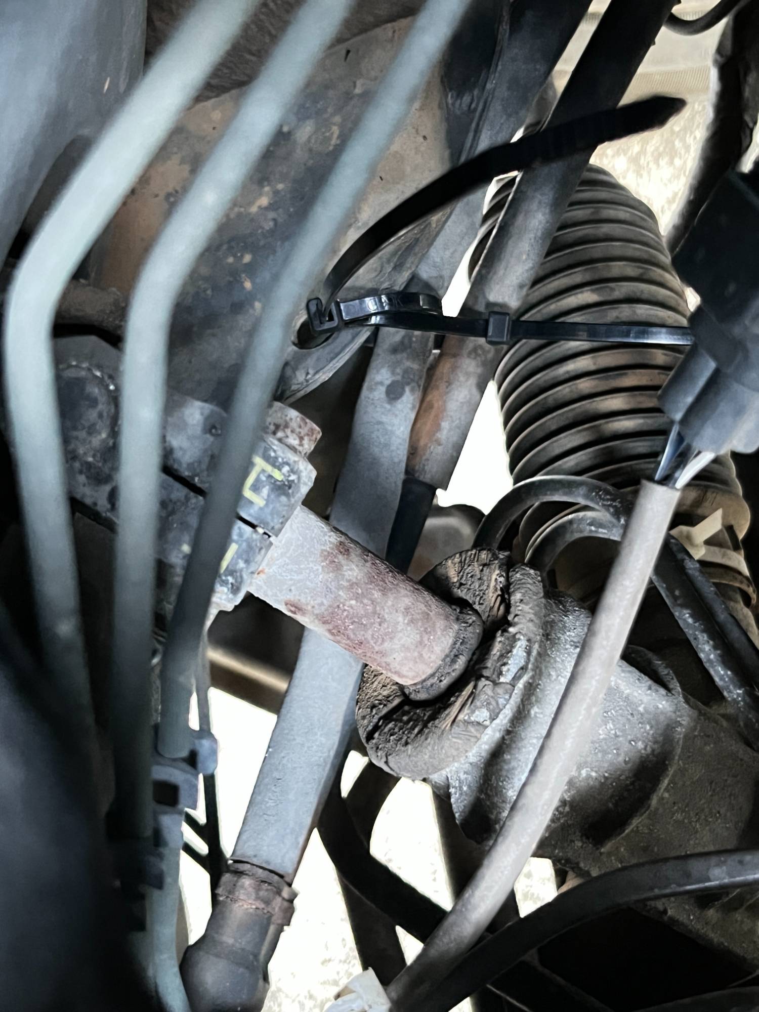

Let's start with the good. The Volvo has five wonderful shiny new motor mounts. That's peachy! But this didn't solve the problem. The thing still refuses to shift into 2nd, 4th, or reverse. And after having a friend shift for a while so I could watch, I realized it that towards the firewall, one of the cables seemed about sheered in half internally, bending a lot on certain shifts. Furthermore, there's a little hole where (I'd imagine) a bracket would be... but there is no bracket in sight.
The ziptie was added by me, in an attempt to create structure. And they were fed through the hole that I feel a bracket would/could/should be. But the cables are still corroding, with bits of the outer rubber peeling off.
This isn't great, because from what I can gather these shift linkages are made of unobtainium.

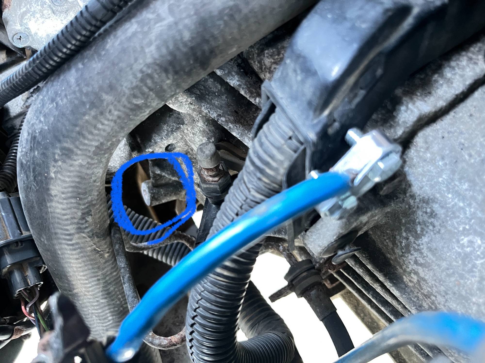

But it gets better. Because we had a little mishap while attempting to remove the original front motor mount. In order to squeeze it through everything, we removed one of the ground cable to the engine... this meant disconnecting the battery (which we didn't do originally, so what happened first was we saw some sparks fly around... and then we disconnected the battery).
Unfortunately, that bolt broke. But after a trip to AutoZone we managed to find a new grounding point that we think should have worked (as pictured above. Circled is where the bolt broke)... except now, the ETS light is off, but anytime you touch the throttle the car refuses to stay alive. Almost immediate death unless you're flooring it. This was not the case the last time I ran and drove the car a few days ago, so maybe it's as simple as a reprogramming from Volvo. But it's another expense, and one I'll need to get a tow for because without half my gears and an engine that keeps dying, it's near impossible to drive it. Just getting it in my driveway is a chore.

That ground is critical and critical to the ETB. You should be able to get a ground on a new spot to eliminate that problem. The ETB is a computer module that receives CANBUS commands from the ECU through a shielded , twisted pair communication bus. If that isn’t grounded right the comms get scrambled and chaos reigns

My spares are up North in the Den of Thieves and I have a critical patient this week. Move that ground over to the block near the broken screw
