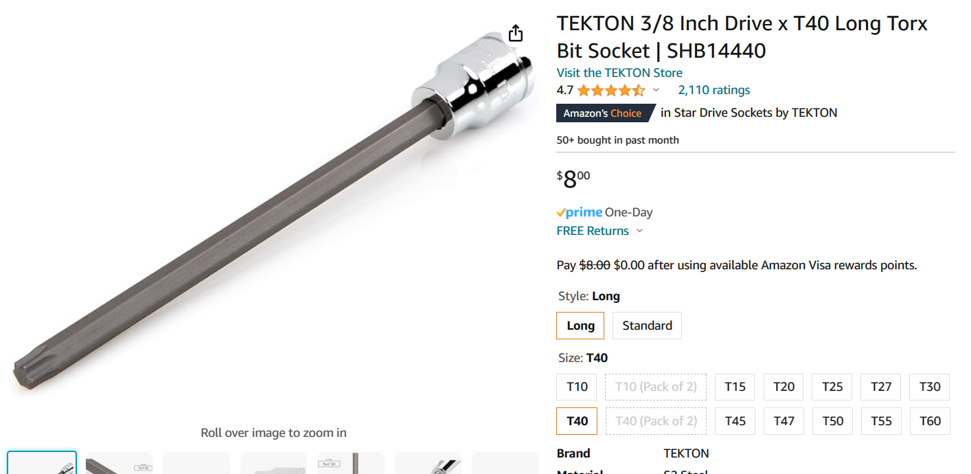

mar601 wrote: 28 Apr 2024, 10:29 How in the heck do you get past that line on the right T40 torx on the thermostat? I tried my socket with extension and bit and no way.
I'm looking at ordering one of these -- one is a Klein which is nice but wondering what you use to get access to that screw?
https://www.amazon.com/gp/product/B005G ... 0DER&psc=1
https://www.amazon.com/gp/product/B0CH1 ... RL4X&psc=1
Think one of these will do it? -- thanks

1. Socket drive T40, long.
2. "T" handle T40 wrench.
3. Another "T" handle T40 wrench.
Good luck with it.
Here is a pic of the T40 long socket drive tool:

70, single, and don't have a pot to ____ in. Yeah, that's the socket I bought.

Replacing the thermostat was pretty easy on my 96 and 99. I did not have any trouble with the bolts. The gaskets are rubber, so no gasket scraping of a paper gasket like would have been required in days past.
Unless you've got something odd going on, you should do just fine. Just make sure the socket is fully seated in the bolt. I didn't break the seal of the upper hose, since I wasn't replacing it.

Those screws can be reluctant because of a bit of galvanic corrosion, they go through to air on the bottom of the travel; certainly squirt them down with your Magic Juice of preference. I prefer PB over WD-40, but WD makes a penetrating fluid as well. Kroil is good but hard to find and otherworldly expensive. Use a straw and try to get some under, then go have an iced tea and wait a bit. Get the hose out of the way - if it's been ballooned it is likely stretched and should be replaced anyway. Apply a bit of gentle heat to the screw heads, respray, and another iced tea. Apply patience. Good luck, let us know.
