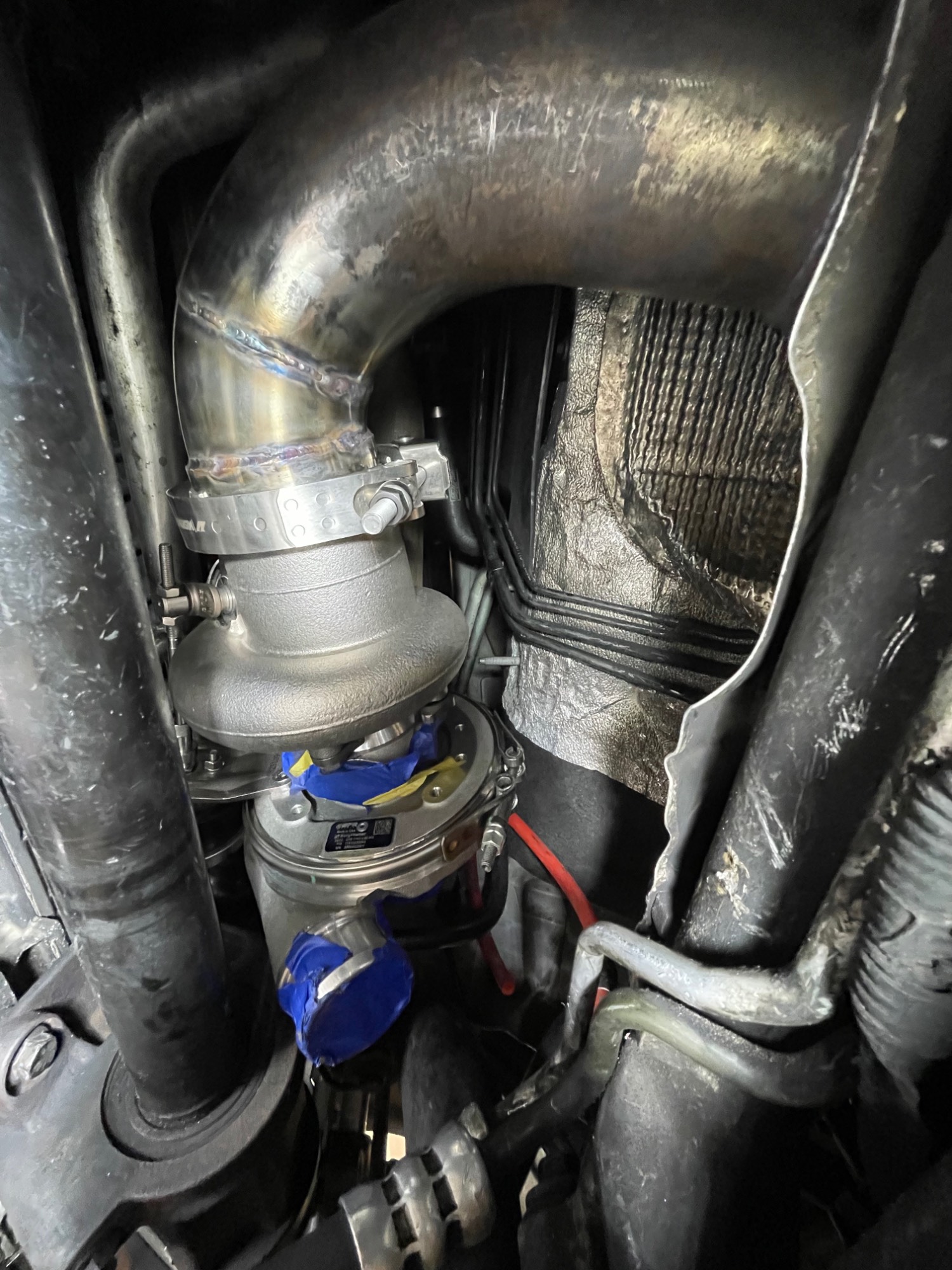

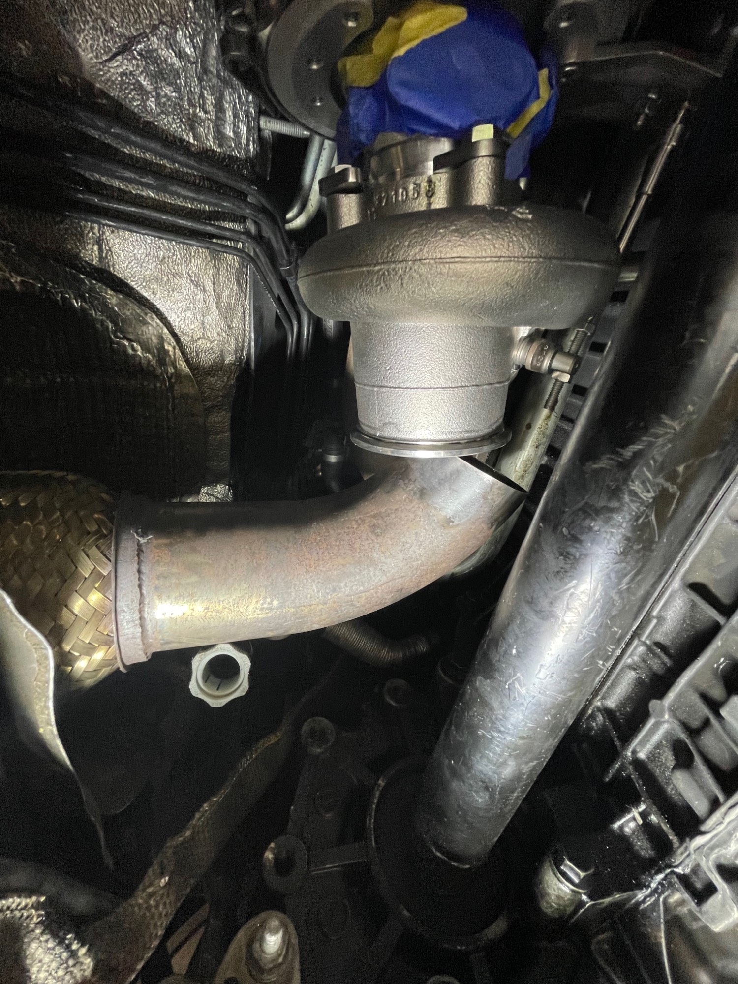

Turbo is mocked up in its future permanent home. Had to fabricate a v-band adapter to clearance the turbo and allow for rotation to ease the angle on the down pipe entrance and delete the water lines that used to feed the OEM "oil cooler"

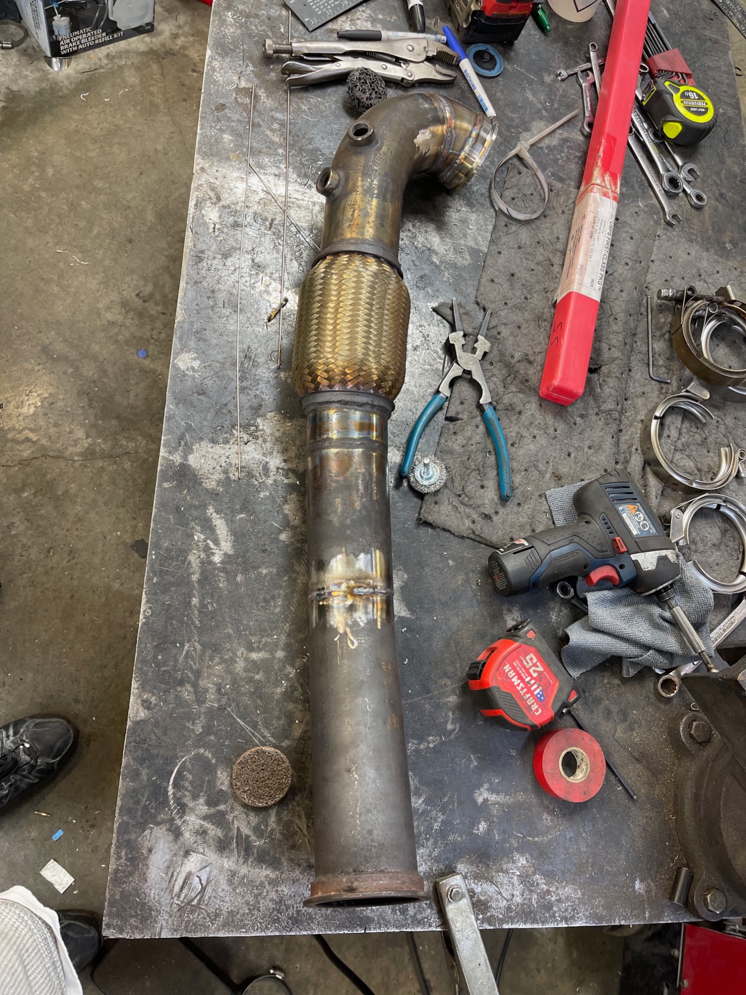

bend in old downpipe
modified to fit new set up

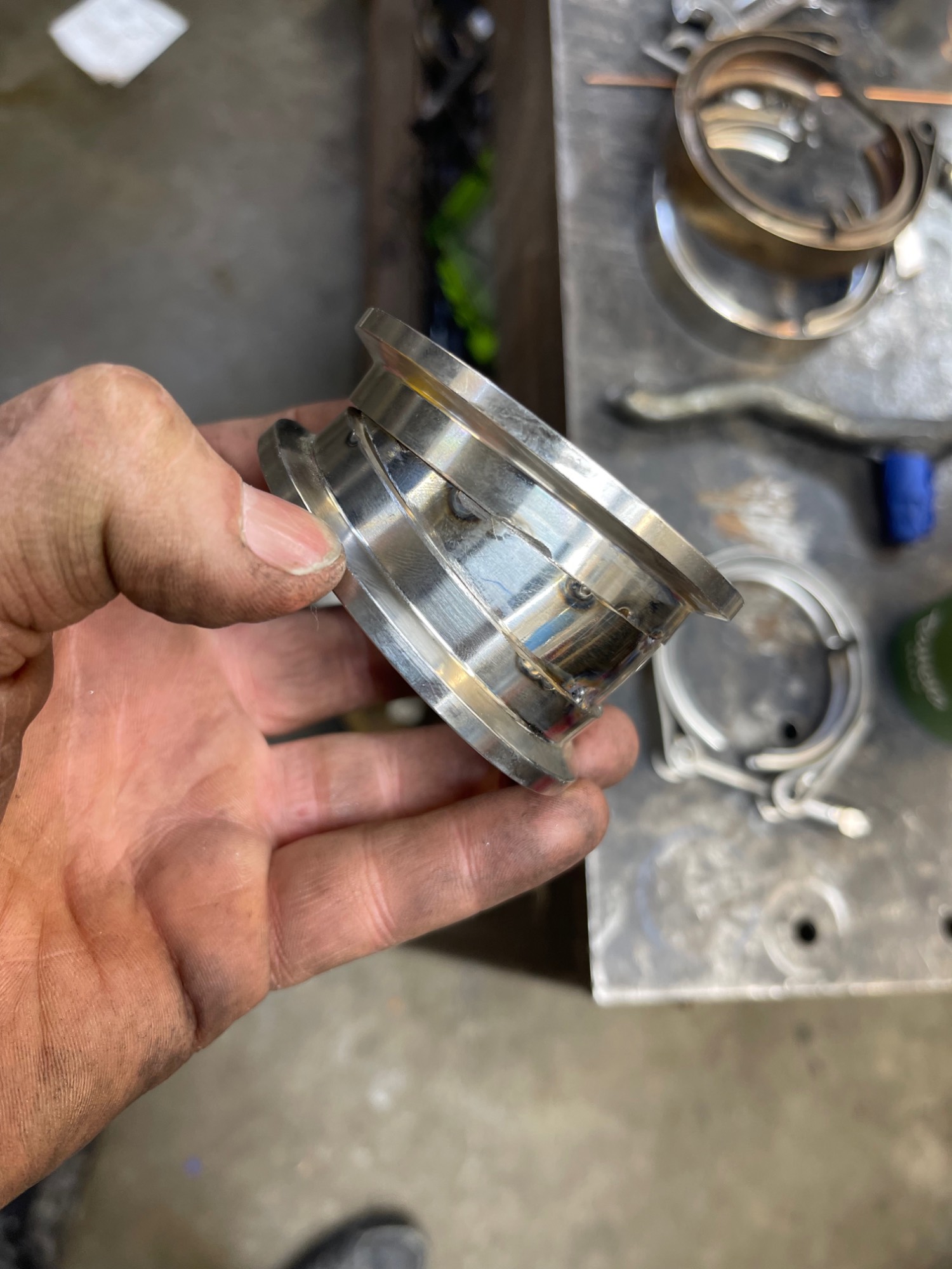

v-band adapter to move turbo away from block and allow for rotation so bend in downpipe is as little as possible

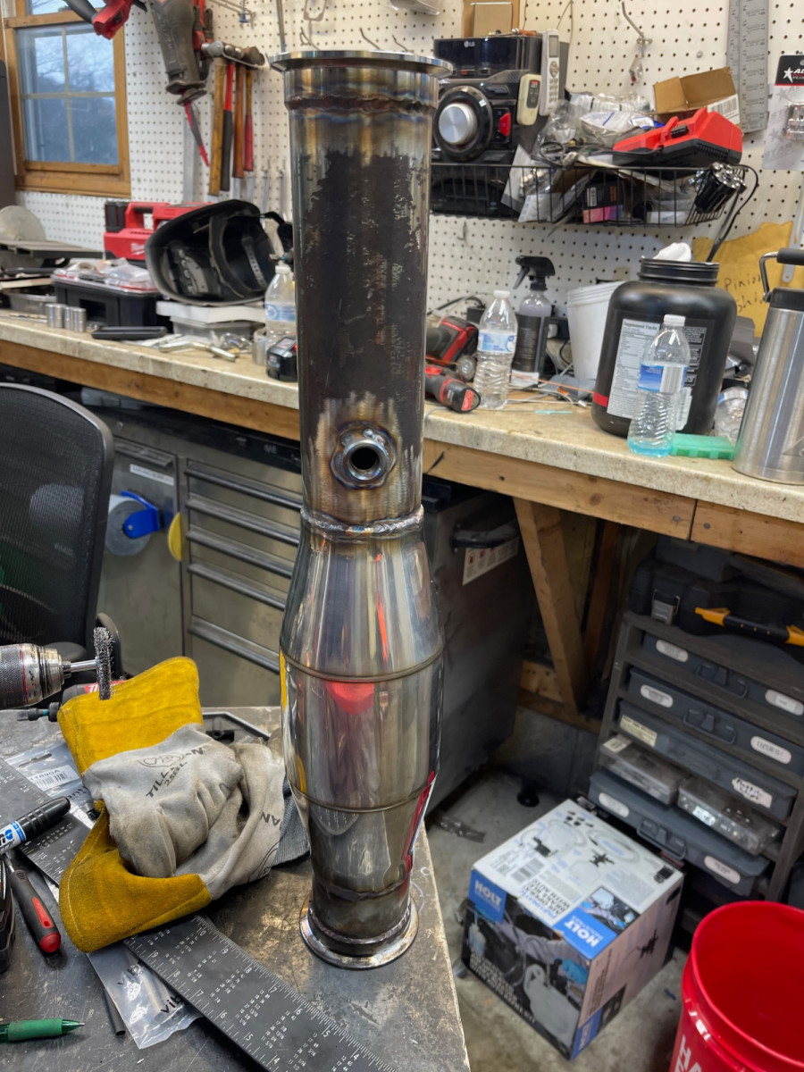

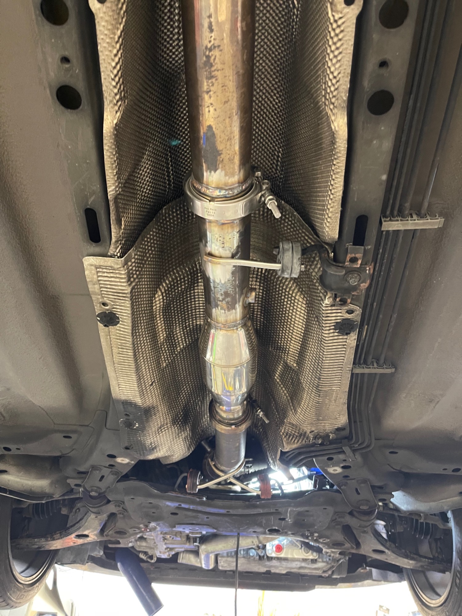

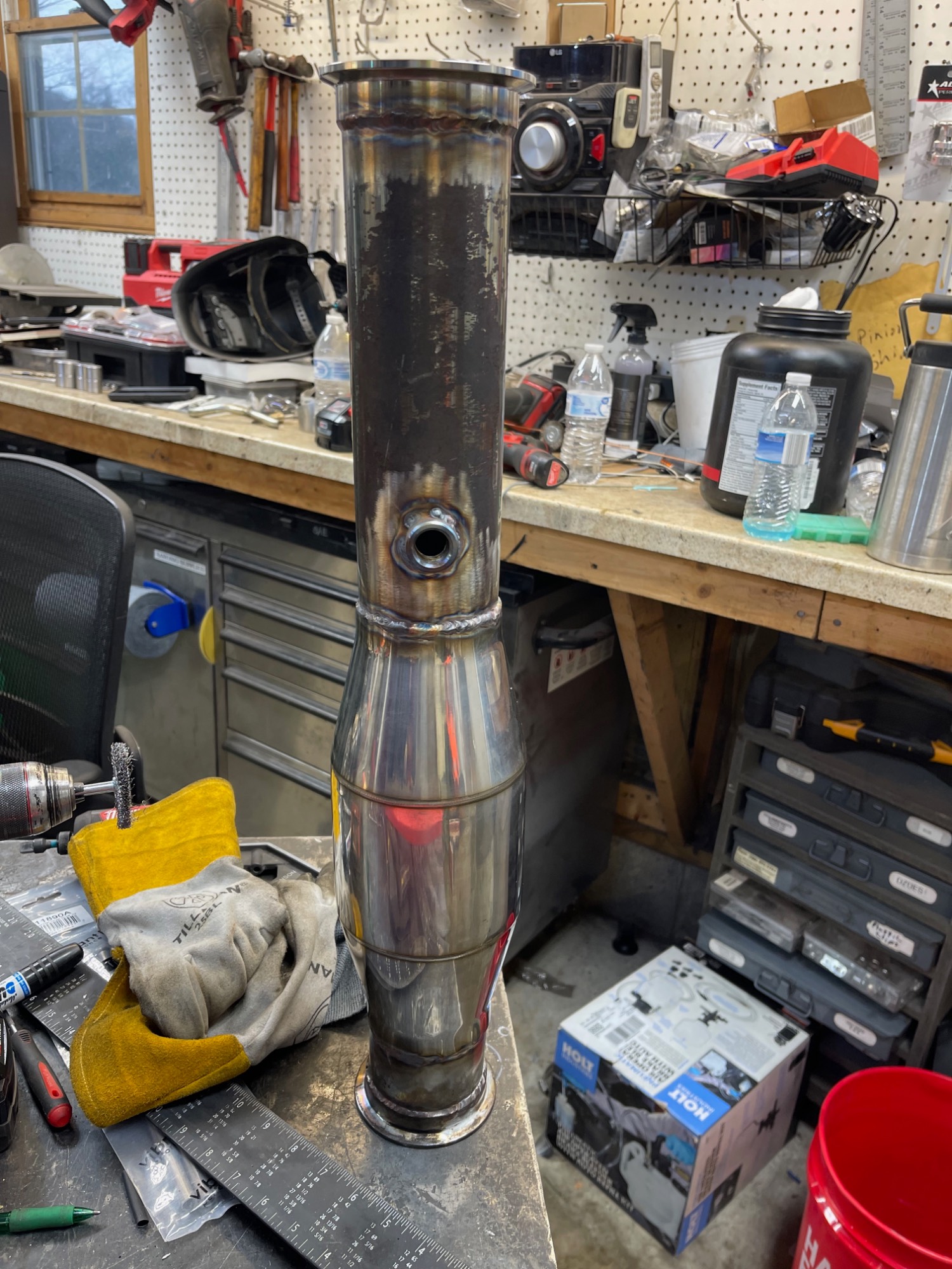

vibrant 200 cel cat w/ v-bands and o2 bung

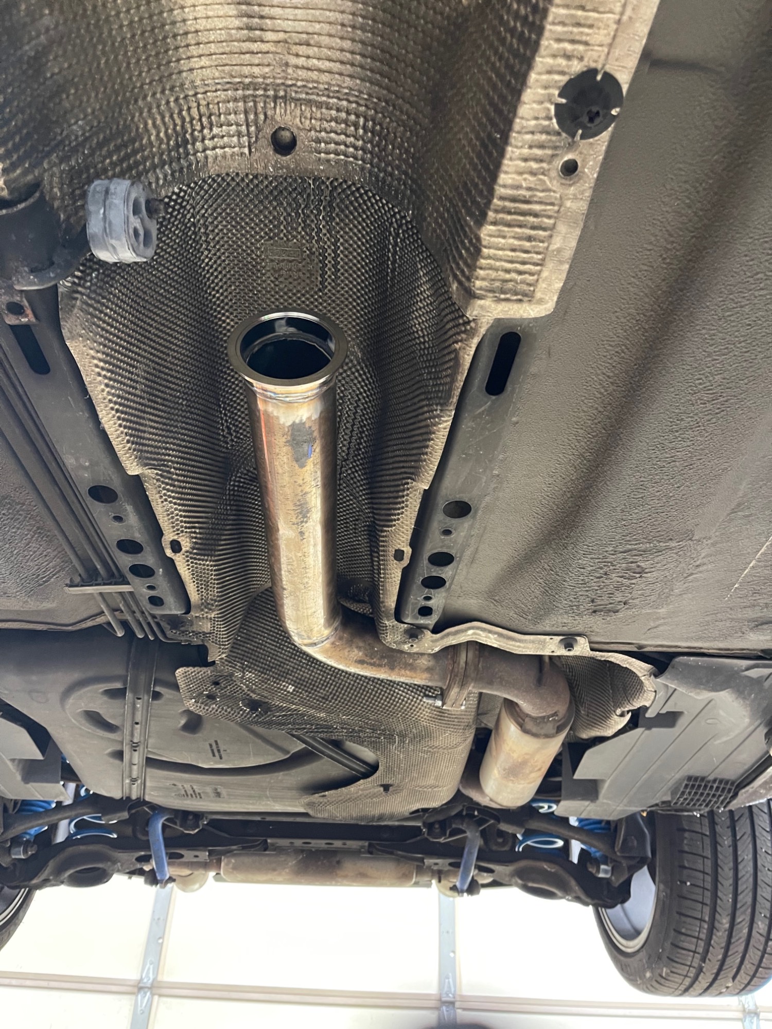

had to cut a 1/4" wedge out of the bend on the Elevate exhaust as the mandrel bend was over bent. Now the exhaust rides in the center of the tunnel
had to cut and modify the tail of the downpipe as well to compensate for the new bend in the neck exiting the turbine housing

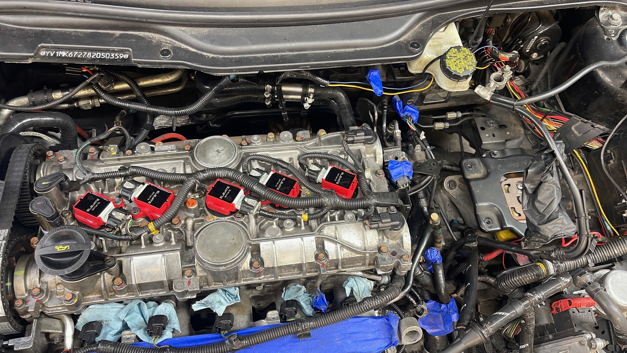

Installed Elevate coils
Installed all new do88 coolant lines including at the firewall and eliminated the plastic joining fittings
removed the factory airbox mounting point from the lower intake manifold

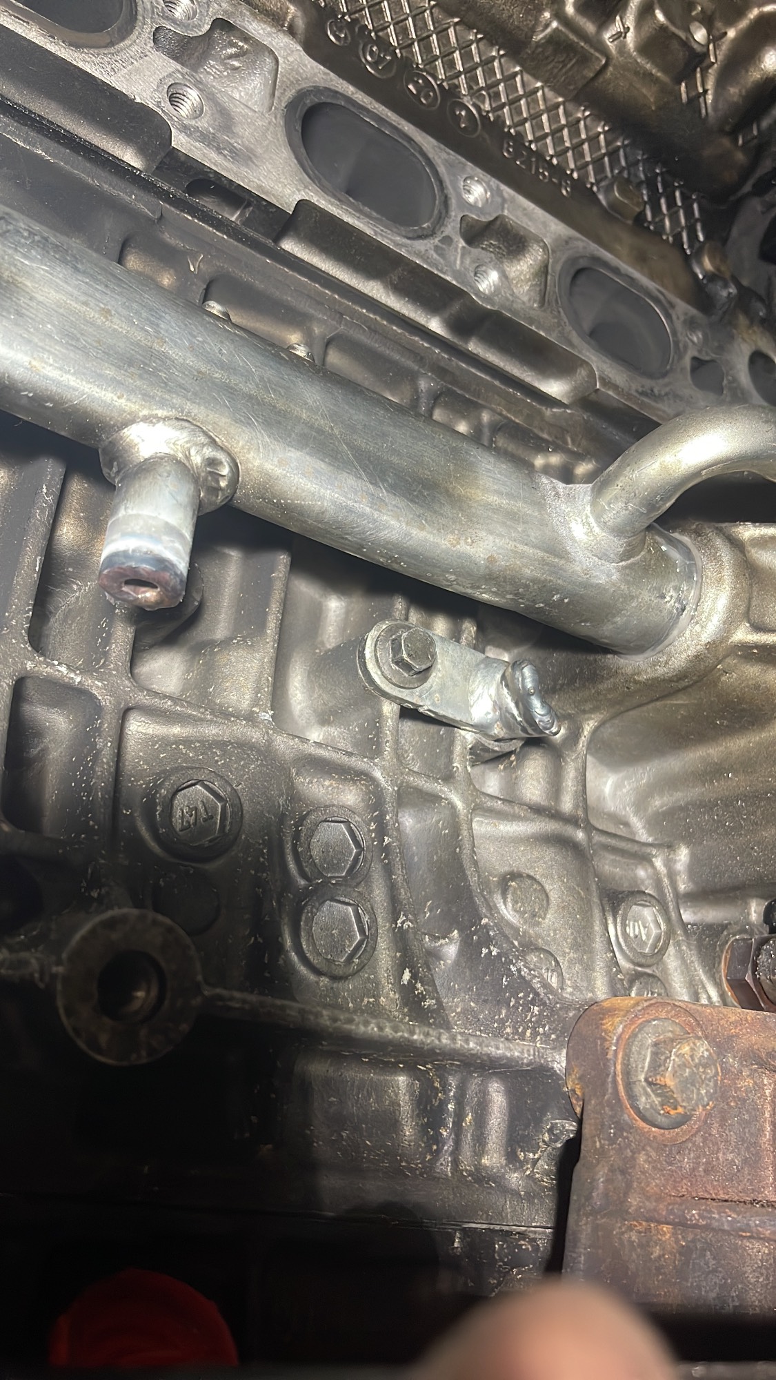

welded shut the factory oil cooler feed and return lines
removed the factory fuel line
Elevate coils
Elevate coils

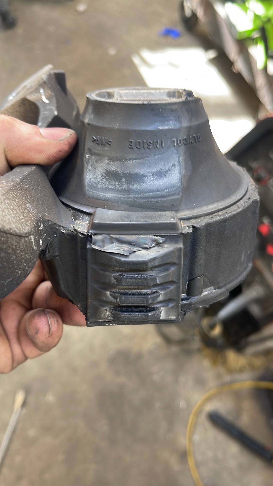

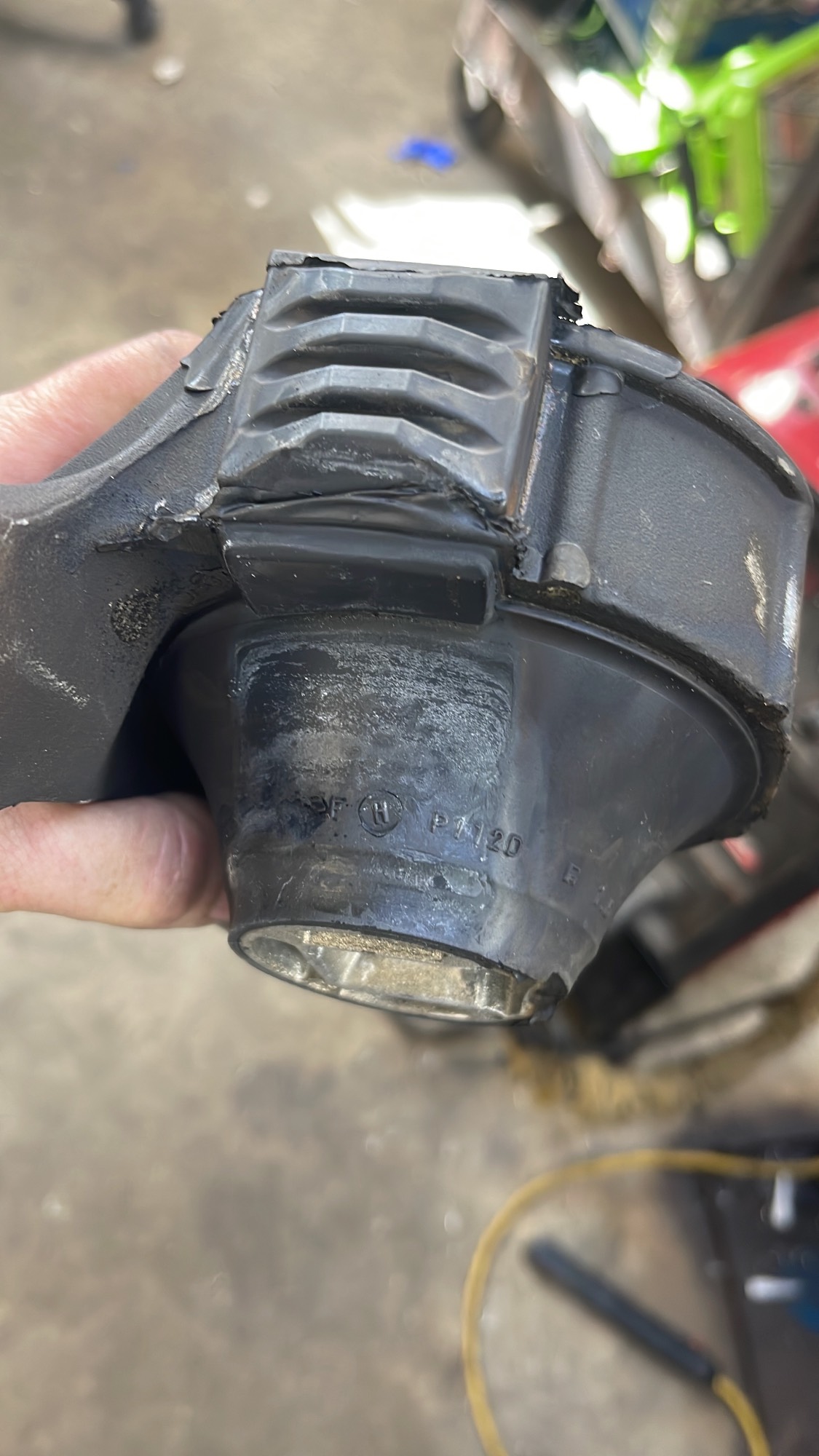

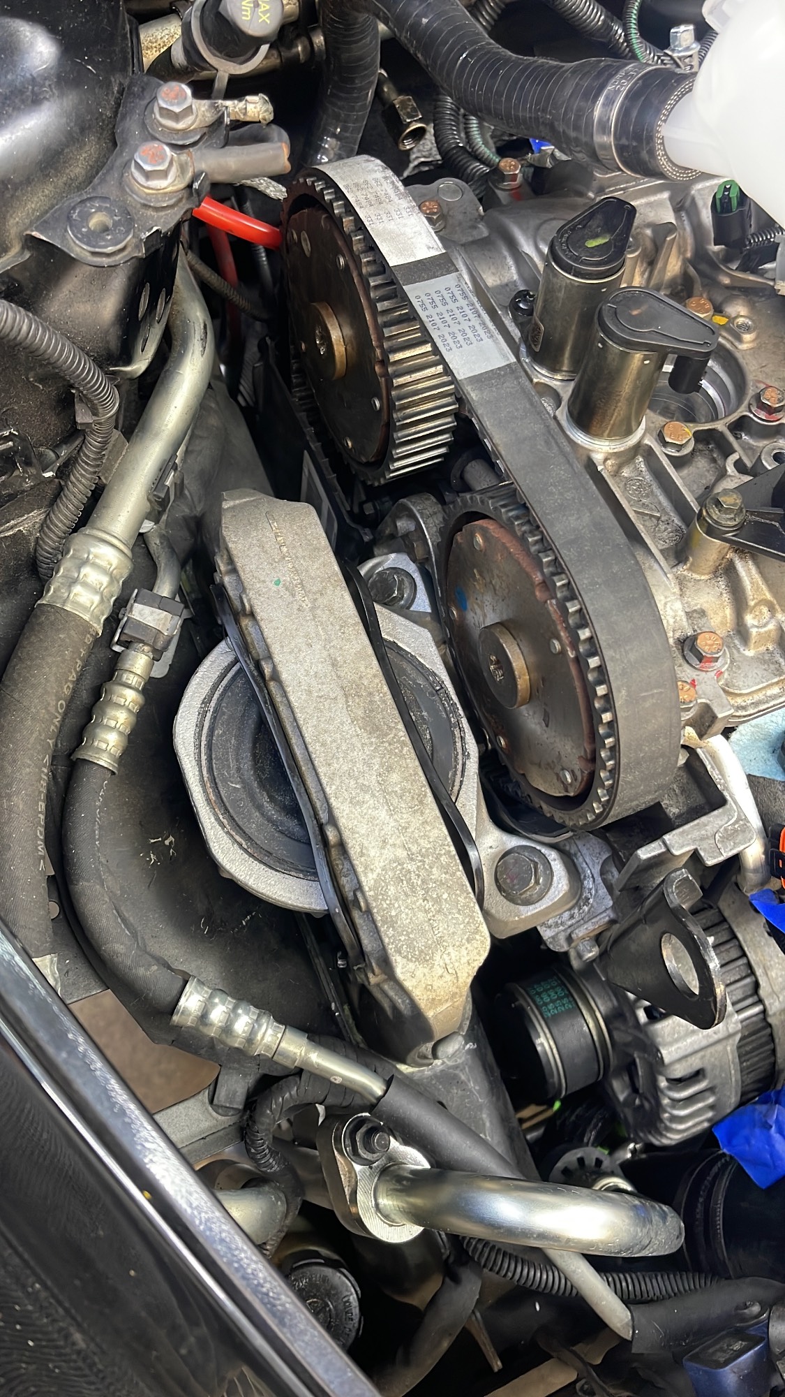

installed passenger hard race motor mount w/ Powerflex poly 95a duro inserts (stock mount with 70 duro Powerflex poly was trashed)
exhaust mocked up
exhaust mocked up
Hard Race mount w/Power Flex poly 95a duro
damaged stock mount
damaged stock mount
damaged stock mount
damaged stock mount

I should note: the above factory mounts are the 3rd set in 4 years

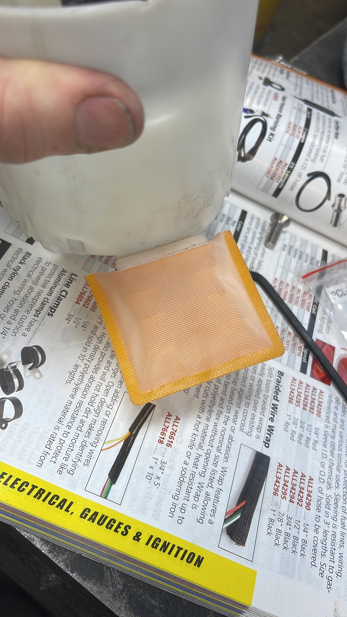

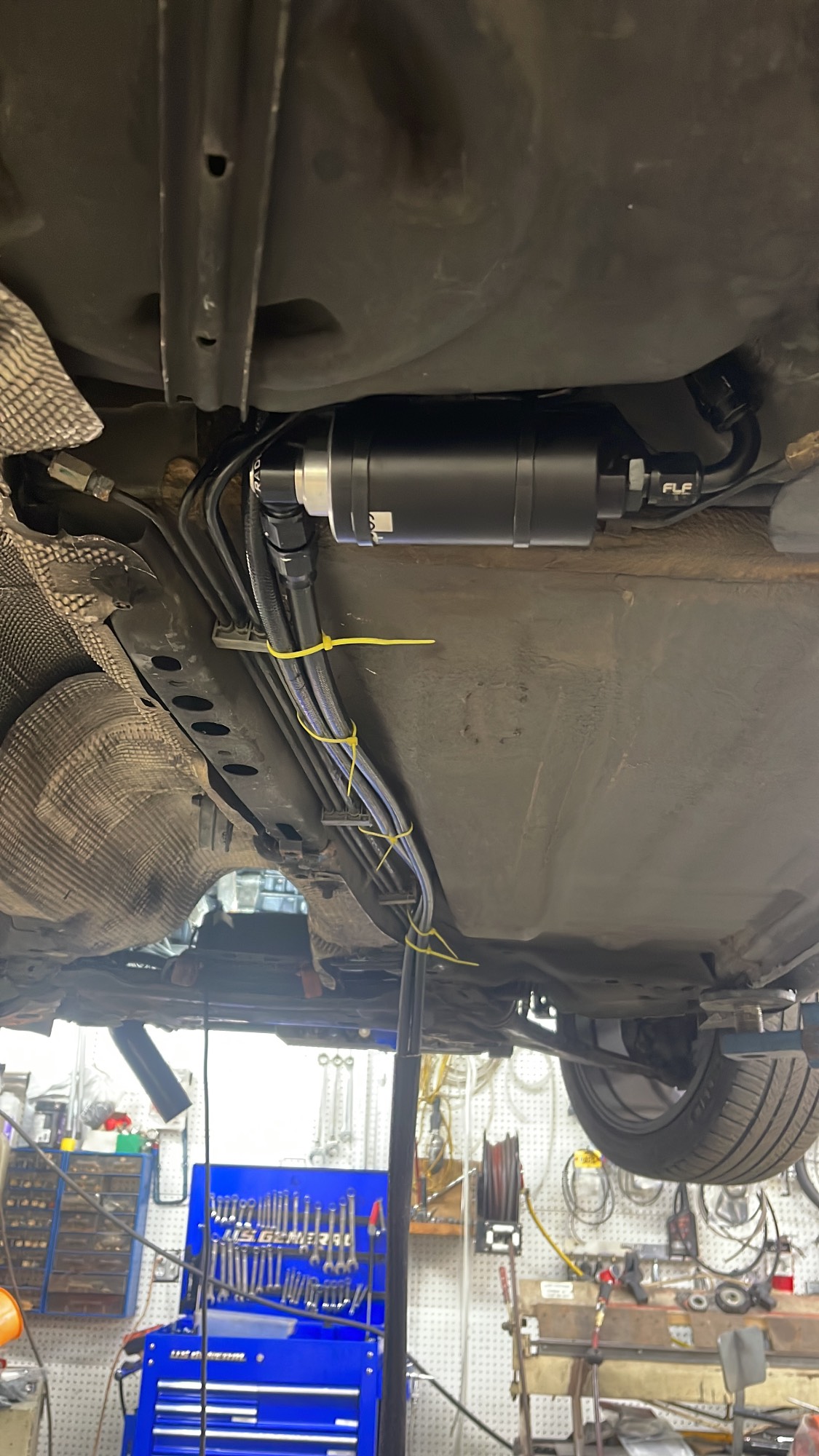

Modified the water tree. Factory fuel pump hanger in order to use the upgraded pre-filter that came with the Deatchwerks pump. And mocked up the fuel lines and in-line fuel filter. Came up short on a few fittings to finish out mocking up the regulator.
Will be out of the shop for a few days. But when I return, I should have everything back from Cerakote along with all of the fittings needed to finish the fuel system and the Setrab oil cooler.
