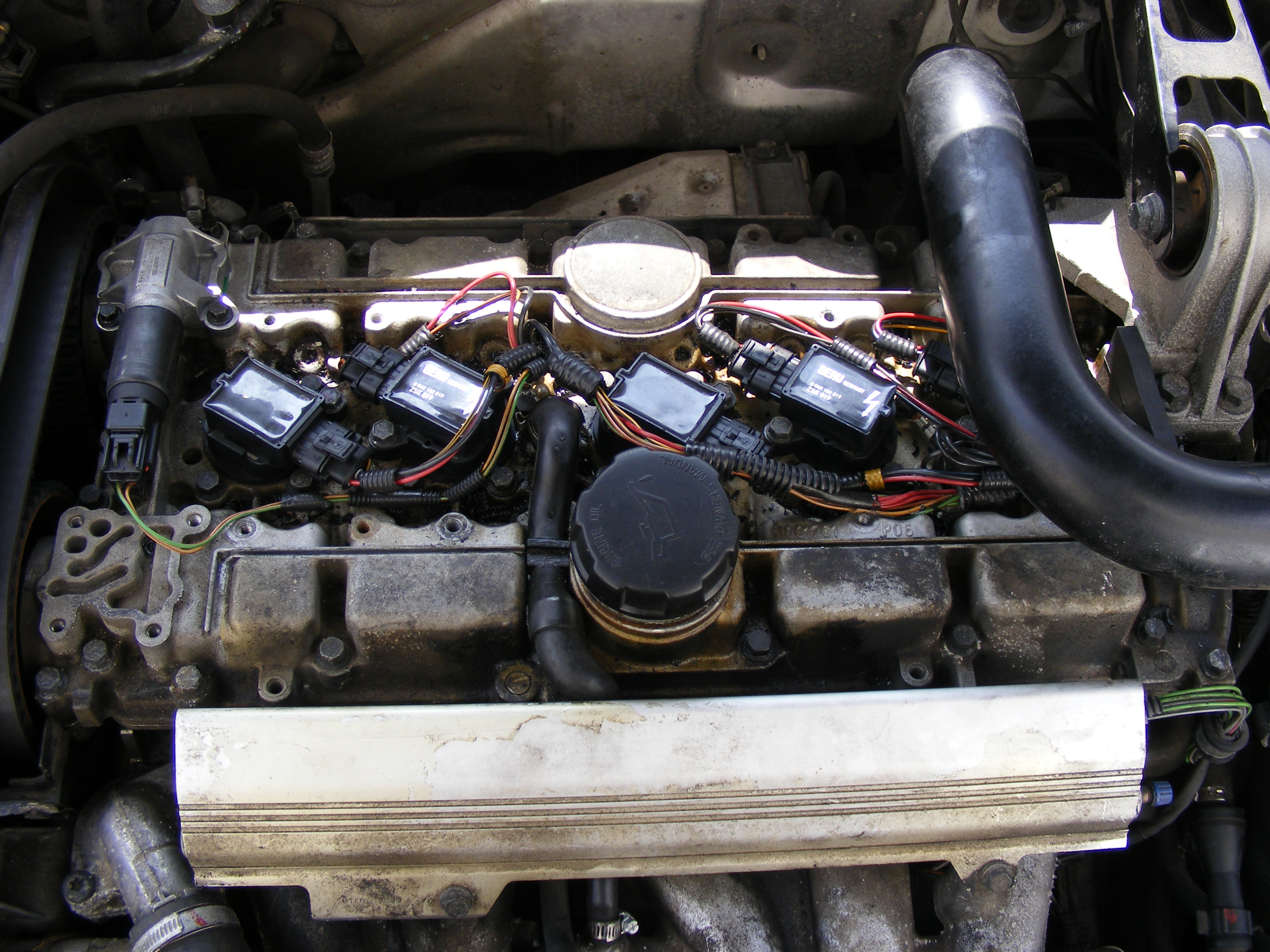

This is why I told you when new problems develop after new work, look and trace the steps. You damaged a few wirings during re-installation of the Plastic Cover.
It seems to me that you are a novice in car repair, so here are a few advices.
1. The Bolts from the Engine Plastic Cover squeezed a few wirings exactly where the bolts go!
- Red wire to coil #2 is squeezed!
- Brown wire (ground) is squeezed!
Fix them using new wiring and:
a. either soldering/shrinkable tubing (if you don't know what you are doing then get help from someone who knows.
b. Another option is using "butt" connectors.
2. In the other pic I posted above, make sure the wiring runs exactly like that pic to prevent being squeezed!
And again be careful when installing the Plastic Cover: all wirings need to be tucked down properly first!!!
Post a feedback if this fixes the problem!
Posts: 8360
Joined: 31 Mar 2010, 09:54
Year and Model: 2004 V70 2.5T
Location: Omaha NE
Been thanked: 504 times
Post by cn90 »
OK,
Now the more I think about this problem it makes perfect sense.
If you focus on the brown wire (yellow arrow on the R of the pic above), it was squished by the bolt during re-installation. This same brown wire feeds the Cam Position Sensor (CPS): follow it in the picture and you will see it runs into the CPS.
This is why you got the CPS error codes. And even after changing the CPS, nothing happens because the problem is in the wiring, not the CPS itself.
