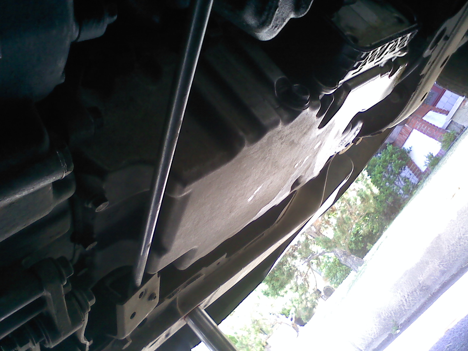

So I finally got to looking at the oil pan. It looks pretty straightforward with the exception of this one metal pipe in the way and a couple of the bolts near the oil filter which are hard to get to due to the sub-frame. I think a u-joint will easily fix that issue though.
The metal pipe I'm talking about it shown below. What is it? I've seen elsewhere that it's ok to unbolt the holder (bottom left) and bend it out of the way a bit?
So I'm nearly decided on doing it, just need to figure out that metal pipe and borrow some ramps. Seems to me that ramps are going to be the most sensible approach so I can have the whole area underneath to work with, not obstructed with a jack and stands.

ecbsykes wrote: The metal pipe I'm talking about it shown below. What is it? I've seen elsewhere that it's ok to unbolt the holder (bottom left) and bend it out of the way a bit?
Lower strut brace?

And I'm thinking that pipe is the fuel line maybe. It's only on one side, so I don't know about it being any sort of brace for the struts. It feels like a pipe that carries something.
