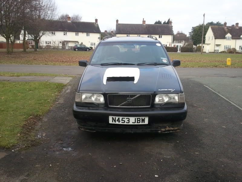

That sounds like a horrible idea. No offense. Regardless of "how" a wheel well is not a place for airflow. If you're going for a more "forced induction" on a turbo car, which in of itself can become extremely turbulent, scoop the hood on the drivers side. You can buy kits online, even pre-painted scoops that you can literally sawzall the hood and drop it in. As always, DURABLE heat shield. Sealing off from the engine entirely seems much better than spending all that time and money to plop in a $25 cone filter and some aluminum foil. People! How much heat is being introduced through the stock air box feed? 3mm plastic running past the exhaust manifold?!?!?!? C'mon. Either run some pipes or scoop the hood.

The "$25 cone filter" surrounded by "aluminum foil" is one of the best bang for the buck mods you can do to these cars. There is a good video on iPd where Lucky explains the advantages of this system. If you take a look at the Volvo 850/70's that have been well modified, 90% will have an SRI intake. I doubt you'll find many with hood scoops. Any reputable tuning company will tell you a SRI and 3" DP are the two biggest improvements you can and should do. And they are all that is necessary for the car to breathe plenty.

There's nothing wrong with a good hood scoop.

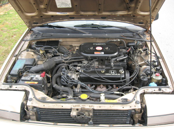

The wheel well thing is a valid question too. Look at this one - stock setup. You might have trouble doing it with the Volvo setup though, as there's lots of stuff under the battery tray/airbox location already. On a turbo car, it probably would make no difference over drawing in air through the front of the car; on a non-turbo, it might actually help.
