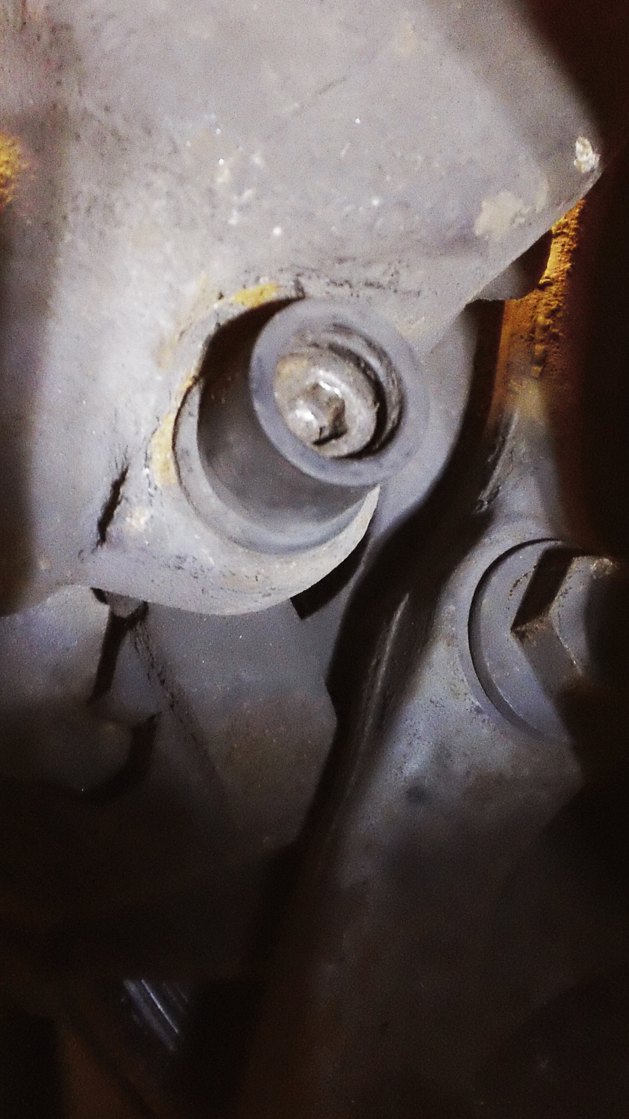

I have all four guide pins exposed, could I use Scantech caliper repair kit for replacement?
Or, is local O'reilly good enough?
