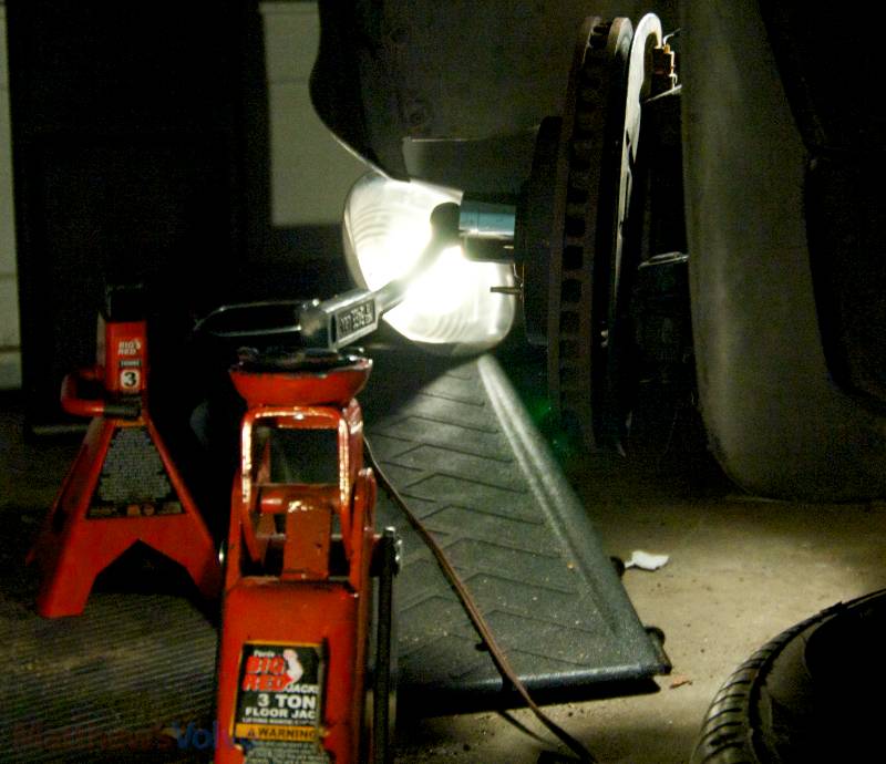

Man am I having a heck of a time getting off the 36mm nut

I sort of remember laying the pie/breaker bar on the ground then using the car itself to break the axle nut. I did have the bar on a heavy piece of wood. This was on a Subaru but axle nuts are axle nuts.

This is how I did it.
Pull the wheel and jam a screwdriver into the brake rotor fins so that it when the wheel rotates, it hits the caliper bracket. Then use a floor jack under the end of the breaker bar and PUMP IT UP.
Mine broke free in five seconds.

"Pull the wheel and jam a screwdriver into the brake rotor fins so that it when the wheel rotates, it hits the caliper bracket. Then use a floor jack under the end of the breaker bar and PUMP IT UP.
Mine broke free in five seconds."
Love this method, thanks for the tip will use it next time around.

I used a Makita electric 1/2 in impact gun on mine with great ease and success! There is also a hand impact socket designed for use with a breaker bar. While under pressure from the breaker bar you hit it with a big hammer. They work well also. I would stay away from Big Cheater Pipes if you like your tools. Get the right tool for the job. Safety First, Frustration Not! Best Regards, SpeedyPete

Went to a "Brakes Plus" today, informally paid the mechanic $10 to break it loose. Took him 3 seconds with a 3/4" air wrench. Then he torqued it back on to 160lb/ft. and I went home.
What an ordeal. Real tools = real time savings. I bought a large pipe that fits over the breaker bar today and a propane torch. Not that those are substitutes for real tools, but they would have saved me hours.
Matt, no stake, no pin. Just nut. I thought of that and reverse threading before all my toil. At least I got the "think first, act second" part right.
