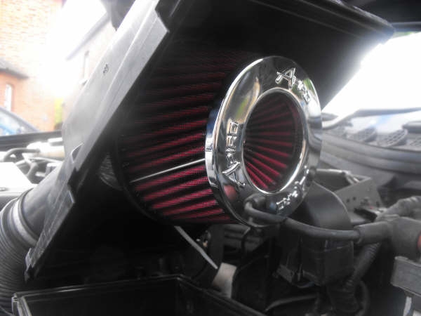

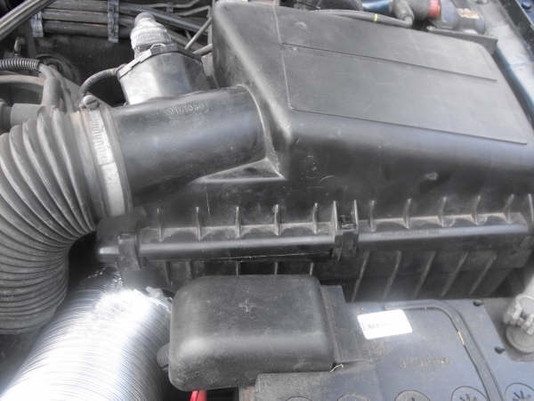

I've just preformed the following air filter mods:
- Replacing the old air intake hose for a much larger one
- Closed the hot air intake flap to only let in cold air
Also ordered a Ariro Performance Air Filter (cone shaped) but after a little research was advised that a may have trouble fitting because of the MAF Sensor. I came up with the following mod, please refer to pics.
Seems to work fine, only fitted a few hours ago so will see how it works on MPG & Preformance! Feedback welcome.
Chris.

Hi,
I've just modified the above slightly by opening up the front of the air box by an inch ......... wow what a difference in the sound! From 2000 RPM it starts to roar and then from 4500 RPM you hear the god of thunder!!
Chris.
Chris.

Hi,
I agree that if you are using a dyno machine the car will not show any increase in power if a cold air intake is fitted or not. This is because the bonnet is open when testing, but, when the bonnet is closed the engine bay is mostly filled with hot air.
The cold air intake is a device used when your moving to bring lower air temperature's into the car's internal-combustion engine, to increase engine efficiency & power. Cold air provides more oxygen for the engine to burn.
Chris.
Chris.
