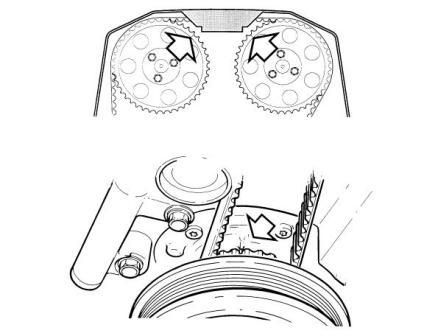

You are correct about the stock spec being 4-8 degrees BTDC at idle.
Looking at the where the timing marks should be at TDC based on the below image, it looks like retarded ignition - maybe 40+ degrees! If that is real then it would definitely explain the low power, almost to the point that it's amazing that it runs.
I don't know why the marks on the top of the cover would be in a different location unless there is another mark on the cam gear?

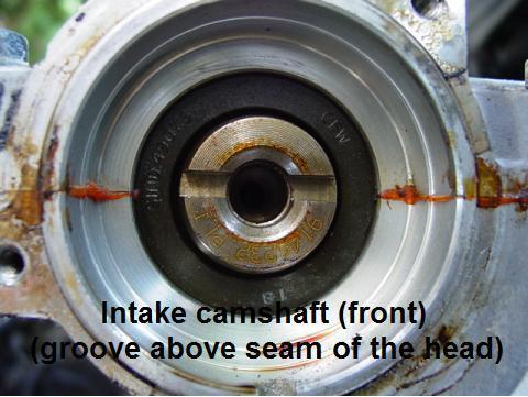

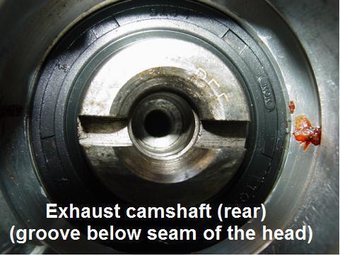

If those timing marks are correct and the camera took the photo at the precise moment the strobe light went off for cylinder 1 you should have valve to piston contact or close to it .
Somehow I don't think you'll resolve this until you see this:
- intake cam.JPG (35 KiB) Viewed 1187 times
- exhaust.JPG (34.68 KiB) Viewed 1187 times

The factory notches (as shown in the picture) are the only marks on the cam gear.northernlights wrote: I don't know why the marks on the top of the cover would be in a different location unless there is another mark on the cam gear?
precopster wrote:If those timing marks are correct and the camera took the photo at the precise moment the strobe light went off for cylinder 1 you should have valve to piston contact or close to it .
Another poster in this thread was off 3 teeth and didn't have any interference - I wonder how far off it actually has to be.
Anyway - Yes, I'm definitely checking the back of the cams. I didn't get eyes on the crankshaft mark yesterday, so I'll probably do that first.

If you look at the timing mark, and assume it should be in the notch of the cover (not where zero is marked) at TDC, then I think the timing is retarded. If the mark is counterclockwise of the zero point, then it is advanced, clockwise retarded.
If you were 40 degrees advanced then you would have a ton of low end power, until you encountered the near-certain severe detonation problem, and burped the rings off!
