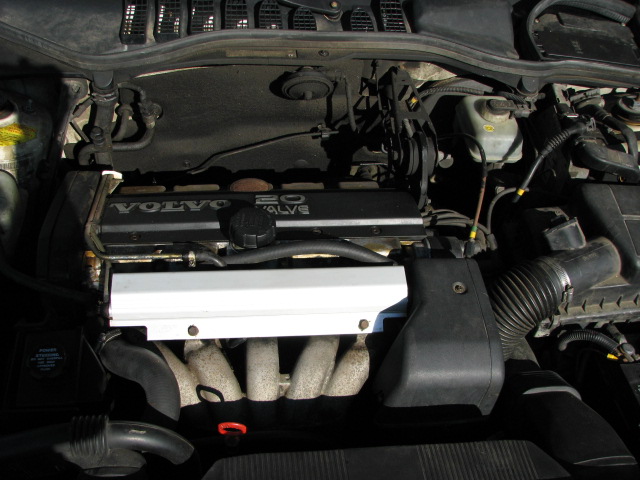

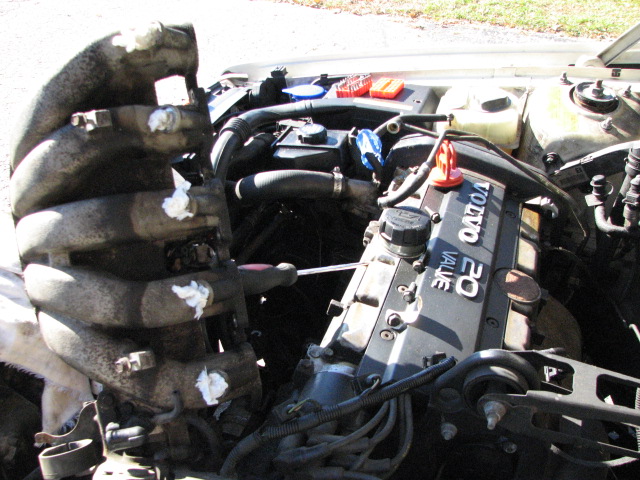

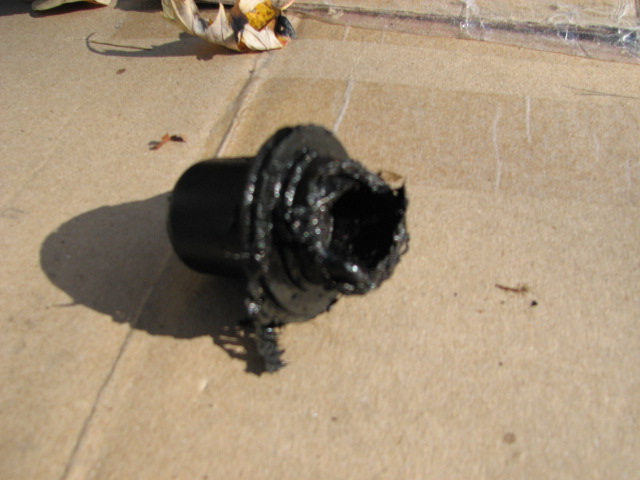

When I had taken ownership of my '93 n/a Sedan (no Turbo in '93), someone had already taken out the flame trap, (breaking the elbow and siliconed) but also had utilized a 3/4" fuel line to bypass the oil separator line.
First 850 PCV.
First 850 PCV.
Flametrap elbow.
Flametrap elbow.

I replaced the elbow with a new one from an FCP kit, discarded the "flame trap", cleaned out the block passages, and the '93 n/a is still running nicely after a year and a half.
While replacing the PCV system on my turbo wagon, I used 5/8" heater hose for the run to the intake, and 1/4" fuel line for the vacuum run to the PTC nipple.
