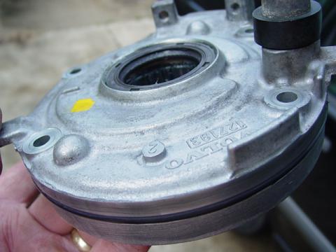

The Black O-ring, just make sure it is seated all around.
Then grease the edge during insertion, go SLOW to be sure it is not caught anywhere.
Check the BORE side (Engine Side) to be sure it is smooth.

Interesting ... this looks like a perfect fit.
The last one I received (not the one in the mail today) was larger and somewhat loose.
No wonder it sliced off.
Hopefully the one I receive today will be snug like this one.

The parts are in, and at first glance this looks much better.
The last time I ordered this set the box looked in bad shape, and I recall the O ring being larger than the gasket, as mentioned before. This time it looks about the same size, which makes me much happier now that I know what I'm looking at
unlike last time, having never even heard of an oil pump.
It's currently about 6 degrees so I don't know if I'll be able to convince myself to dig into it today, especially as I want to be super focused on not messing up.
One additional question : Someone had mentioned adding an extra green gasket to add thickness.
Should I do this ? Should I replace the gasket that is currently (oil soaked) in there ? It's not damaged.

Whose got 2 frozen thumbs and just successfully reassembled his engine without a leaking oil pump? This guy ! ... After working for 3 hours in the dark at -3°F/ -20°C it finally all came together... and now it's time for a drink.
I want to especially thank cn90.
Your patience, guidance and suggestions made for a much smoother repair than this has been the last few attempts.
I greased the O ring thoroughly to make sure it stayed in place and took multiple attempts and utmost care to very slowly place the oil pump. Used the bolts as guides, tightened them and tapped the pump back further, tightened them a bit, etc etc. I used tape to taper towards the square edge and it was amazing how easily the crankseal slid on. Slowly and carefully tapped the seal back. I probably took 3 to 4 times as long as I did the last few times, but it paid off. I was so relieved when it didn't start to drip. I kept rev-ing it up, waiting for it to happen, but so far it hasn't. I'll wait to reassemble the covers until tomorrow night, as it's starting to get too cold and late to continue. Also it'll give me a chance to check again tomorrow to make sure it's actually fixed before reassembling.
