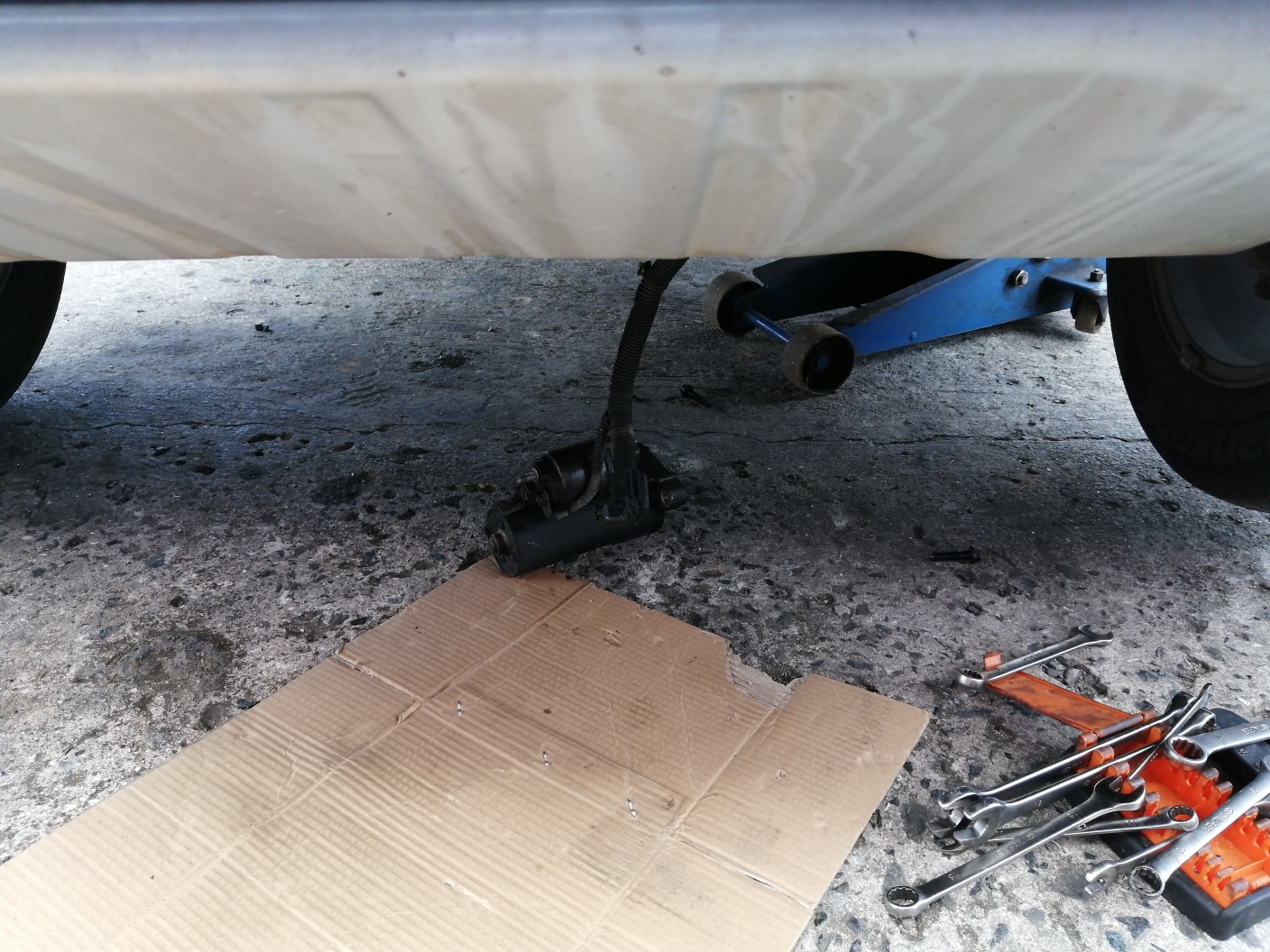

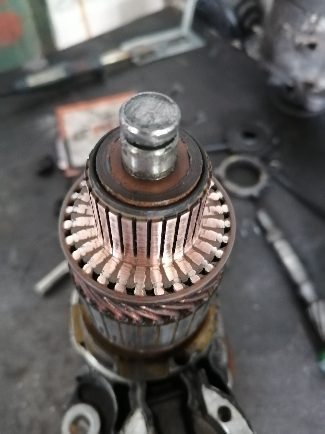

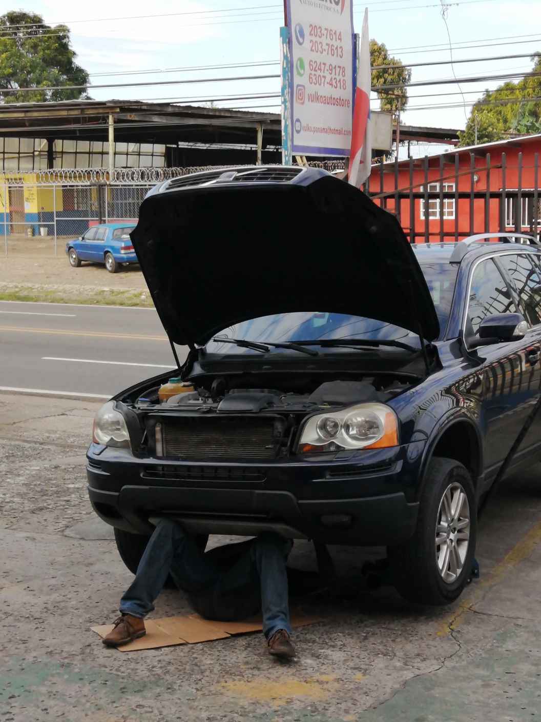

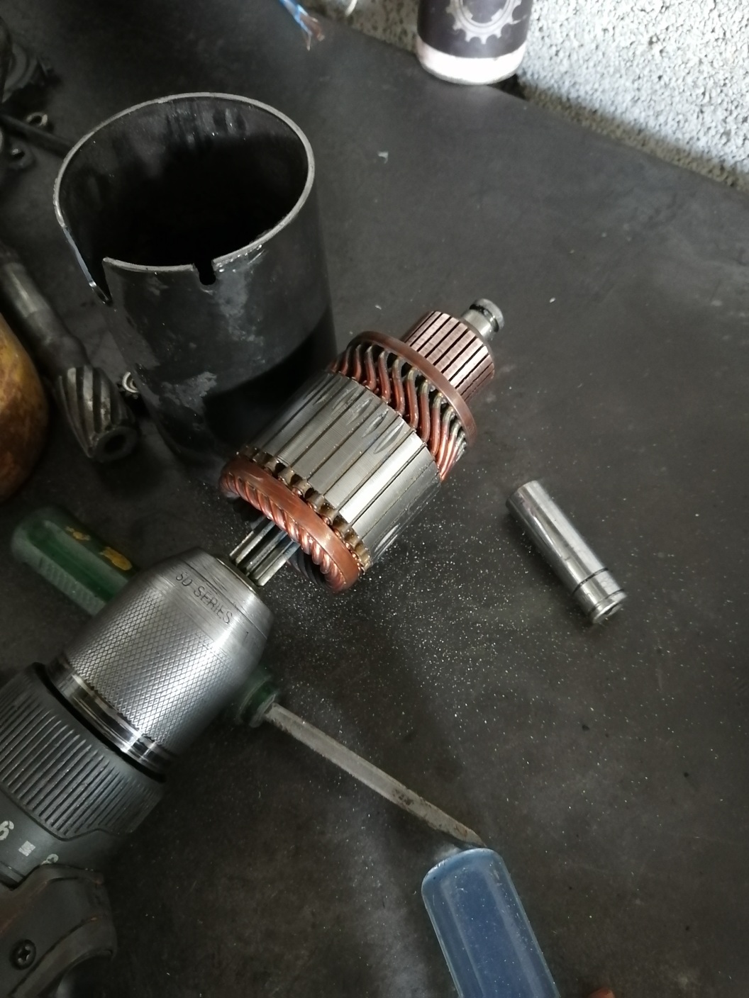

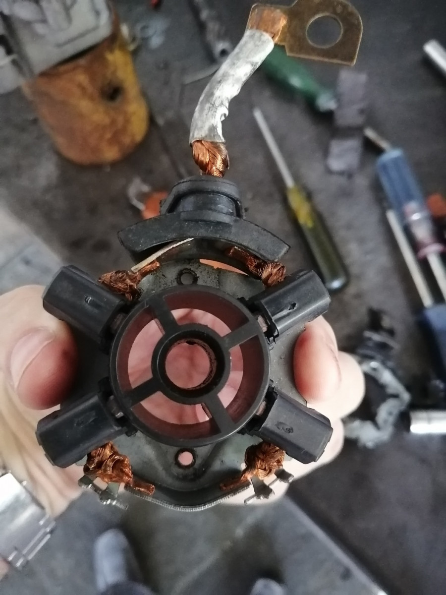

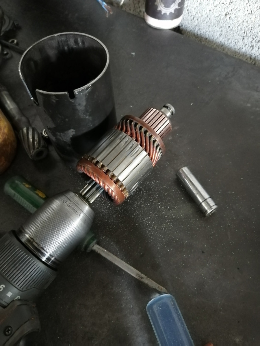

Hey Guys,
I use to have the same Slow Crank problem but then it got worse so I decide to fix it.
In my case, it was the Brush plate.
Taking out the starter motor, installing new brush plate and then put back the starter motor cost me US $ 75.00
I have an 2008 XC90 3.2 AWD. Removing the starter motor was a piece of cake. The guy remove it in less than 10 minutes.
Here some pics
Rgds
