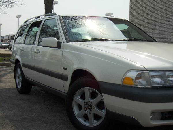

I have just purchased one of the headaches you do not need anymore it would seem.
That year, these cars are non-stop monitoring.
There is a '99 V70 AWD I have been taking apart at the yard that I frequent.
Now that I own an AWD, I may drop the complete rear end and drive assembly out of it, and add it to my hoarding issues at my storage, for sake of the price otherwise.
I am a glutton for punishment though I was told.
That would be it. Not for everyone though.
