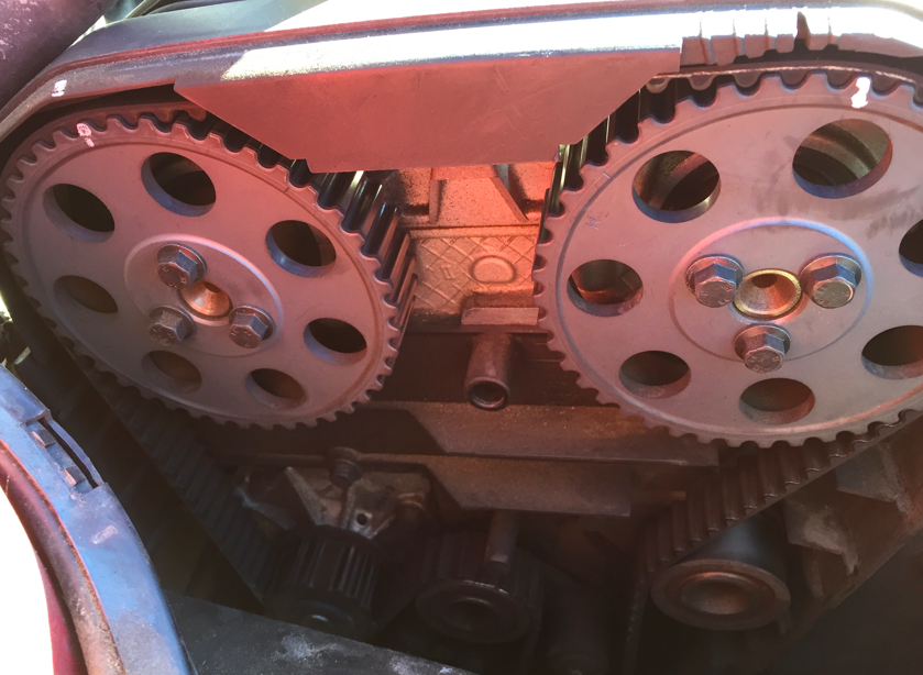

First is the timing marks. I was all worried that mine would be hard to find, but as it turns out it was super easy. In fact it appears that my timing belt must have been serviced before (although I don't recall).
Here's my timing marks. Not only are the factory marks clear at 1 o'clock (left) and 11 o'clock (right), but it looks like someone painted the white marks on the cover and the cam gears.

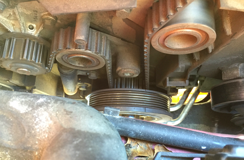

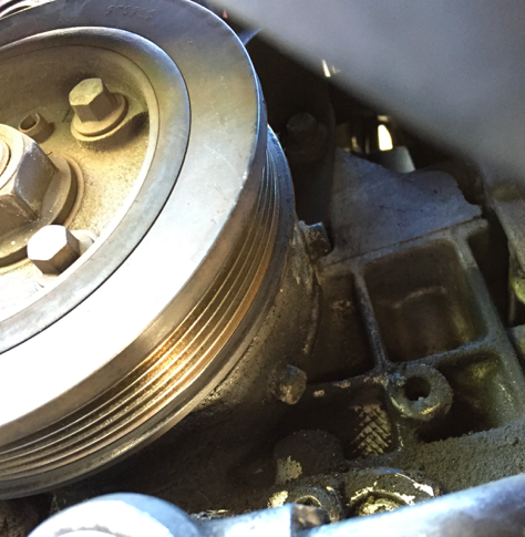

Down below on the crank, I had two very clear keys as well. First the crank pulley mark lines up with the belt when the upper marks are aligned.

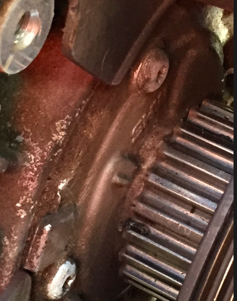

Then if you look in the engine block, you can see the cast arrow that points to the valley between the two notched teeth on the gear itself. Mine was pretty clear so I grabbed this snapshot to share.

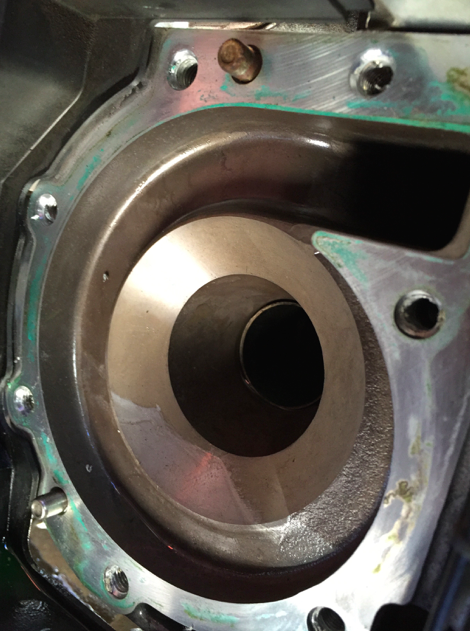

Finally, there's the water pump. I read all kinds of tricks of getting the gasket to stick in pace with some sealant when re-installing the pump. Mine was much easier than that. There's 2 locator pins on the engine block. I just used these to hang the new gasket then placed the pump on top of it. It was really simple.

I use some hand-made plastic sharp tool to scrape the old water pump gasket residue from the mating surface on the block and just a trace amount of grease on the new gasket. The locating dowels will help the gasket stay put, and the lubricant helps it seat better. Just take my time and torque the seven mounting screws gently and slowly (in two or three increments). I also check the final torque once again just before tensioning the new belt, and then re-fill with new coolant. Never had a leak.

ATTENTION: Water pump torque values in information MAY be incorrect. I followed this instruction to the letter torquing the water pump bolts up to 20Nm when the threads in my engine block gave way.
Supposedly the value is 17Nm and the aluminum block is very sensitive. Please verify and correct information in original post to avoid anyone else ending up where I am at now!
