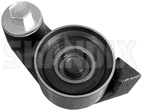

I may have found the cause of the whining.
My engine number is 127xxxx and i searched online for the timing belt parts and found that there are 2 different tensioner rollers, tensioner and idler pulley for different engine numbers.
What i have found is that with my engine number the tensioner roller should be this one:
http://media.skandix.de/pimg/1002704.jpg
The tensioner roller that is installed os this one:
http://media.skandix.de/pimg/1002705.jpg
The first is for engines up to number 131xxxx. The last is for engines after 131xxxx. The are different on the contact point of the tensioner piston being the last one taller and putting more tension on the timing belt.
Also the idler pulley are different following the engine number. One has the pulley on center, other has the pulley off center.
You guys should already know this but my question is if using different parts according to engine number can result in this over tension on the belt causing the whine.

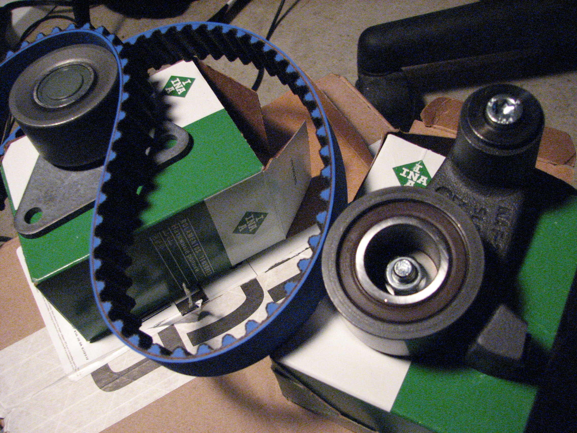

The first pulley is for the '93-'94.5, 21mm 143 tooth belt.
The second is for the '94.5- ... 23mm 148 tooth belt.
Incidentally, my '93 has the latter as an upgrade with a gates blue belt. ( My '96 Turbo Wagon as well now.) You do not have to use the old style, 50,000 mile belt. The newer pulleys and tensioner utilize the same bolt holes, and the gears are the same.
This belt makes a comforting whine. It is a Kevlar infused composition and sounds a bit like a supercharger when you first install it. (Blower whine.) It is not very noticeable after a couple thousand miles, but I can still hear it sometimes with my windows open. It sounds good to me.
