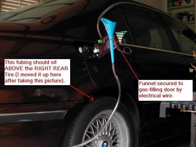

Create an elevated funnel from the 60 ml syringe body with an extended hard tubing, then just fill using gravity...as follows..simple.
Once you have used the small syringe with tygon flex tubing (1 foot) plus a 2 foot tube length of stiff plastic tubing to remove the oil from the rear diff or Haldex, there is an easy way to fill the reservoirs with the 650 mls or so of fresh oil. Simply lengthen the stiff tubing to 5 to 6 foot length (Ace Hardware for $0.36/foot). Then thread it back in as follows:
Zip-tie the syringe portion of the assembly (now without the piston) to a short ladder or the back of a tall outdoor chair. The syringe should face down. Thread the stiff tubing through the left rear wheel well directly along a descending path and just into the open fill port (rear diff port OR Haldex port). Zip tie the tubing so that it cannot shift around. The end of the tube should be threaded so it's just inside of the fill port. You now have the equivalent of an elevated funnel. The syringe has markings. Fill it in 50 ml increments and watch it empty itself into the Rear Diff or Haldex oil ports. Continue with 50 ml increments until the rear diff or Haldex overflows. Insert the plug with crush washer. Tighten to torque specs and you're done. This is so much easier than trying to syringe in the fresh oil. FYI. I tried to siphon out the oil using this method but by lowering the level of the syringe but the flow was too slow.
