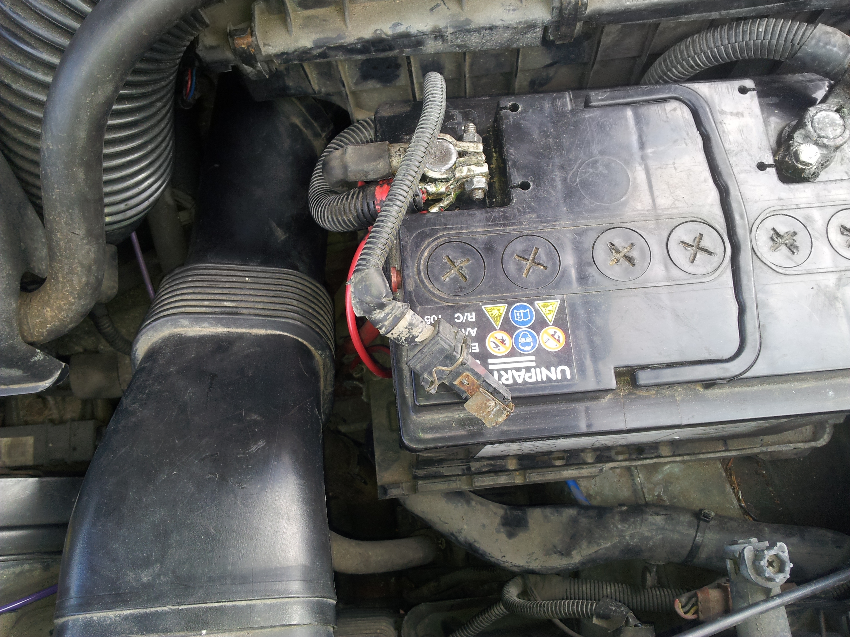

Thanks guys I agree its electrical checked connections and they seem fine also feel its something to do with the temp as the video on the previous page is identical to what my car does when it doesnt start. .I am reluctant to change the ect as it didnt help him. He says he found a lose wire to one of the relays above the radiator. Mine all seem fine but would like to know what relay it is as I would just replace that. I dont want to replace all of them as that seems silly also I found a disconnected wire below the battery but I cant seem to find where it goes.

It's and aditional wire for some device.It's not factory wire.
