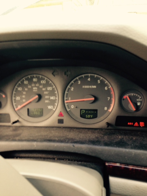

Now everything is back the way it should be and I was still able to start it. However, it idles at approx. 500 rpm and when I give it gas it has a delayed reaction and once it reaches 700 rpm it dies. I'm not aware of changing anything that it all of sudden started up with everything installed. I do not get any trouble codes, but the hazard light and the ABS light stays on.
