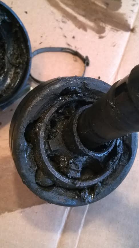

It's been a little while, so I figured I might post an update and share a little information that might be interesting for folks. As part of the cv repair I decided to compare the cv joint pulled from my car (with the busted boot) to a used cv joint from a salvaged car with over 100K miles (purchased from ebay).
....boy was I surprised.
When I opened up the ebay joint, grease was everywhere, it looked a little worn, but it wiped clean super fast. Like Eric the car guy says...."if your cleaning it more than 5 minutes, your playing with it."
Now with the busted joint, it was night and day. The grease was stiff and goopy. It clearly had tons of dirt and metal shavings in it. The stiff grease made hand rotating the joint a little tough (later I would have to use a hammer to rotate the joint to get the ball bearings out).

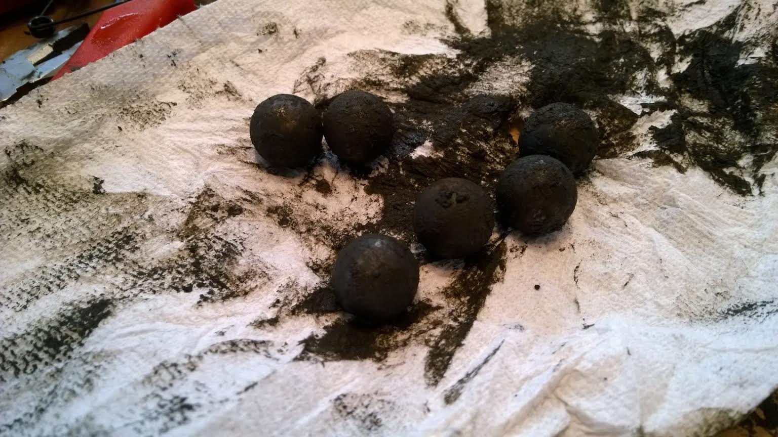

With a bit of patience, I was finally able to remove all the inner parts. Nothing cleaned easily like with the ebay joint. Here are the ball bearing after rolling them around on a paper towel.

You can see the ball bearing from the busted cv are pretty messed up. They look cratered like the moon in some places. In other places they look like someone hit them what a hammer.

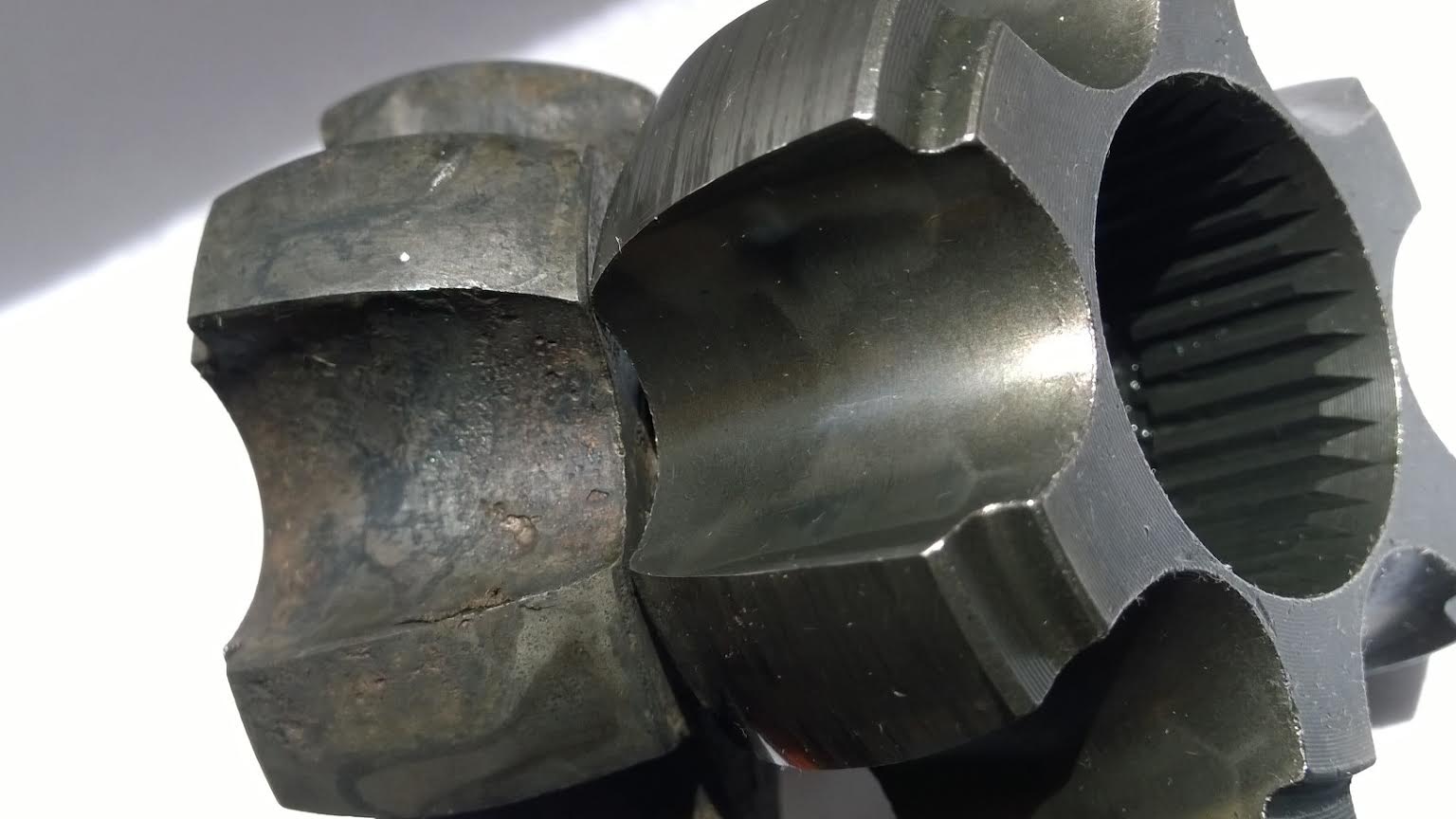

The races look pretty bad in comparison. Scaling, and cracking.

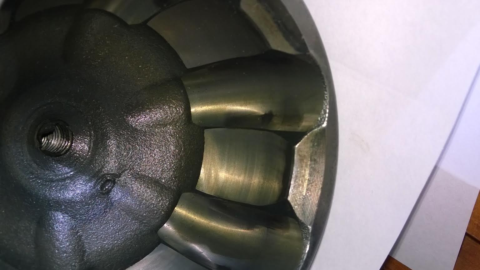

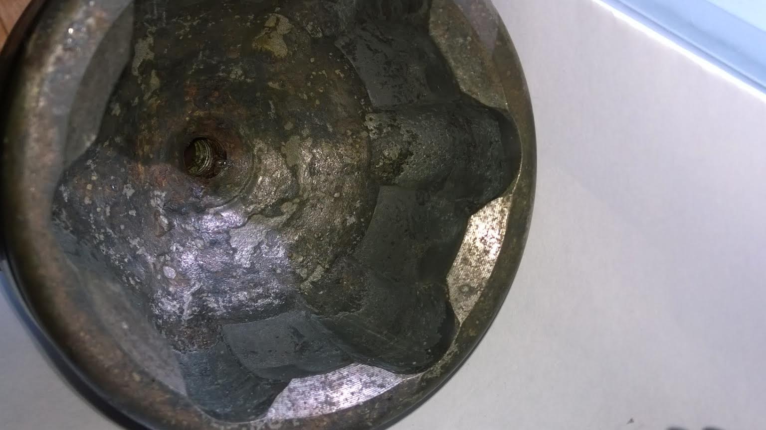

For me the coup de grace appears with the cv joint housing. It's night and day here. The busted joint make the ebay joing with over 100K miles look like it's brand new!

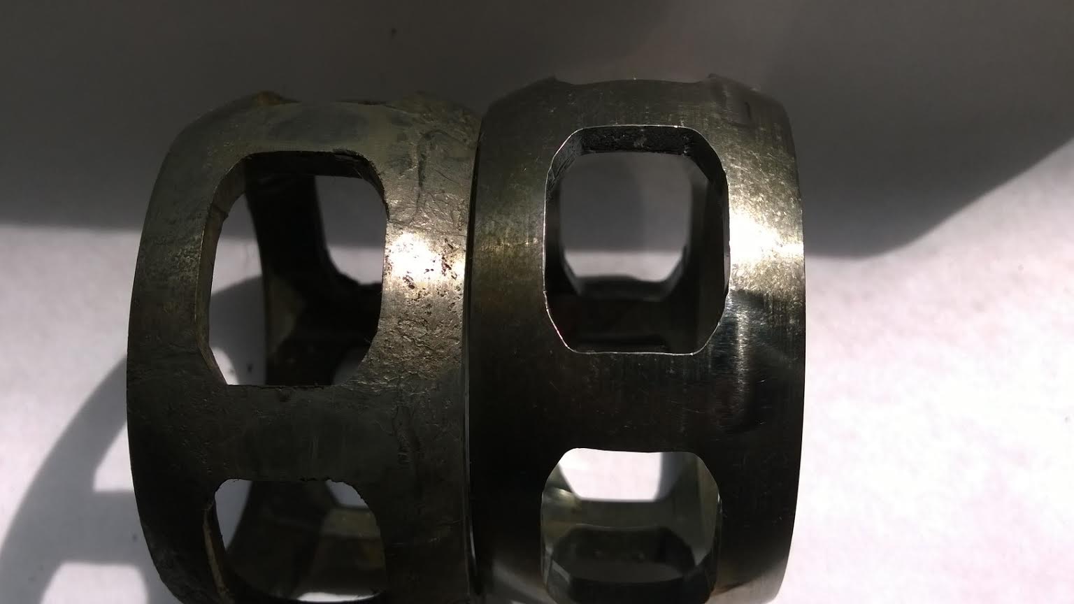

So, yeah it's probably possible to rebuild a rattling cv joint, but I now understand why it's not really worth it. The pitting and scaling will always be there. And no amount of new grease will ever stop the noise.

I'm not sure how important the cages are...but its more of the same.
