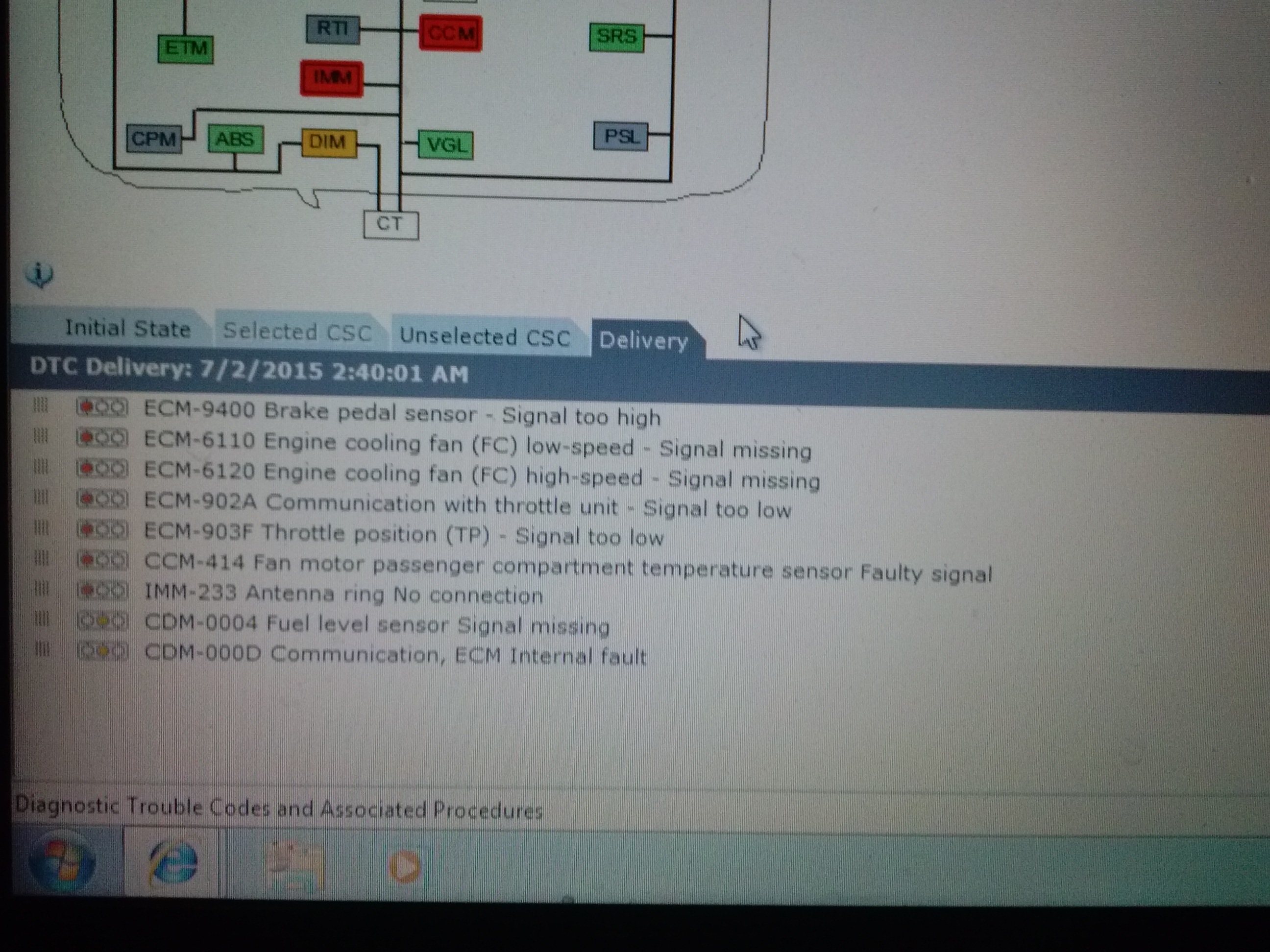

I did tinker with the patch file installing it again and it worked. Dice was able to communicate and now I'm starting chapter 2 which is tracking down every code I got. Im attaching a picture I snapped real quick

Getting VIDA/DICE up and running always feels like a tremendous success - until you realize that now you are at the beginning of the process of figuring out what is wrong with the car.
When you have a bunch of codes like that I typically note what the original scan said and then clear them all with the customer delivery button and see what comes back. That helps to eliminate superfluous things that just waste your time.

Brake pedal sensor on booster needs repair (on slim board) and throttle is a goner.

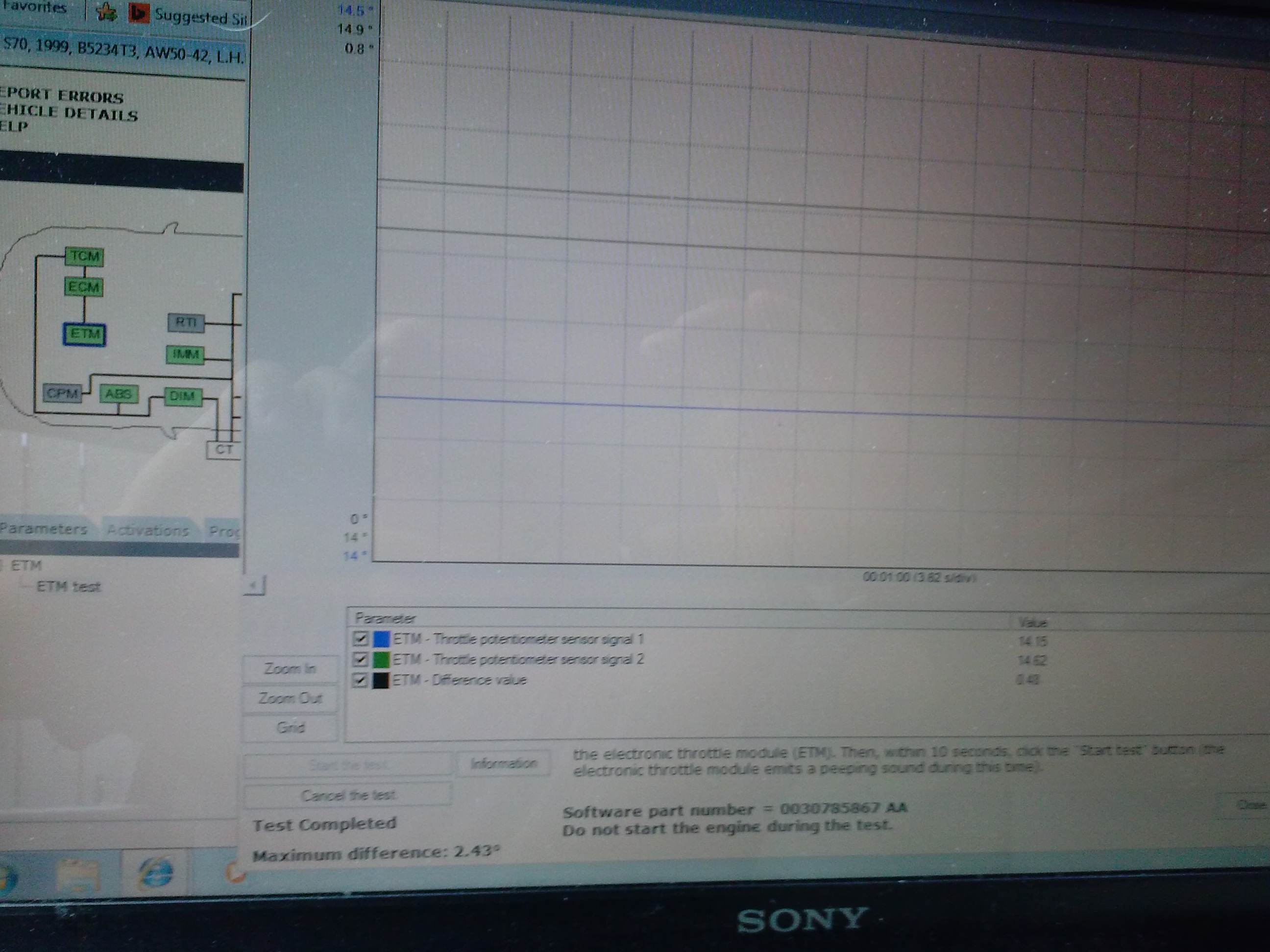

Lee,
I was messing with Vida again today and performed an ETM test, not sure what to look for as I'm still new to this but snapped a picture of the result.
I also tried to clear the codes but they still remain the same so I'm assuming my headaches will grow day by day

I think the symptoms of BPPS are an ETS light & if you press brake and accelerate at the same time the throttle won't respond.
Those codes on the throttle are permanent errrors which a DIY contactless conversion won't correct..
Now that you have a Dice read off the Network numbers (the 2 bottom software numbers) on the ETM and get any old junkyard ETM. With Henry's (doublebug MVS user) help you can rewrite any ETM to those numbers.

Today I received the ETM and gave it a try and this is what happened:Ozark Lee wrote:It can't really hurt anything to try.RigsPGT wrote:Seller had no idea if this came from a turbo car or not but my curiosity tells me to plug it and test it
...Lee
The butterfly stays cracked open about 15 degrees or soo when the key hasn't been inserted or even it being unplugged for that matter. Anyway, once the key is in position II, the ETM clicks (butterfly closes) followed by a few seconds of a high pitch whine and lastly you hear a click(butterfly opens) and that's it.
Did I just hit the lottery with this ETM?
There's no more whining after the second click so I'm thinking it won't need programming. The only thing that bothers me is the positioning of the butterfly before the clicks. Is it supposed to stay open like that?

The fact that it went through the self test would indicate that the software is a match. You can pull the software version with VIDA to confirm that it matches your original.
