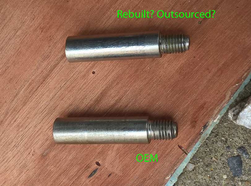

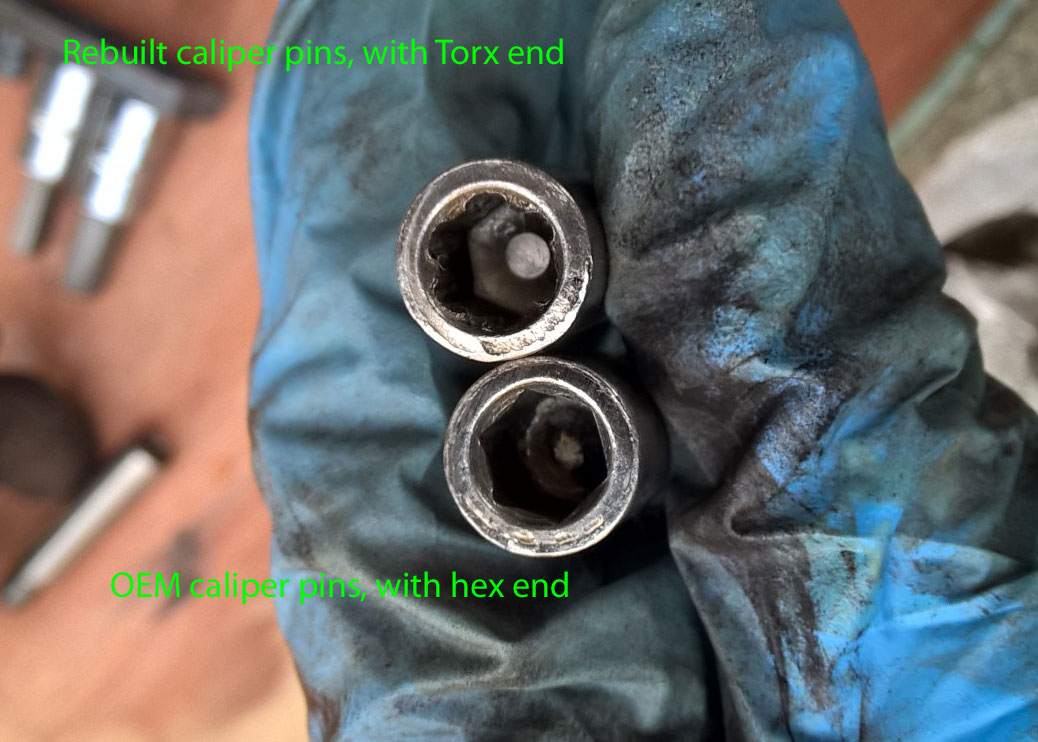

Meant to upload these a while back. I stuck with the OEM pins because the hex heads seemed to be in better shape than the torx heads. Here they are side-by-side. I didn't notice any real difference in their weight. They were exactly the same length too. I just felt too much play in the Torx heads to warrant keeping them, whereas the hex heads still felt great. These were out of remanufactured Cardone calipers.

If you search the part number, you will find that the pin quality of the rebuilds basically is sub par. My S70 lockedup both calipersdue to corroded aftermarket pins, which are poor quality stainless steel
One of the reasons the rebuilds are so cheap are the cheap pins.
Save your OEM pins
Compare the rebuilt caliper price after adding in real pins to the Volvo caliper, not the pin to caliper price.
Save your OEM pins

Important note - as you follow these threads, back in 2014, the rebuilders used good pins. In the never ending chase to the lowest price, at some point, they started using cheap crappy magnetic steel which corrodes and also has lousy six point hardware fittings - if you compare chinesium to OEM you can see the difference in workmanship.
I have no desire to spend an afternoon drilling out (a) stripped caliper pin(s)
The junky pins can be cleaned up and heavily lubed and will work, just add them to your annual inspection list (and even cheapskate me will replace them with the real thing rather than remove my calipers every year.)

OEM pins might be Torx as well, so don't immediately toss them. In April 2014, I had a Volvo dealership install front right caliper part 8111102. This is a rebuilt caliper. I assume it came with new pins which they used. While working on it last night, I noticed that the hex socket corners were rounded, though not as much as the one theWIFES_S70 posted. I used a Torx T45 bit to remove them.
Regarding the debate to lube the pins or not, my pins had barely any grease on them. They slid smoothly yet firmly out of the caliper boots. I will only use a tiny amount of Sil-Glyde on them in the future.
