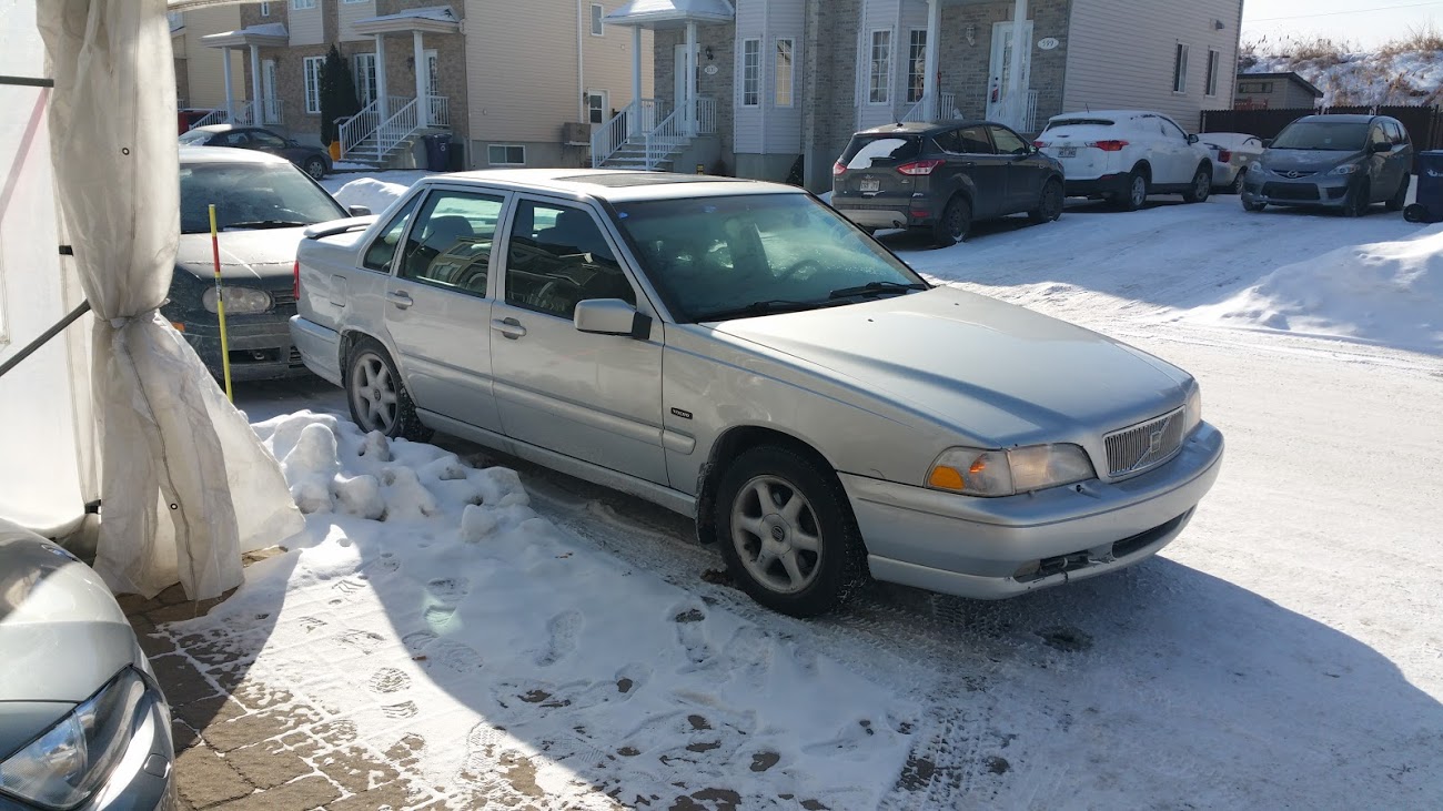

Today I didn't have time to do much on the car. First I took her to the exhaust shop... And that's when I found out the gas filter was leaking. So back at the garage I got a new bosch gas filter in there. I also got to change a lot of bulbs on the back and also found out that the tail light(trunk) on the passenger side was cracked and had water inside. It corroded the plug and the whole assembly so I swapped that out, luckly my mechanic had one laying around. Now I just have to change the cables over to the new plug that I also got. Will do this later tonight.
Is it possible to manually change the position of where the air comes out of until I can figure out how to fix it or possibly get the parts ? I won't be able to get to the garage until Monday. Would be nice for it to have fixed(temporarily) for the week-end. ( no I don't want to drive the damn golf )
Is it hard to swap the leather off the seats instead of changing the whole seat ?
Does the SC 816 actually sound better than the one I have now if I keep the stock speakers ? Will I be able to continue to use the CD changer if I get that one ?

Short of manually positioning the dampers by removing the dash I don't think you can get your AC into defrost mode easily unless it has manual climate control. That uses cables to move the dampers, not motors
I took it out yesterday, I do have the manual one. It doesn't use a cable. It only has electrical connection at the back. Can someone let me know where exactly the flaps for this are so that I can move it manually ?abscate wrote:Short of manually positioning the dampers by removing the dash I don't think you can get your AC into defrost mode easily unless it has manual climate control. That uses cables to move the dampers, not motors
Today I finally had the time to clean the car. I couldn't believe what I found. I think the guy didn't vacuum the car in years. Took me like 3 hours to clean the inside and the trunk. Get this. I was shooting the drivers side floor mat with a 2000psi pressure washer and it took me like 10 minutes of constant shooting to finally get rid of all the nasty mud salt and you name it that was inside it.
