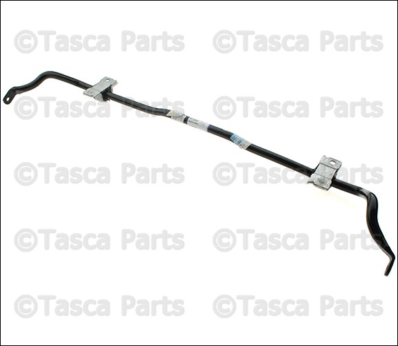

Just to recap:
Volvo OEM Stabilizer Bar
Approx $139 at http://www.tascaparts.com/volvo/s70/917 ... ilizer-bar
***VULKANIZED rubber!
IPD Super Duper Stabilizer Bar
Approx $429 at https://www.ipdusa.com/products/4873/10 ... kit-850-70
***Comes with bushings that need to be lubed ever 25k or so and a rear stabilizer bar.

Because the vlucanized, factory sway bar bushings last about 20 years. At $140, the cost difference of a new bar is not that great. Or just put in a used one, that will be like $30 and last a good long time. I've not yet had a car with failed sway bar bushings.misha wrote:Hmmmm...and why would you want to buy the whole thing if you can buy just bushings?
It's potentially a good idea (will the brackets and bushings really fit over the ends of the sway bar? maybe!) but you're forgetting the key point stated by several here including yourself: the factory bushings are vulcanized to the bar. So in order to get the original ones off you must drop the subframe, pull the bar, and hack them off somehow. Then you are ready to go aftermarket on the bushings.cn90 wrote:On the issue of dropping the subframe, I don't think people have to do that if one uses aftermarket.
1. Use a dremel to cut off the top of the U-shape bracket.
2. Undo the bolts, then slide the old bracket out.
3. Insert new bushing and bracket via open end of the stabilizer bar (undo the endlinks first).
