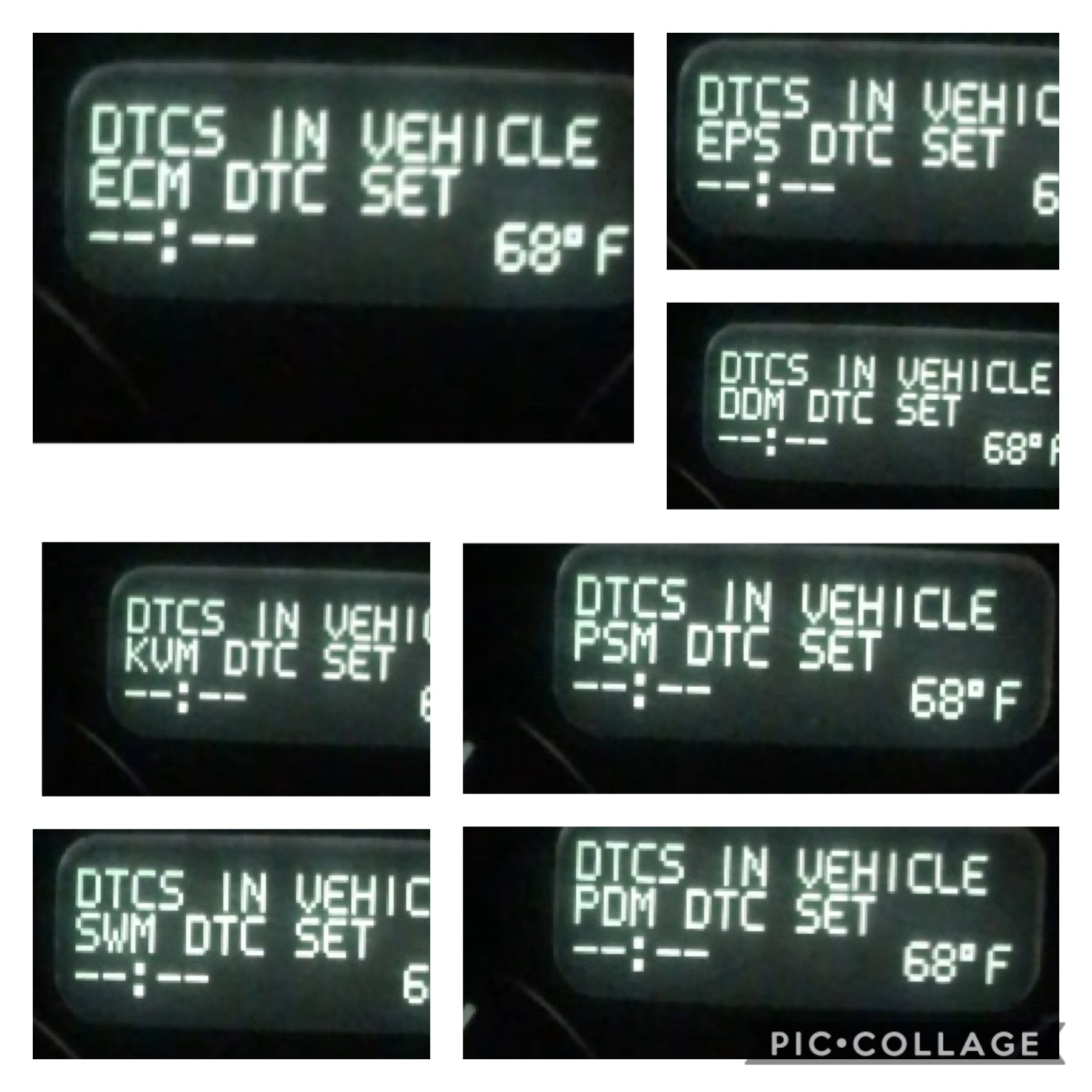

Post by AKellner »
Mine started out as a transient issue, as well. Now, the car can't even be called drivable. I'm still waiting on a dice scanner but these are the modules reporting errors in the onboard diagnostics.

Post by RazieL »
In your case, looks like its a different generation than mine. I also have a 2005 v50 - display looks exactly like yours. These ones are notorious for oxidation issues in the ECM/ECU -whatever the unit in the passenger foot-well is called. Just pull back the carpets, unplug everything (carefully and after disconnecting the battery) and use some electrical contacts cleaner, depending on your location you should find some pressurized/canned air and maybe even open up the unit and use some cleaning spray for electronics.
