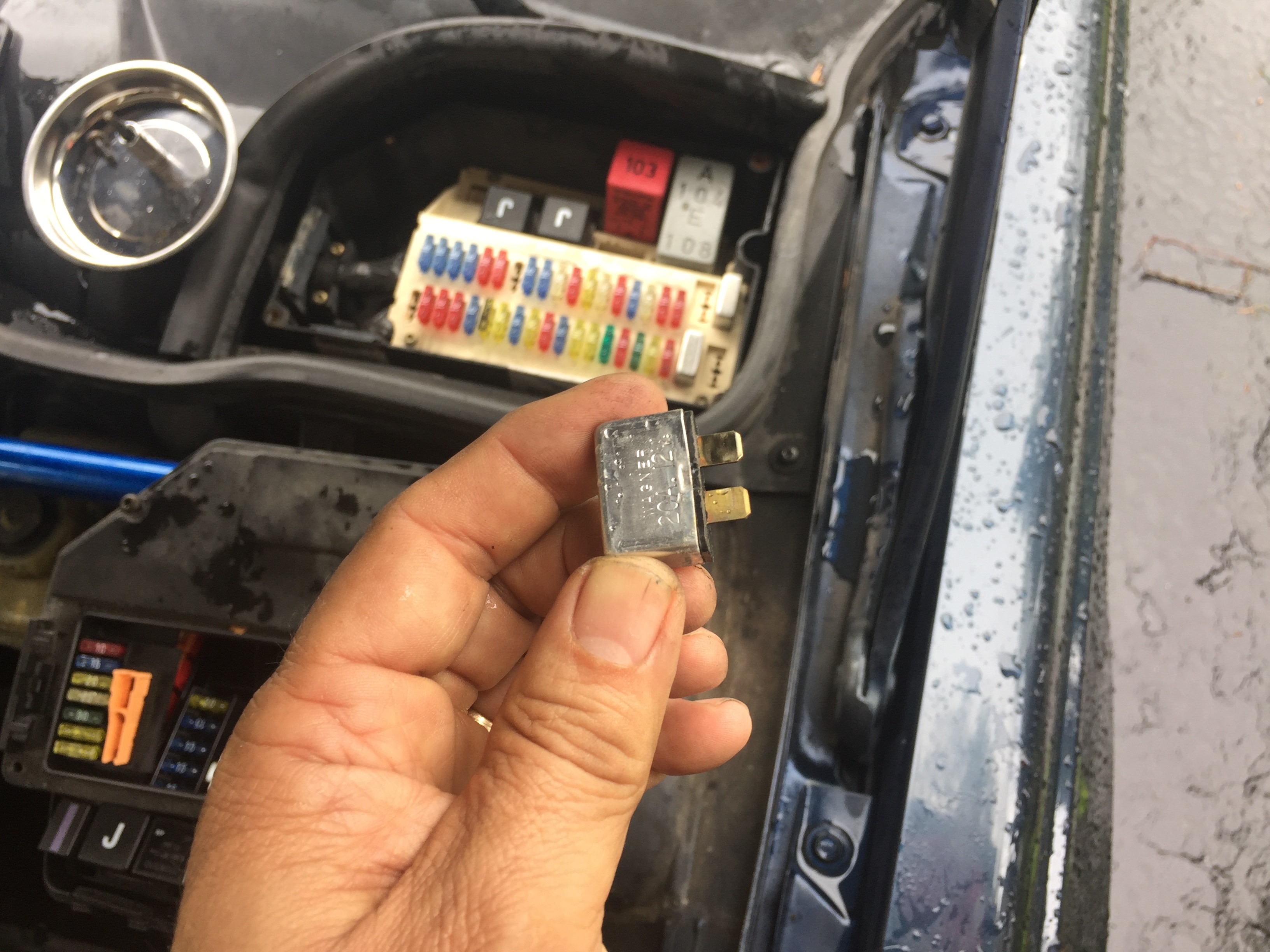

Oh, and we found it might not be a bad idea to check both the starter and main relays as age appears to be taking its toll.

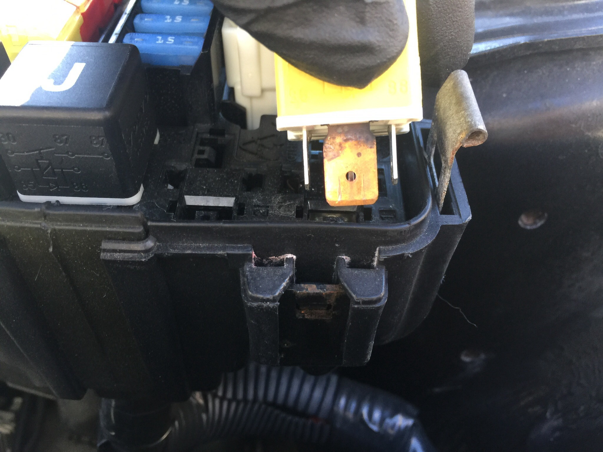

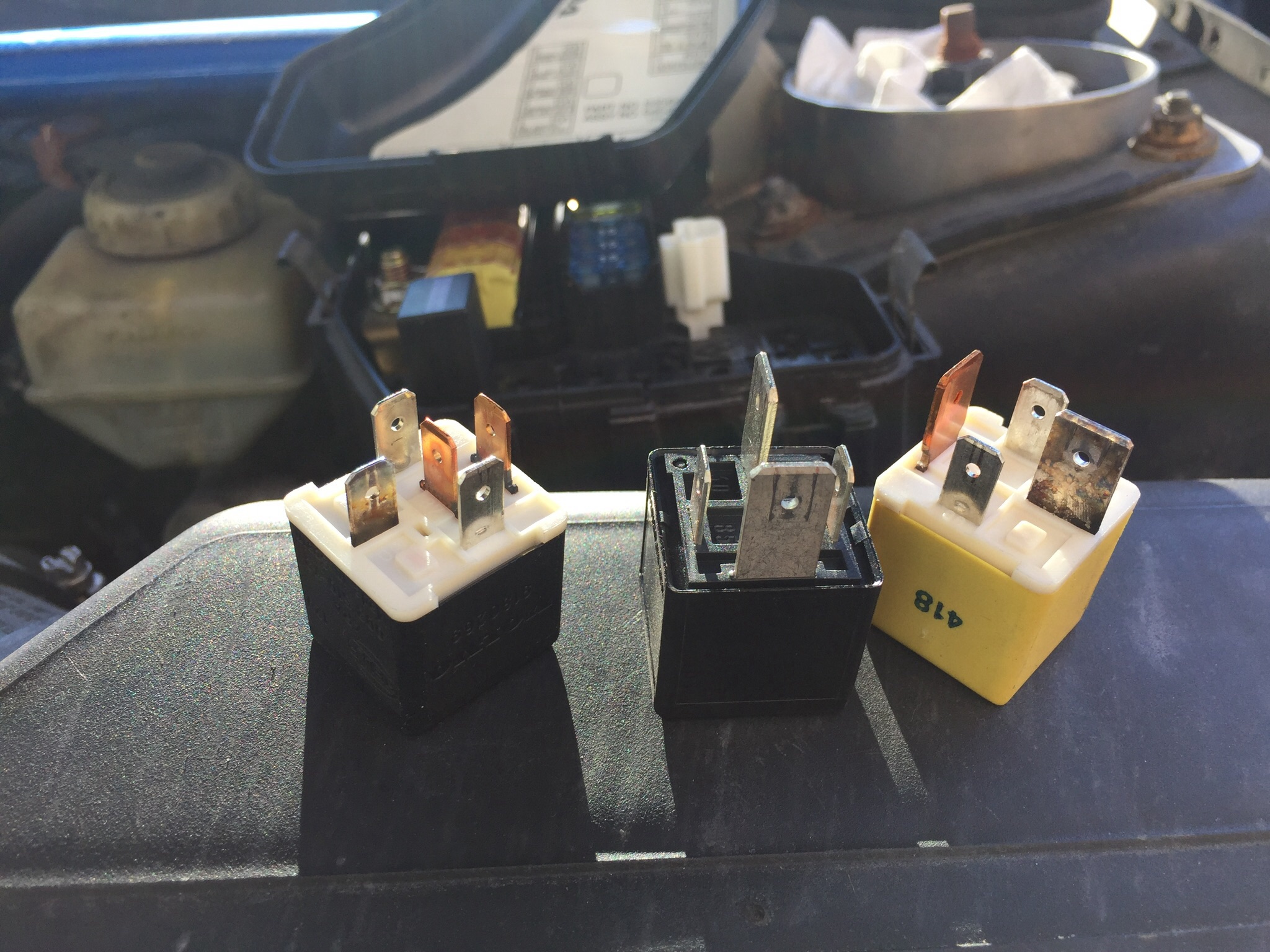

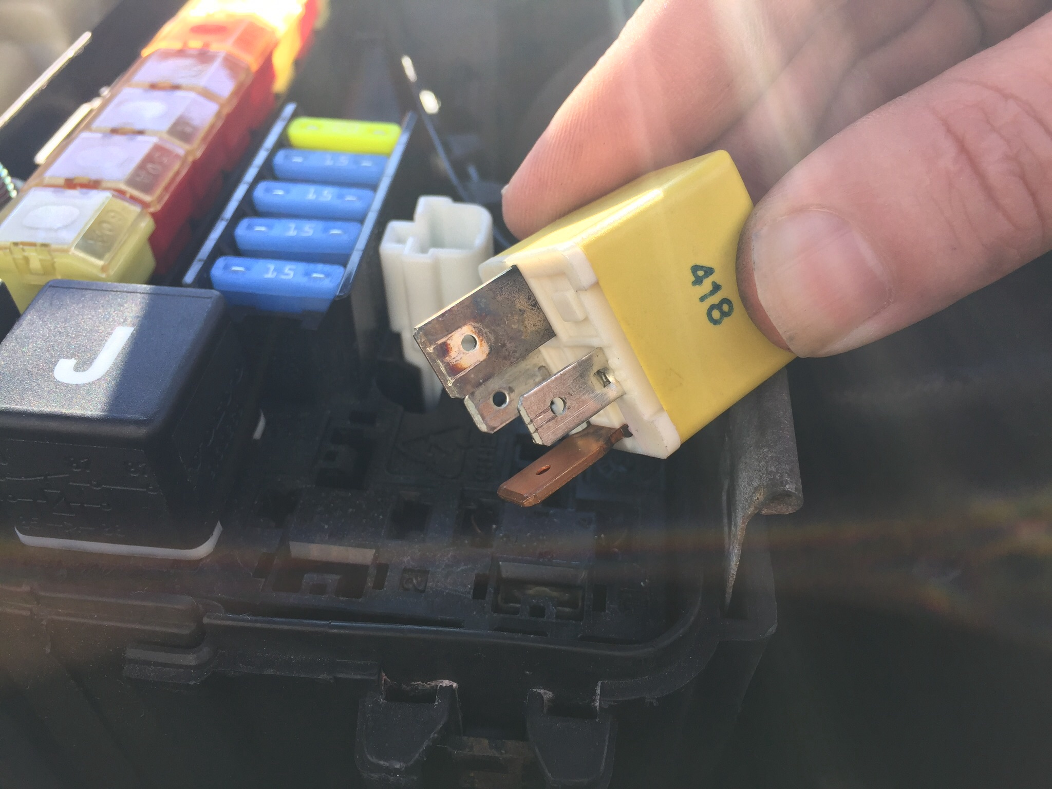

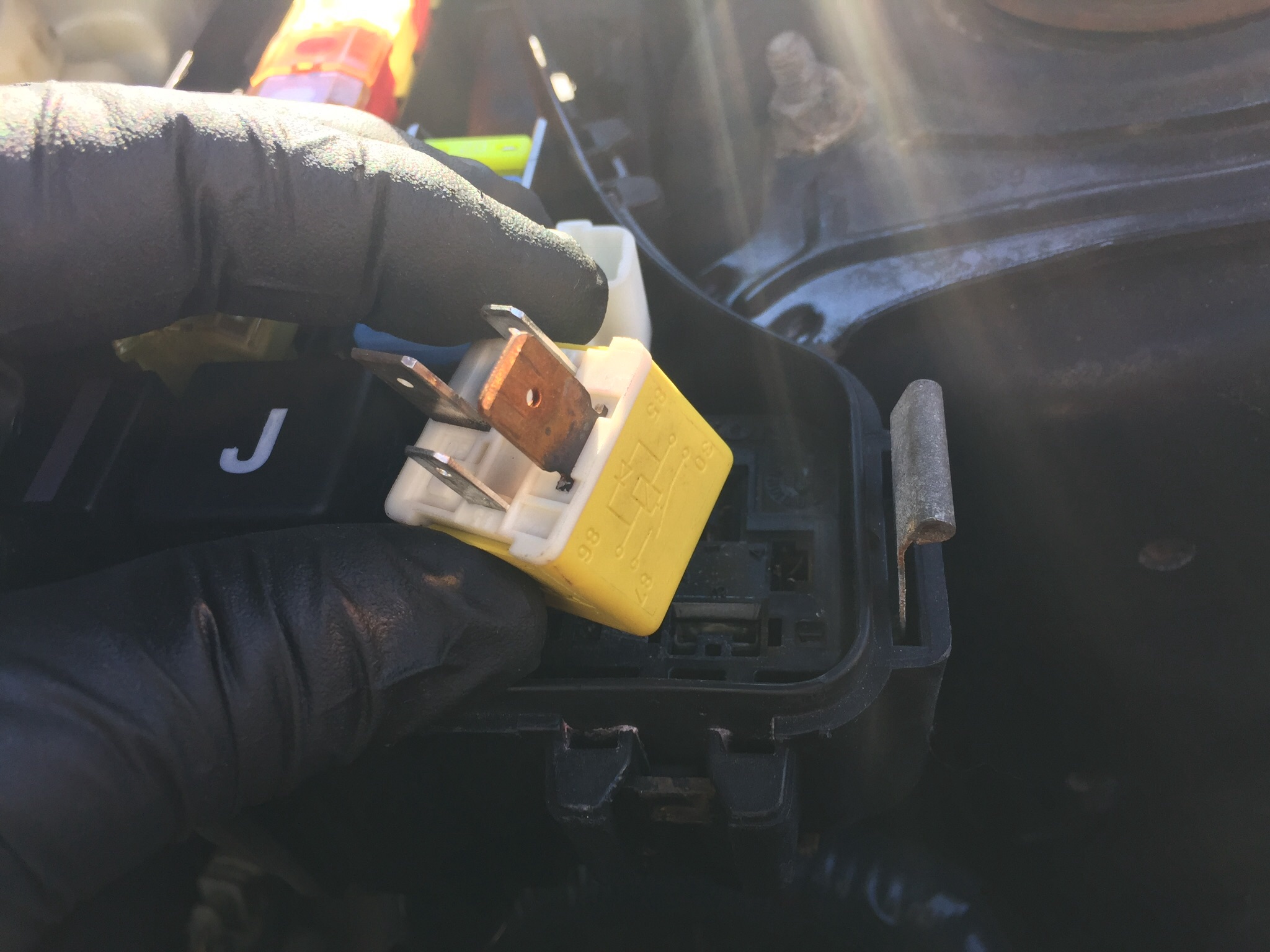

MVS PSA...check those main and starter relays on high mile cars...we had two showing thermal damage, both working fine

Relays with wire wheel on Dremel, Speed 3.
Picture doesn't really show how nice these cleaned up - now shiny bright copper.
